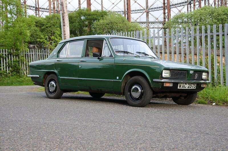

A fairer test is probably on the Toledo, where it was painted on the very rusted chassis leg and left for around 3 months.
I've got a lot more faith in that than in the H80 or Vactan. I think it's as close as you'll get to killing off rust without cutting it out.
Verdict : 9/10
