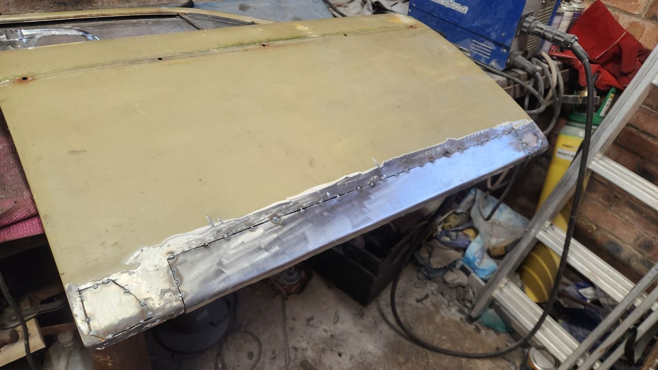

Trying to get my list of Amazon tasks scored off before I move on to anything else, because having a car lying on the drive routinely without doors isn't great.

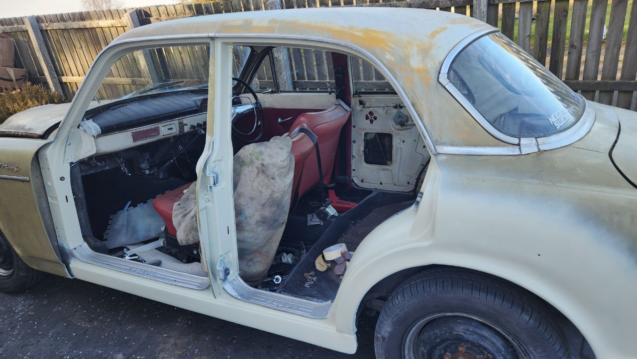

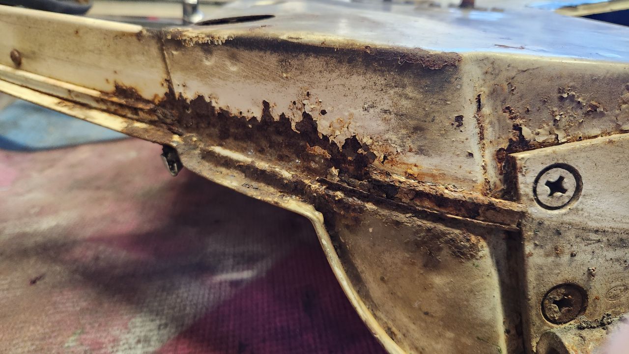

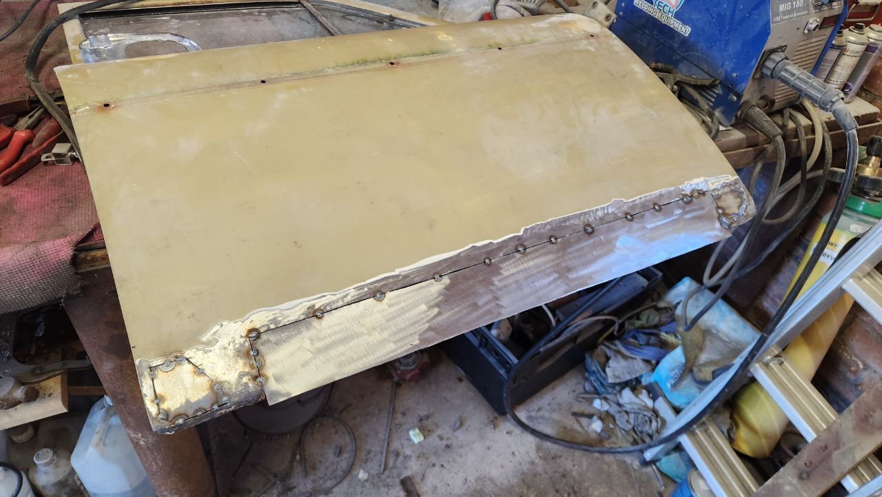

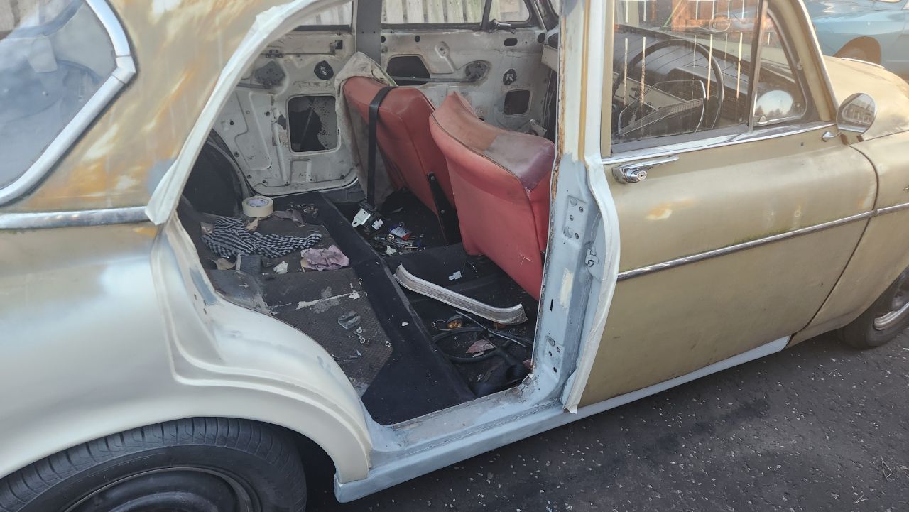

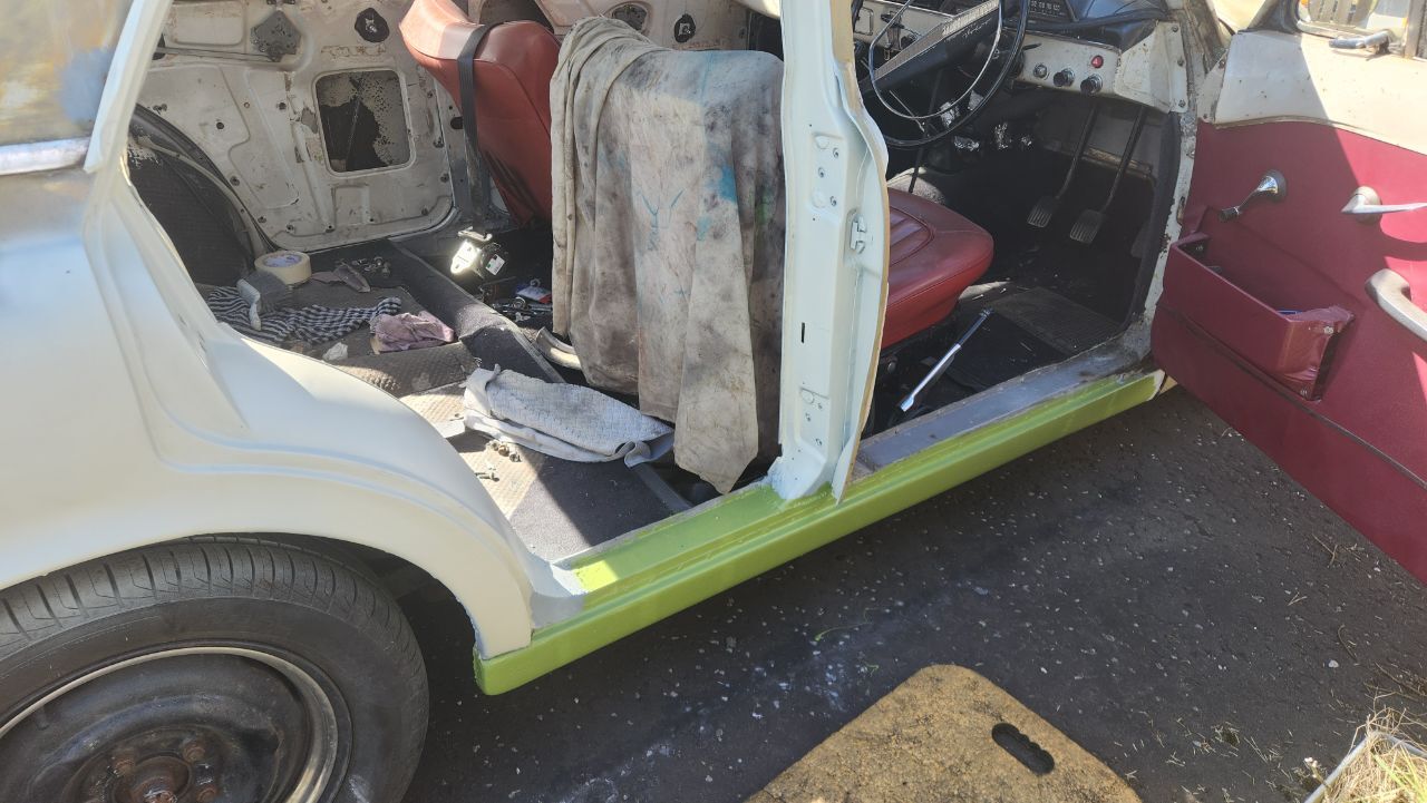

Before refitting the two repaired doors I tidied up the sills and door frames and refitted the kick plates.
Looks almost okay from a distance.
Let's fit the doors and see how that goes.

As kind of expected as soon as exposed to daylight and other parts of car that are the correct shape, the doors look like shit.
Also, it looks like I'll probably be painting the whole car.
At least I can say that for a week or so the car won't be trailing rust flakes everywhere.
I did visit a car show at the weekend and @captain_70s and @blackboilersuit were eager to point out just how rough some show cars often are, including an Amazon in the same colour with pop riveted rear arches and about as many sanding scratches as mine.
So I can only carry on and do this within my capabilities.

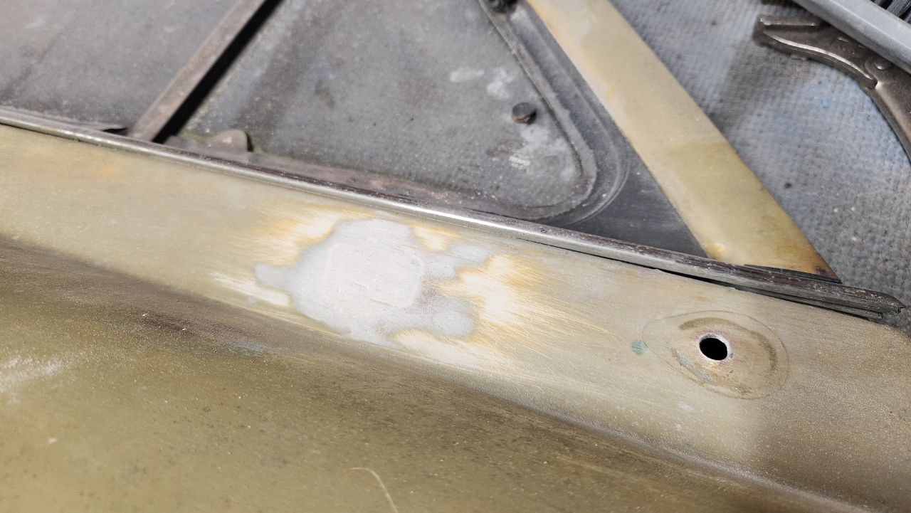

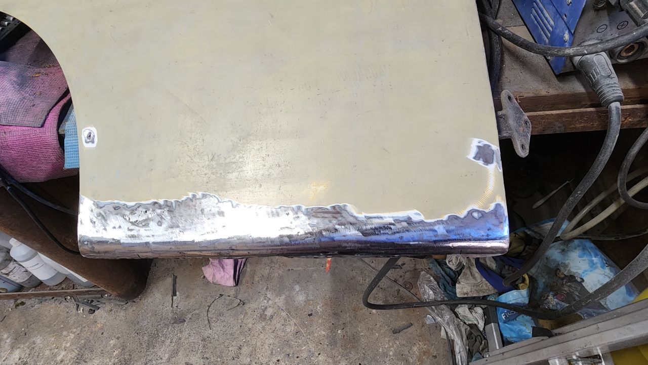

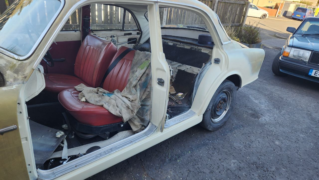

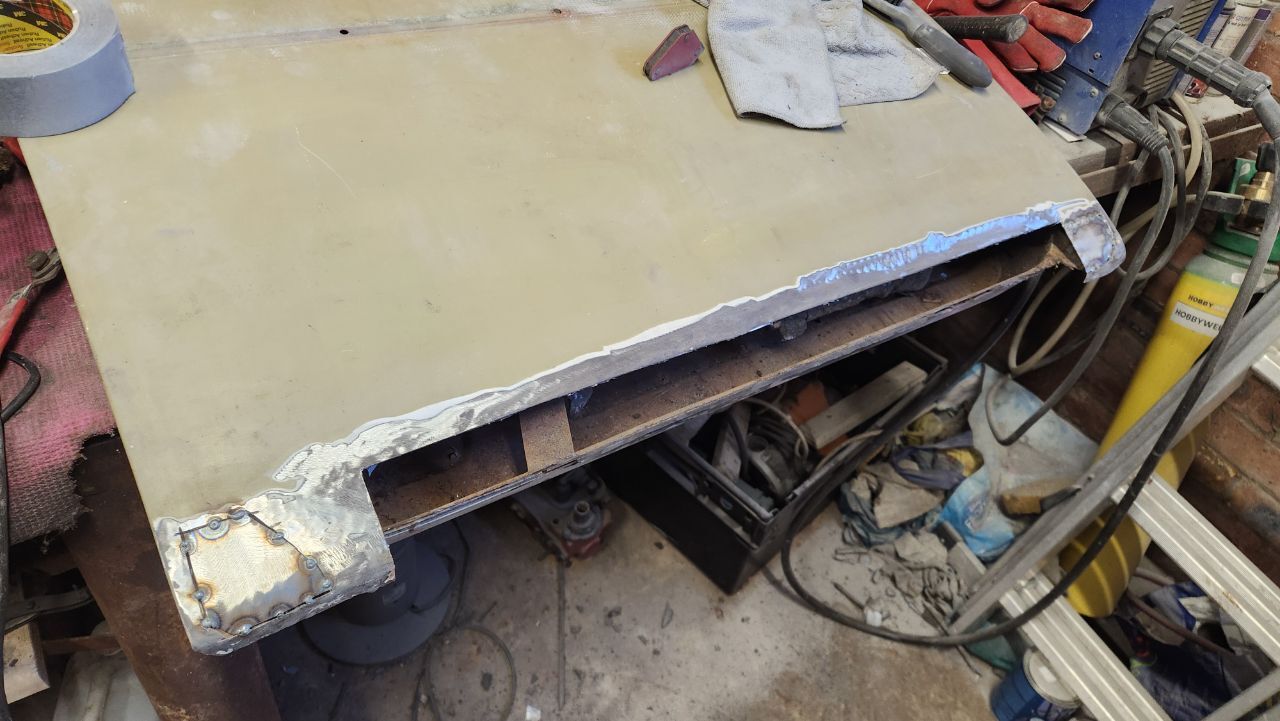

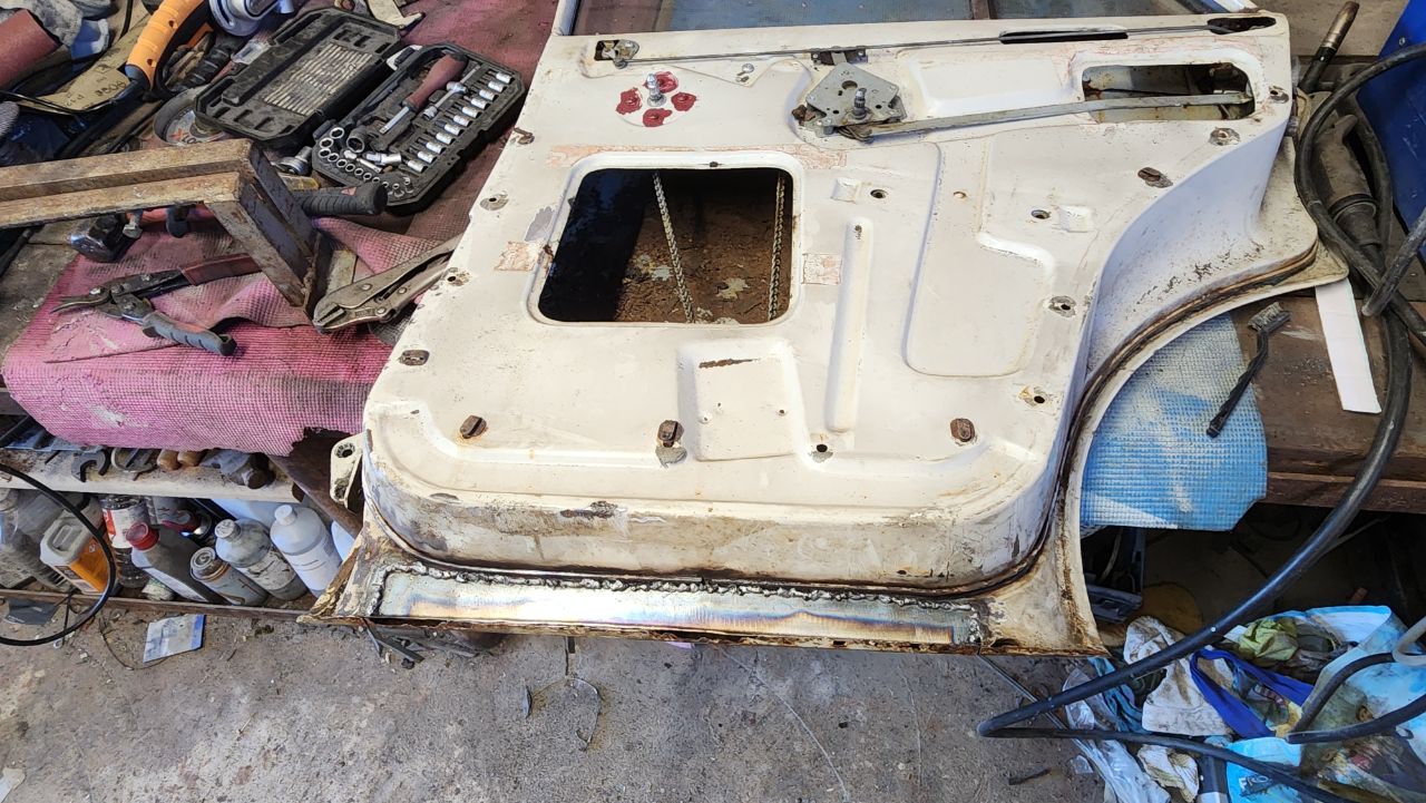

Brief respite was given when I took off door number 3 to have a look.
So it's blown through, but mostly on the inside and with a reasonably easy bit to repair.
With a skim of filler and some paint, it's not bad at all.
Before refitting that the rear door frame and sill was tidied up ready for paint.
Getting there slowly.
The weather at the moment is generally spectacular if cold, so I'm hoping to get the front door done sharpish and refitted before everything returns to the normal dampness.

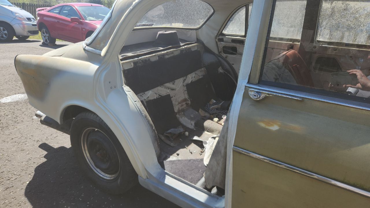

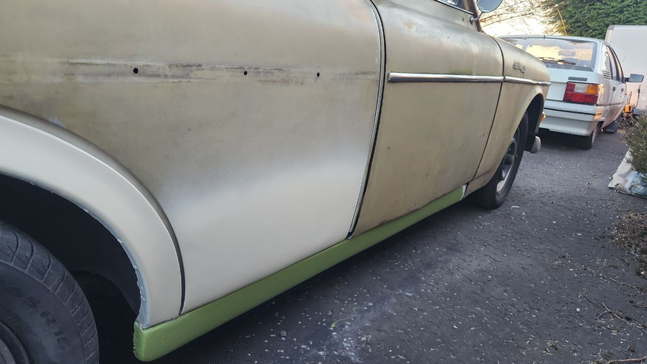

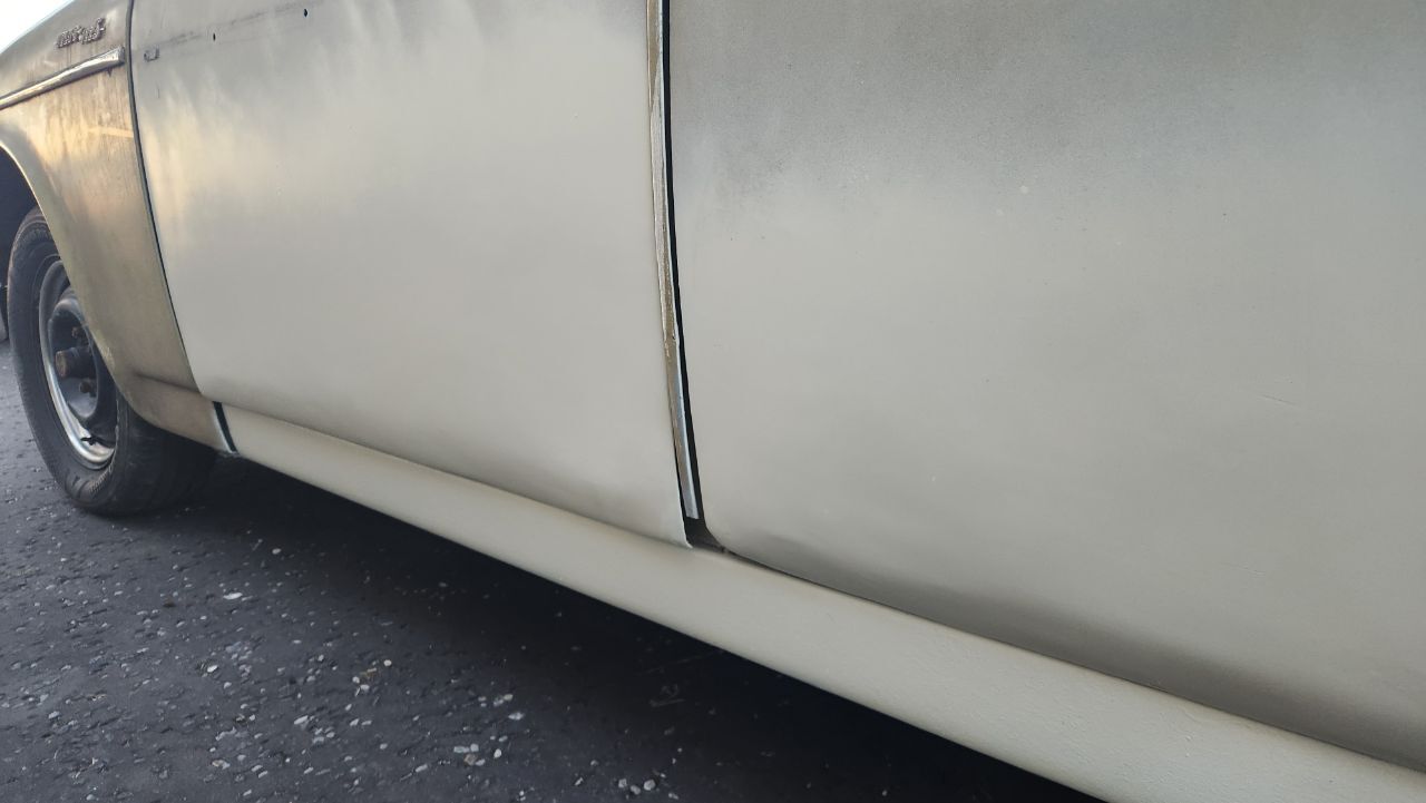

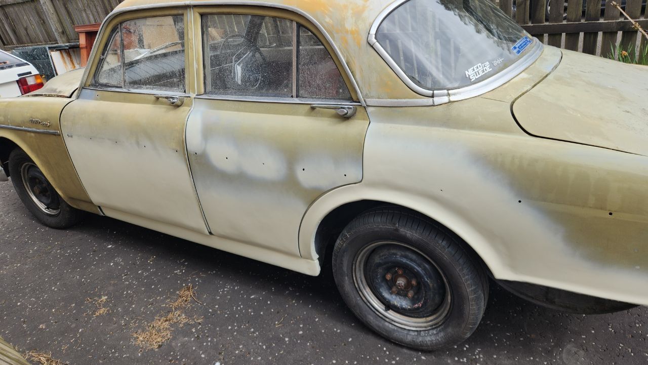

I'm contemplating what to do with this paint.
The original plan was to just touch up the welded bits to keep them waterproof and see how it looked.
I'm not a fan of the contrast between clean white and the ratty look. I'm at a crossroads as to whether I paint the entire car, or try to find some middle ground where I can blend the painted parts in with the ratty parts.
Options I see are:
1. Try to colour match the weird mustardy paint and blend in the repaired sections. Then satin clearcoat the lot, sealing in the patina on the top half while keeping the bottom half tidy.
2. Paint the whole car in something satin / matte to make it fresh but hide the shit bodywork. NATO green or dark grey or something along those lines.
3. Paint the car properly, clearcoat, polish, the lot.
#3 is currently beyond my budget, tools and abilities and it will highlight the fact my bodywork is mince.  One day I might do this if I have an indoor space and can spend the time filling and sanding with an angled light.
Does the world need yet another perfectly presentable Amazon?
#1 and #2 are tempting.
The brightwork isn't brilliant, so a ratty look does kind of suit it.
Open to ideas.

There's an alternative option : coach enamel. Looks a million times better than thick NATO paint, but is much less effort than a proper paint job. Can be brushed on, but is easier to thin it down a bit and spray it on with a cheap gun.
I'm inclined to agree. I find satin/matt finishes really highlight dents/uneven panels because you don't have any reflections to distract the eye...
If brush painting was good enough in 1930 it's good enough now.

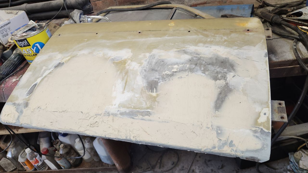

Pleased to report the doors are now 3/4 complete.
Interesting to note that the slight kick out on the driver's door corner is the same as the other side. Originally I thought I'd bent the corners somehow. Maybe this is just how they are?

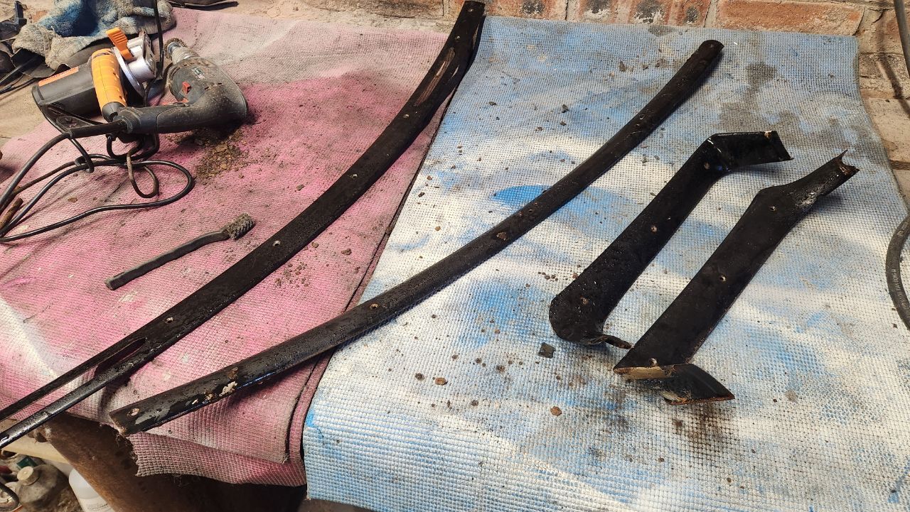

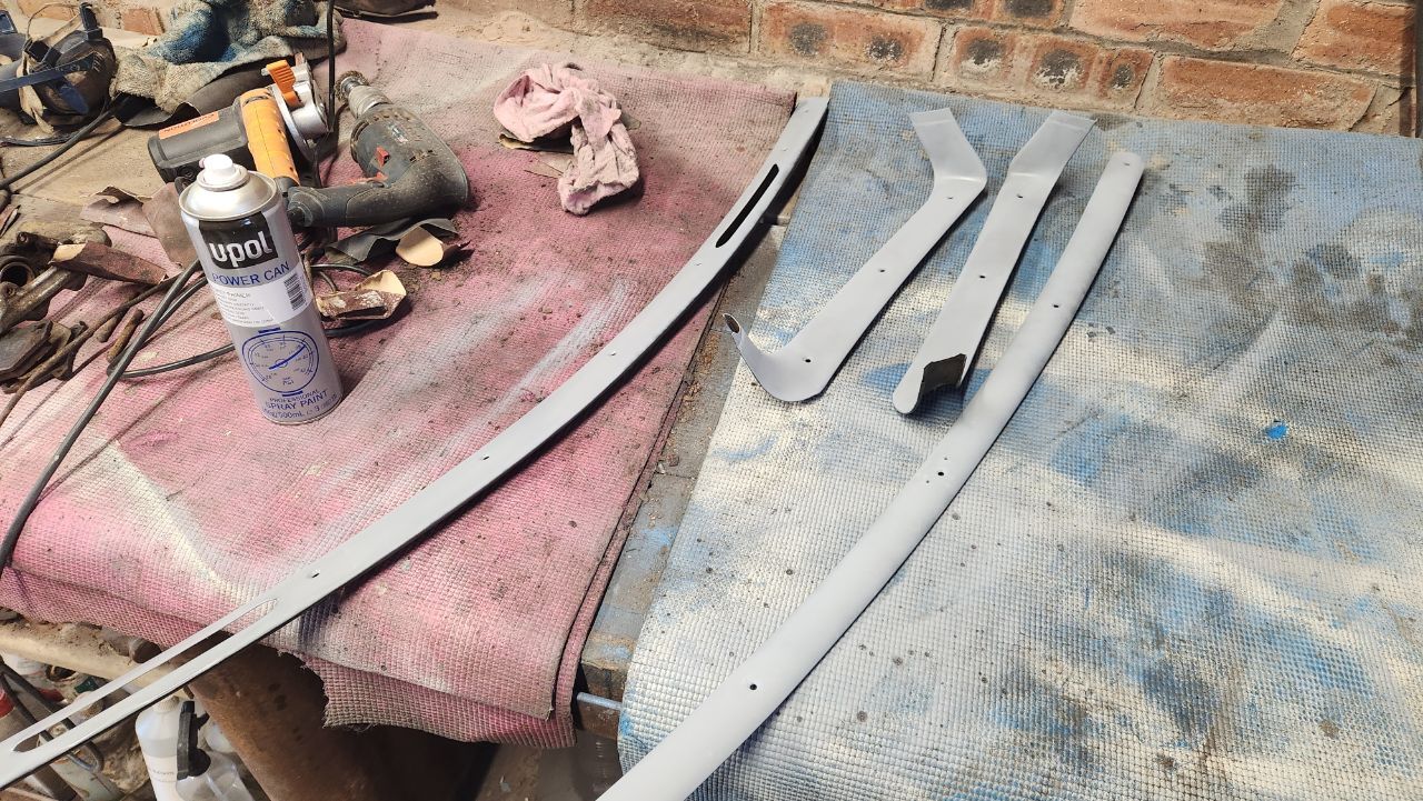

Another small job started: tidying up the interior windscreen trim as it was quite rusty.
Satin black to follow.

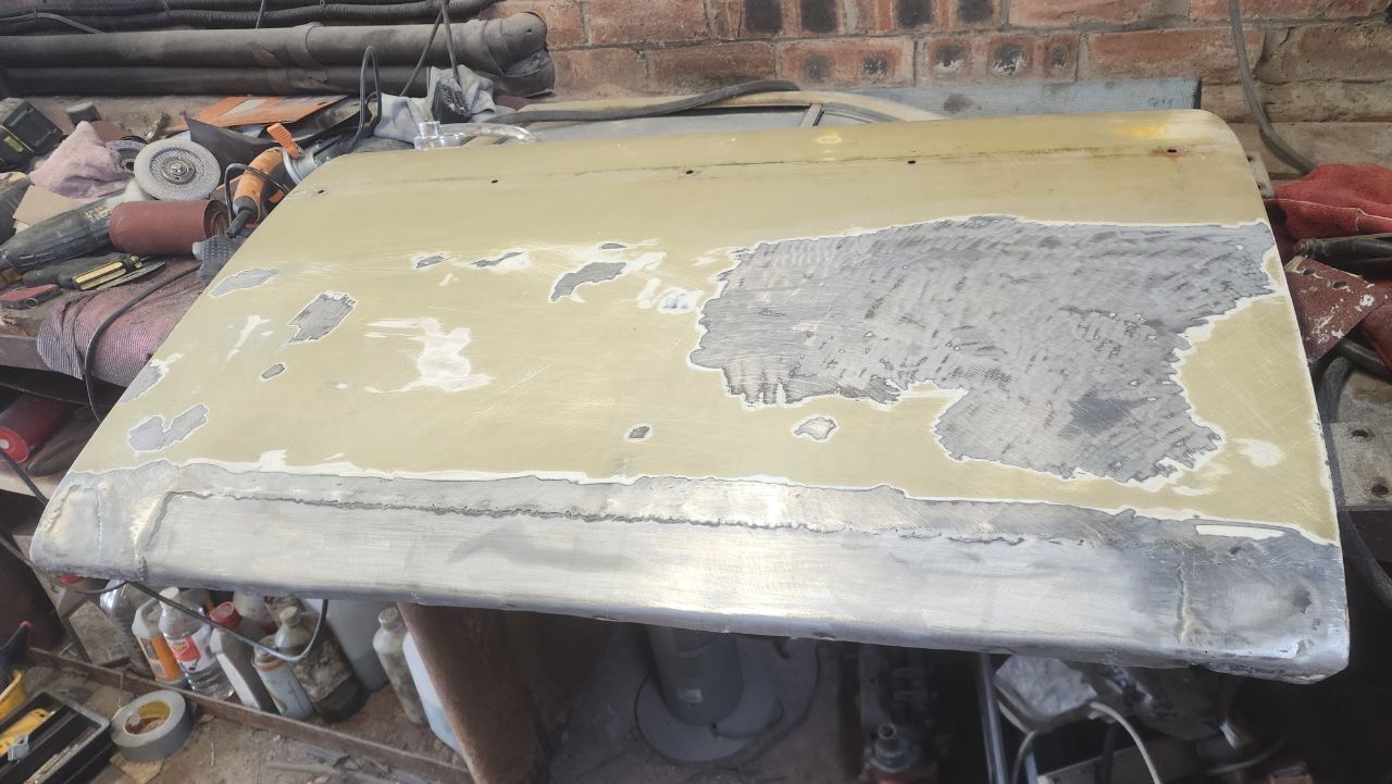

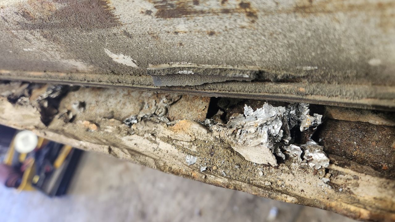

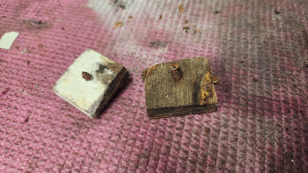

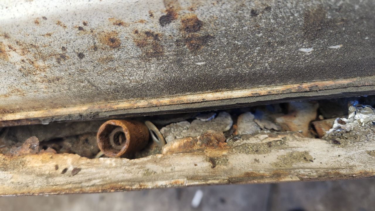

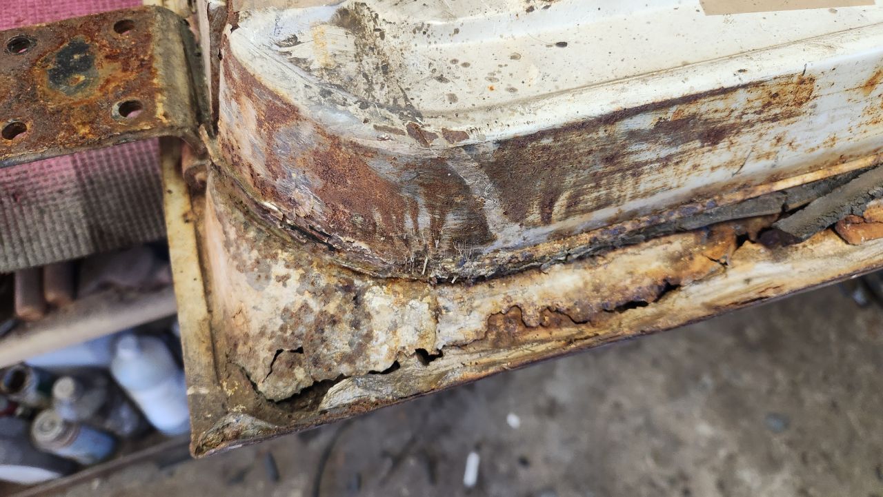

I thought you'd appreciate seeing the final boss of doors.
Most of the filler appears to be held in place with plywood and screws.
At least there's no tinfoil.. ah no wait, here it is.
Finally found my missing 13mm socket from a few years ago.

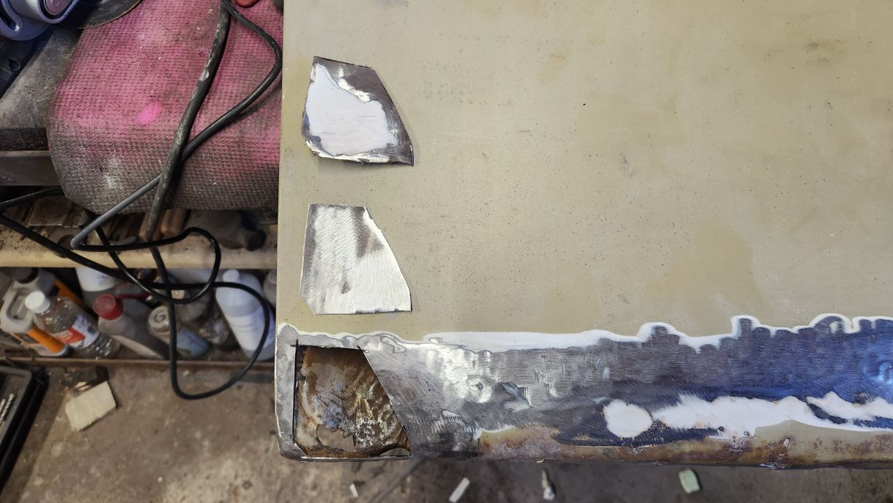

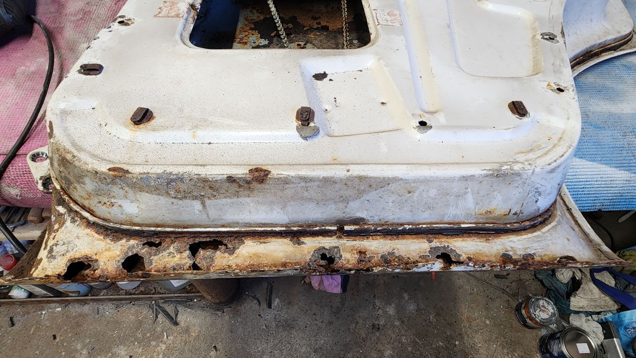

I cut the inner skin out but there was literally nothing to use as a guide to replace it.
So this time I'm starting on the outer.
You know it's bad when you can't even find the metal with a flap disc.

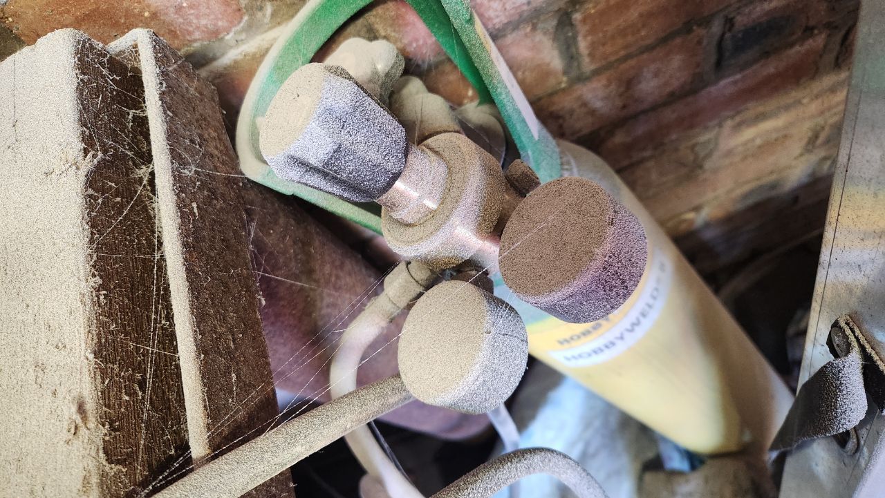

After that the entire garage is in a layer of filler dust.
I cut out and replaced these bits first to maintain some sort of shape in the edges of the skin.
I could then zap off the rest of it and start to let in new metal.
Next I'll turn that over and start rebuilding the inner.
The finish on this one is going to be.. interesting.

On 01/05/2026 at 15:59, Ronkey said:
Flipping heck, that looks familiar! I can see why you left this one until last.
It wasn't intentional, but I'm glad I didn't start with this one or I would have just given up.

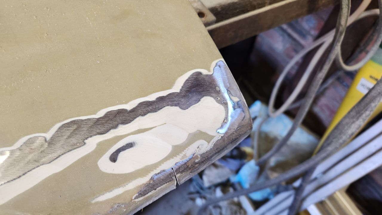

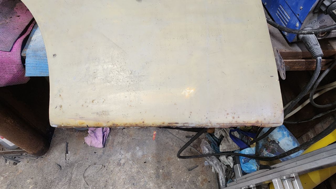

I'm not sure why but this door has warped by far the worst despite me having learned to turn the power down and the gas up, and focusing the heat on the repair panel rather than the door.
Even the tack welds warped it badly.
New inner added.
Folded over and welded.
Trying something different by fitting the panels lower to prevent high spots from the welds.

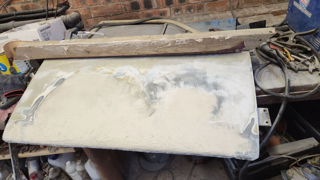

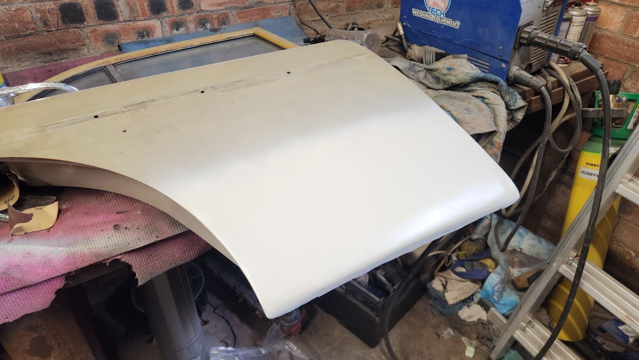

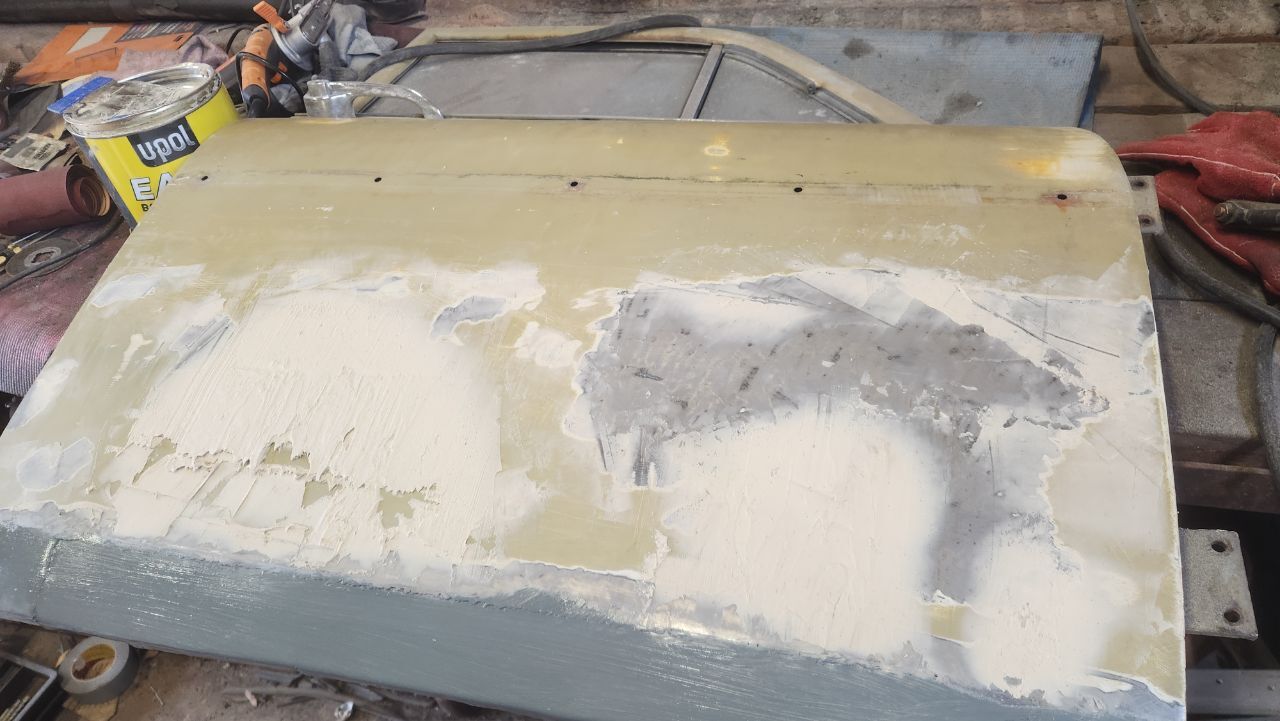

Door is taking crazy amounts of filler. Have been at this all day and I'm on pass #6.
No idea how this will look but if I need a new door, I have one in mind and will just pay the money.
Also filled the wing mirror hole that I made in error a few years ago. (Fitted it and couldn't see the mirror while driving - genius move).
Will update in 2029 when I finish filling and sanding.
Rubbing filler down is the job from hell! A never ending and mind numbingly boring tedious process. Bloody messy too.
