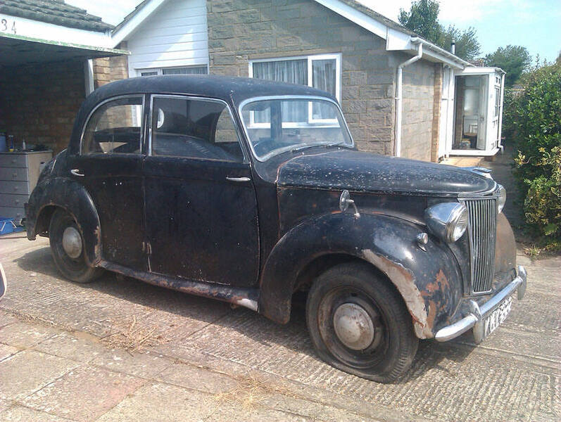

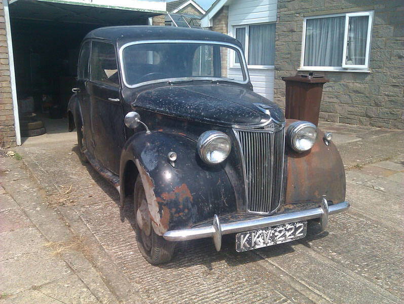

vulgalour Posted August 8, 2020 Author Posted August 8, 2020 It's here~ Good news: the brakes work Bad news: there's no battery. Not surprised about this one. Right, time to give this bad boy a proper wash. Fat_Pirate, andy18s, HarmonicCheeseburger and 44 others 46 1

HMC Posted August 8, 2020 Posted August 8, 2020 Looking forward to progress. Will you maintain the “oily rag” aesthetic? Like with old buildings or antiques it’s an interesting Aesthetic challenge to decide what to do, and what not. Lovely. DSdriver and vulgalour 2

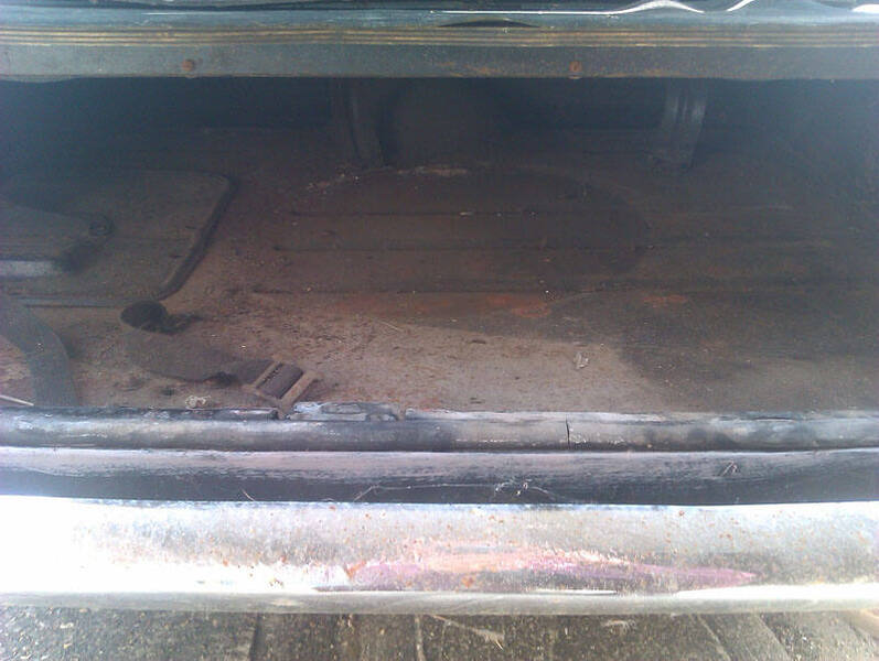

vulgalour Posted August 8, 2020 Author Posted August 8, 2020 I've just finished washing the car and am now enjoying a sit down indoors and having a bit of a rehydrate. In the meantime, here are some more pictures and info on what's arrived. In the boot are two spare tyres and a bare spare steel. The two boot floors, both the wooden one and the steel one, are in remarkably good shape. The split cover for the fuel filler neck is present but not screwed down, I suspect the screws I found in the glovebox are for that. The rear light lenses are different on each side of the car, but there's a matching one for the light on the right in the glovebox, I might fit it, I might not. To answer @wuvvum's query about the boot lid, it does open more than the Conquest's 15 degrees, but because of the shape it doesn't feel like it. Not the most practical boot design ever. The hinge on the left can be pulled back to lock it, just be careful when you push it to unlock it because the lid will come down rather rapidly! In the engine room up front, it seems to be intact. The fuel line running to the carburettor is currently disconnected with a bit of copper pipe taking it's place that served as the feed line for the remote fuel tank we ran on viewing day. We will correct this, it's not difficult. To the right of the image you can see the sediment bowl and the Irn Bru looking fuel in it, the sediment bowl is plastic, surprisingly, I'd expected it to be glass. There is coolant of some sort in it, though it does smell like something halfway between household emulsion and thinners, so goodness knows what's actually in there. Let's have an overview of the outside then. It actually rolled off the trailer fine, slowed a bit by the flat front tyre. The brakes did work and the car is holding quite happily on the handbrake, which was a pleasant surprise. There's a lot of dents and scrapes and paint damage all over and that's okay. What rust there is on the car is very minor, not at all what I'm used to. The worst of the paint defects is on the aluminium roof and boot lid because a lot of the paint is just flaking off. Obviously it's not a problem because it's aluminium so we're just going to leave that be. You'll notice it's wearing hubcaps now too, these were in the car and are a nice snug fit, they've been painted at some point, though not badly, you can still read the Lanchester script on them. The chrome on the bumpers is shot and there's a good amount of pitting on the handles and boot hinges, again not an issue for what this car is. Let's move inside. There's what looks to be part of the exhaust sat on the back seat. The battery lives under the passenger side of the back seat, it's gone because of course it is, so I'll have to get a new one of those once I figure out what type it needs, I'm not sure if this car is on 6 or 12 volt. The back seat is actually in much better condition than I remembered and probably just needs a clean and feed and nothing else. The rear door cards likewise are in better condition than I remembered. Even the headlining and draught excluder strips are in good, if dirty, condition. Up front, the worst of the damage is to the passenger seat where a cat has been using it to sharpen claws. Both seat bases are a little flat feeling, as if the springs or stuffing are tired, but are otherwise incredibly comfortable. Both front door cards are not as bad as I feared when I first viewed them, now I can see that it's not so much water damage as rotted out stitching that's the problem, with the driver's door being much worse. Careful unpicking should allow me to completely save these with the original materials. Am I still happy? Absolutely! The smell inside this car is that perfect old car smell, especially with it being so warm outside today. It's remarkably cosy inside, you half expect there to be a little pot-bellied stove under the dashboard. It's the most grown-up car I've ever owned. Glass and interior next, mostly just to get the dust out of everything. What's left of the paint does take a shine and I've a plan to spruce that up without compromising how the car actually looks. Thanks to having the garage, keeping this car looking like it does now without it deteriorating should be eminently possible. It's almost disappointing there's not more junk in the car really, chances of hidden treasure are quite slim. egg, wuvvum, danthecapriman and 37 others 40

lesapandre Posted August 8, 2020 Posted August 8, 2020 Yes wiping the car over with WD40 or something may be the way forward to keep the weathered look. Stripped and repainted the car wd loose so much character...likewise repairing the interior. Ford Consul announced in 1950 at about £750 was a world away...and a Zodiac was about £850. The Lanchester must have appealed to the 'traditionalist' who liked the 'Pre-War looks - but it was expensive and to an extent you can see where the money went in terms of quality of materials and workmanship. But so impractical in parts - why make the boot so small for example - maybe people sent on their luggage by train. Super car though. Congrats on getting it. Wonder where its been all these years. I really like the scruffy look compared to something 'restored'. vulgalour and LightBulbFun 2

SiC Posted August 8, 2020 Posted August 8, 2020 Those slightly pointing down headlamps make it look a bit sad, depressed, Eeyore looking. A ? kind of look. It's the look of something that has survived all these years but hasn't got anything to look forward to anymore. Please make Mr/Mrs Lanchester happy again. privatewire, Kringle, Christine and 10 others 9 3 1
Christine Posted August 8, 2020 Posted August 8, 2020 Its called Eeyore now , the die is cast ! Kringle, GrumpiusMaximus, phil_lihp and 1 other 3 1

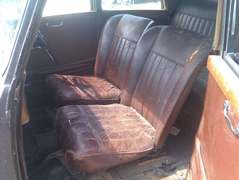

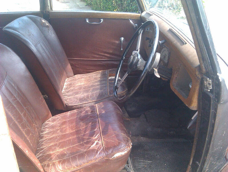

beko1987 Posted August 8, 2020 Posted August 8, 2020 Thats amazing! I'd clean and restore the interior as much as possible, and the glass, then as said, wash the outside in oil. Best of both worlds then, a really nice place to sit, and looking fab on the outside. Would a clean and feed of the front seats then some period correct* or knitted seat covers be the way forward? Or just a better set of leather from another seat I suppose vulgalour 1

Christine Posted August 8, 2020 Posted August 8, 2020 Don't get the bakelite bits wet , or the steering wheel rim..it disolves !
