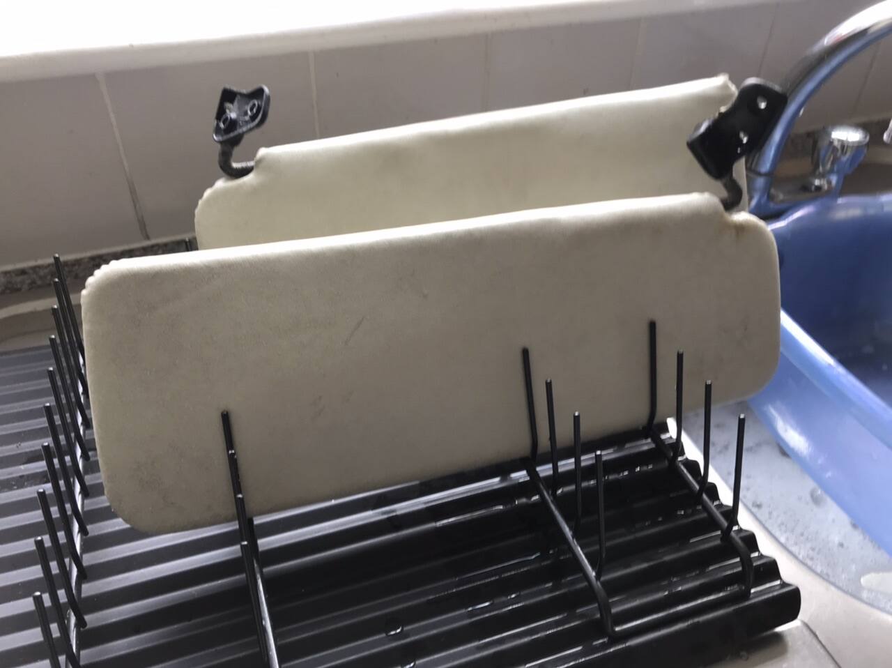

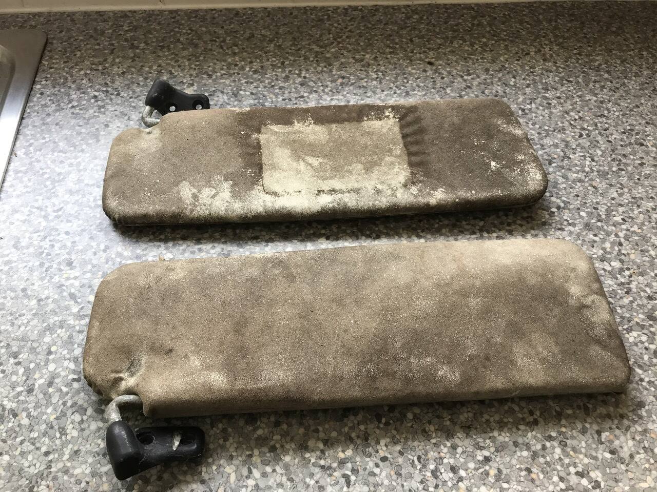

DavidB Posted July 5, 2020 Author Posted July 5, 2020 Andrew that is bad news! It is the early dashboard with side vents. Its also filthy as an earth worm, it needs a good jet washing inside. I can’t even look at things like this: Dick Cheeseburger, somewhatfoolish, rainagain and 16 others 19
danthecapriman Posted July 5, 2020 Posted July 5, 2020 This is brilliant! I don’t think I’ve ever seen one of these older than a C reg, the hard top van variant must be really rare by now. I still can’t believe they only have a 1.0 engine either! It sounds tiny but by the sounds of it they can still hold their own off road. Nice job on the sun visors too. How much to drink a shot of that rancid water!?

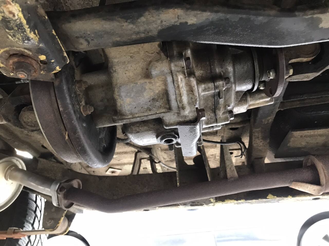

DavidB Posted July 5, 2020 Author Posted July 5, 2020 Yes it was, I wish it wasn’t. Here’s the underside/transfer case for @Andyrew Coprolalia and Jim Bell 2

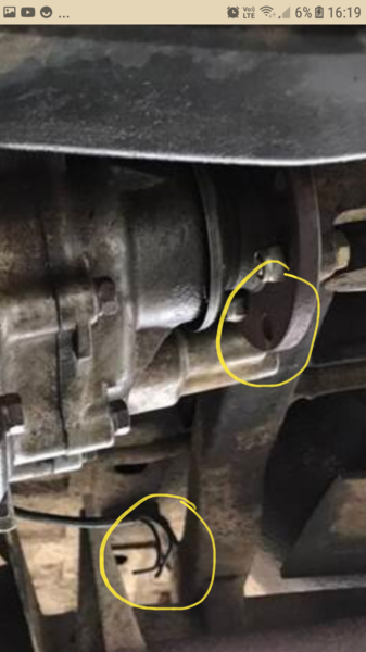

Andyrew Posted July 5, 2020 Posted July 5, 2020 That T box has been changed for a later box. The drive flange has been re drilled to suit the skinny props on yours. I've circled what looks like cut wires. Alot of Early boxes dont have a switch on them for the 4wd light on the dash. Later cars did. Its on the sticking our part where the selector lever goes into the case behind the flange in that picture. The 410 had a different ratio transfer,413 and samurai are the same ratio but the samurai was handbrake on the rear axle. To check what you have Sj410 box in low range 2 and a half turns input flange equals 1 full turn of the output. Sj413 box in low range is 2 and a quarter turns to 1 on the output High range differs aswell. 410 boxes are expensive as they used to be used to drop the ratio down to account foe larger tyre Or were used to build rocklobster /crawler transfer boxes which give a 4.1 ratio to make low actually low. DavidB 1
