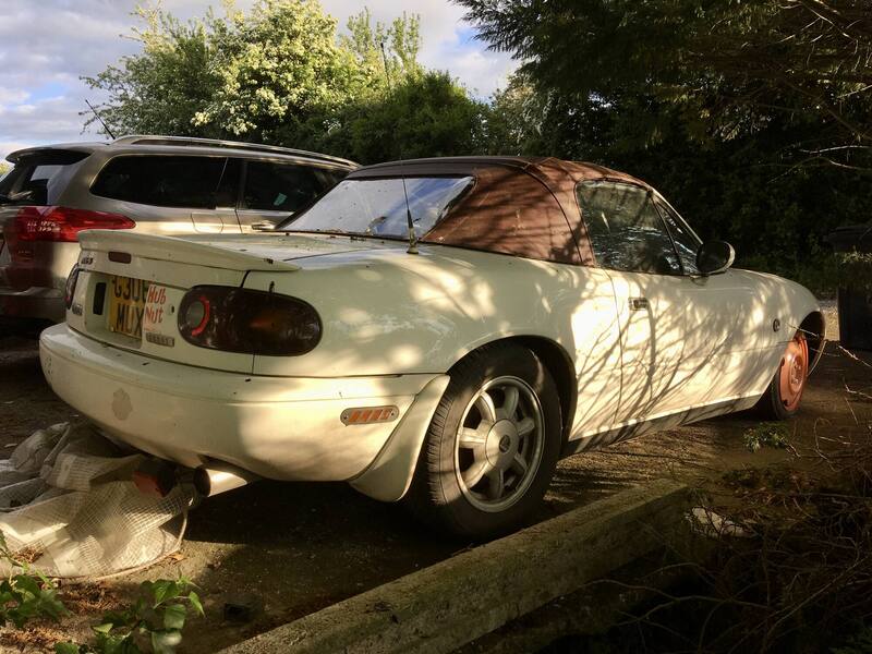

gm's unhealthy obsession with mx5s - mot time for Exo

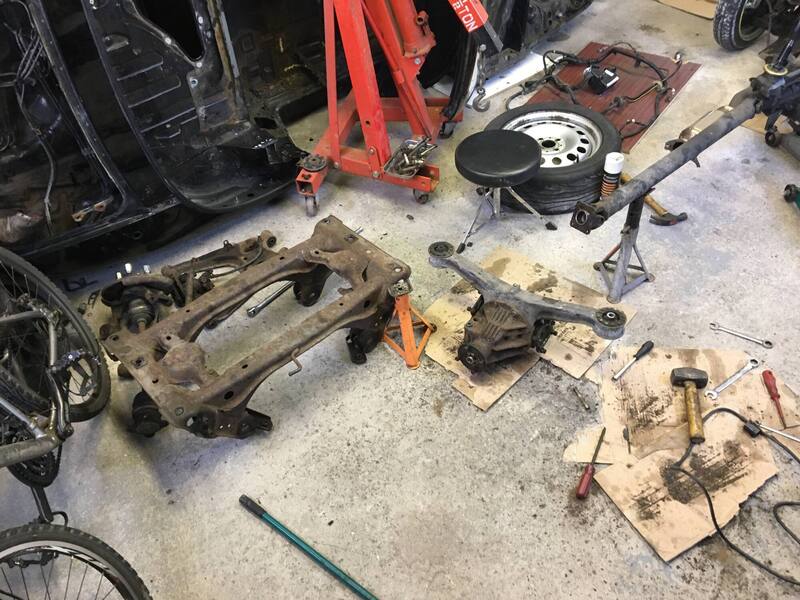

just a couple of hours pottering this afternoon, I chopped the vin plate off the shell and removed all of the brake and fuel pipes. I won't be using the angry grinder to chop the shell as it consumed most of a new disc just to cut the vin :( time to invest in a reciprocating saw, me thinks.
power steering pump off, alternator off, remains of loom off
suspension bolts all dowsed with plus-gas in preparation for strip down tomorrow. one broken rear spring will need replaced if I re-use the current (mk2) suspension. I noticed upgraded anti-roll bars front and rear with fancy droplinks, someone cared for this car once upon a time :)

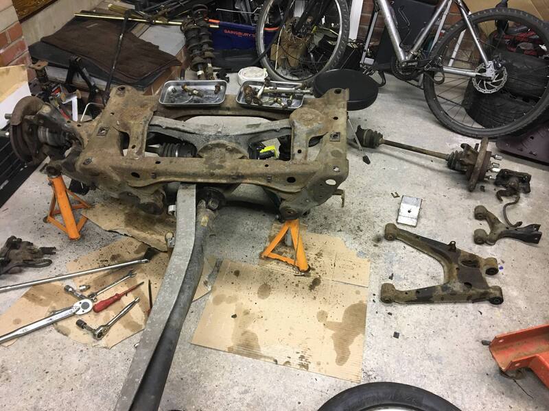

tonights minor progress : I started to break down the rear subframe, but hit upon a very stuck 'long bolt' on the lower o/s wishbone - it's a bit too late to be belting things with mallets and breaking out the windy gun so it can wait for tomorrow.

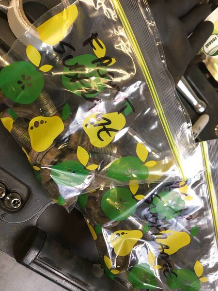

I decided I had better get organised while I tear the poor thing apart
snacky bags !
this lot is from the shell but may come in handy later on at some stage
not much more to report, cheers all :)

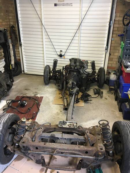

the car is starting to fight back - the wishbone longbolt is properly seized in the bush so will need cutting free and a new wishbone sourcing - not the end of the world but annoying. the diff was a stubborn bugger to shift too, a lot of persuasion needed to get that off the frame. time for a break before I start to lose enthusiasm :)

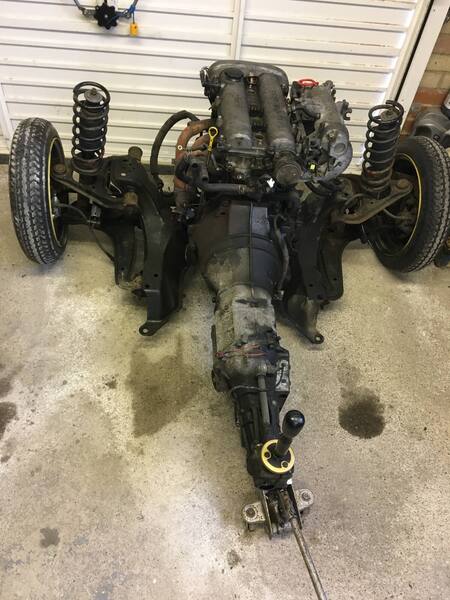

i had a bit of a tidy up as I was getting pissed off tripping over stuff everywhere - look at all that space now :)
not much left now
tomorrows job is to wheel that lot outside and give it a good clean up - apparently mr muscle oven cleaner is good for shifting baked on oil and gunk - I'll give it a go and report back
