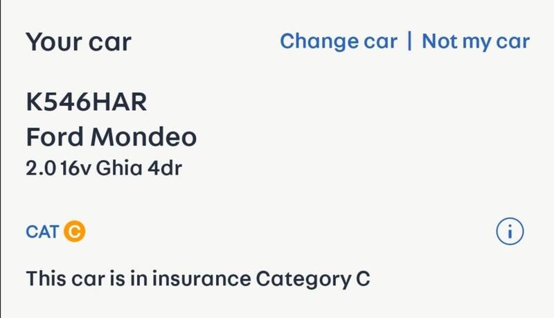

trigger Posted April 26, 2020 Share Posted April 26, 2020 Excellent thread, I really like those early Mondeos, especially in Ghia spec, that was still a time when owning a Ghia did feel more special. Auto trader confirms it as a Cat C, it's probably from a time when the car was worthless, a door dent or bumper scuff would have been enough. Slowsilver and Isaac Hunt 1 1 Link to comment Share on other sites More sharing options...

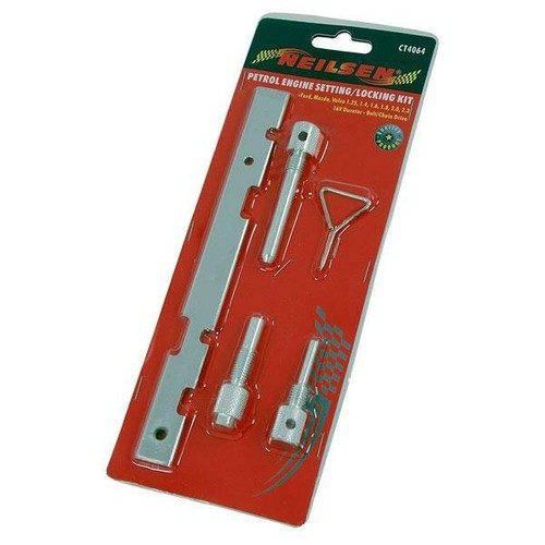

egg Posted April 28, 2020 Share Posted April 28, 2020 I did have a camshaft locking tool. But I never used it, this one I'll see if I've still got it...probably in the loft or something. Or I sold it on ebay or on here... Slowsilver 1 Link to comment Share on other sites More sharing options...

sierraman Posted April 28, 2020 Share Posted April 28, 2020 Easy way to TDC it on the end of the cams, they’re offset so the bar should just about slide in against the cylinder head, back it off a hares breadth and put the pin in the 10mm block plug, move the crank against the pin and the cam slots should line up. Probably teaching you to suck eggs here but don’t leave the bar in if you are winding the crank bolt off with a breaker. Slowsilver 1 Link to comment Share on other sites More sharing options...
egg Posted April 28, 2020 Share Posted April 28, 2020 @Slowsilver - I have just found the locking tool in the roof. Just remind me of your address by PM and it will be on its way to you if required. richardmorris, Slowsilver and mercedade 2 1 Link to comment Share on other sites More sharing options...
