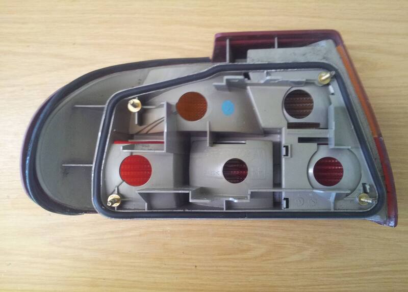

OK guys, let's try these seals. Rear lights removed to find this:
Lots of manky dried-out sealant stuck to the back panel.
Sealing groove in rear light cluster (as removed) completely devoid of sealant. The sealant had obviously stuck successfully to the metal but not to the plastic. I was expecting a proper sealing gasket and thought this was an aftermarket bodge but the HBOL mentions replacing the sealant when refitting the rear lights, so maybe this was the original factory job on the early cars. It certainly looks as though it could be old enough.
I thought of replacing it with silicone sealant but that is messy, smelly and means that if they need removing again (which knowing my luck they will) they would need to be prised off, the old sealant scraped off and new sealant applied, and I didn't fancy that. So, looking at the nice clean 5mm wide by 5mm deep groove in the plastic moulding, I decided to try a proper rubber seal. I ordered two metres of 6mm diameter O-ring cord (about £3 from ebay) hoping it would squash down to 5mm wide and then stick up enough to seal against the back panel.
The finished job. Much easier and neater than sealant but will it stop the water leaks? Pouring water over the boot doesn't appear to replicate the leak so I need to wait until it rains again which, according to the weather forecast for this area, won't be for at least a week. Let's just pretend it has worked until proved otherwise.
Nice solution, I will watch the results with interest. I do believe that is how they came out the factory in Belgium.
Agree, very neat solution.

Yesterday it finally rained again so as soon as it stopped I leapt into the boot (figuratively speaking) to check if my rear light sealing trick had worked. It hadn't. In fact I think the leak was worse than before, although there had been a pretty heavy hailstorm this time.
Quickly removed the lights again while they were still wet and could see where the water had run. There is a big unsealed gap at the top of the light unit where it curves round onto the rear wing. Water runs in here then sits in some of the recesses in the lamp moulding, where it is actually on the seal. But the seal is obviously still not watertight. In hindsight I think the nitrile rubber I bought for this is too hard and doesn't squash enough to seal against the back panel. So I have now ordered some softer foam rubber sealing cord. If this doesn't work then it's silicone sealant time.

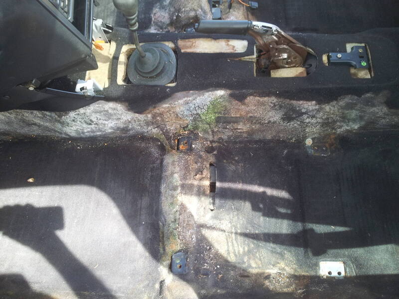

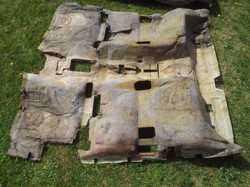

While I am waiting for these to arrive I decided that the carpet was too disgusting to do anything with in the car, so set about removing it. It is all in one piece and involves taking out all the seats. This was a swine of a job, mainly because the HBOL is completely wrong in every respect so I had to make it up as I went along. When I removed the rear seat squab it is just a big lump of foam underneath and both ends of it were soaking wet. I suspect that this is a result of the water ingress from the rear lights running along past the rear wheel arches and through the corners of the rear bulkhead. With the seats out the true horror was revealed:
Carpet and underlay/sound deading were pretty damp and mouldy. They eventually succumbed to being prised out and are now drying out in the sunshine:
The underlay is quite rotten and tried to fall apart but I managed to keep it mostly together.
There is another sound-deadening panel on the front bulkhead but this is underneath various fittings, including the pedal box, so I drew the line at trying to remove it, although this is also soaking wet, so I have pulled it as far away as possible from the bulkhead and propped it up so that the air can circulate underneath it. The car is now sitting with all the doors and the boot open in an attempt to dry it out. The floor is remarkable rust free considering it has had damp underlay on it for what looks like years:
That's enough for today. Lots of scrubbing / cleaning / vacuuming ahead.
It's carpet washing day obviously!  Mine weren't quite that vile admittedly but a close second place.  Great to see this car being brought back to life,
Satisfying work, at least to read about! What’s the plan re the carpet mould/ stain?
The boot carpet was in a similar state and I was expecting to have to do something major with it but, surprisingly enough, I left it to dry thoroughly then gave it a good going over with a dry stiff nylon-bristled scrubbing brush. All the dried mould came off like talcum powder and a quick once over with a vacuum cleaner left it looking quite presentable. I am hoping the main carpet responds just as well to the same treatment.
