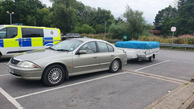

The new tow ball didn't fit and the electrics were chaos, but I got there in the end. Departure day is upon us.

On 7/27/2022 at 3:54 PM, dollywobbler said:
instead of one that does 27...
fairmount?
wish my mondeo did that high...
I reckon the Fairmont is doing 20mpg towing...
Also needs a suspension refresh I suspect.
Is the balance of the trailer correct?
You probably know this already... But..
Downward load on the ball should be 10-15% of trailer weight, the trailer nose weight limit or whatever the car limit is, use the lower of the 3 numbers - 75kg would be about right for that trailer, I believe.
Shouldn't be pushing down enough to flatten a Fairmont.
If in doubt, some bathroom scales tared with a block of wood on top at roughly tow ball height and just lower the trailer nose onto it. Takes 5 minutes and can make towing a lot more relaxing.
I don't see how we could really package things differently. With the camper folded, there isn't really any storage. Removing the leisure battery might be a way to reduce noseweight. Haven't been able to measure it yet.
But the boot is pretty well loaded, which I suspect is more the issue. If it was a proper caravan, we could move weight from tow vehicle to camper, but like I say, that just isn't really possible with a folding camper. (What little storage it has is only accessible if the camper is raised).
I forgot you had that massive leisure battery - that would definitely be better near the centre or rear of the camper, balanced with lighter stuff (awning??) in the front compartment. You have storage under the seats at the back, that's a better place for the battery - but ideally weight should be even(ish) side to side, as I'm certain that you know.
I do think you need to check weights and rearrange things to suit, judging by what's happening at the back of both cars you've used. At least the electrical connectors for the battery are simple to move. Do you even need the battery?
Unless Betty really is that knackered back there - but I've never seen anything on your videos that make me suspect anything.
Here's how we are looking today after a bit of a rejig. Betty is sagging even when empty though. Time for new rear springs and shocks.
Ratdat has sorted out the trailer brakes, so they actually work, and replaced a duff wheel bearing. Top chap. Tows much more sweetly now.
Will be interesting to see how the Berlingo looks hooked up with its new back end. Can't wait to get back to 40mpg rather than 20...
  • Like 9
