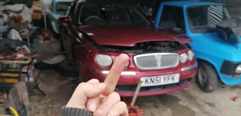

dollywobbler Posted January 10, 2021 Author Posted January 10, 2021 Current mood. Serpentine belts are an utter arse. Sadly I got the belt off before undoing the pulley bolts on the PAS pump. You need to remove the pulley to get at the bolts to remove the pump. Wonderful! Now can't get the belt back on due to spanner incompatibility. Sod it. I'll do something else today. Split_Pin, Marina door handles, Retr0naut and 8 others 6 1 1 3

dollywobbler Posted January 12, 2021 Author Posted January 12, 2021 Got the alternator out. What a sod of a job. The engine sits so close to the chassis rail that you can't get bolts out! Decided to finish on a success, so I'll try and fit the replacement another day. BeEP, LightBulbFun, Low Horatio gearbox and 4 others 7

dollywobbler Posted January 17, 2021 Author Posted January 17, 2021 On 1/15/2021 at 5:39 PM, Split_Pin said: Good shout on finding being the right spanner, lots of Diesel 75 owners will be a lot happier knowing that one actually exists! The one I bought really isn't long enough, so you pull on it has hard as you absolutely can, all the while aware that the F8cker might just leap off and smack you in the eyeball while you punch the subframe. In conclusion, don't do what I did as I did this job the wrong way. Not that you can avoid disturbing the serpentine belt. Or just call a garage. A decent mechanic who has done this job before can probably get it done in just over an hour. Rather than three days... Split_Pin 1
