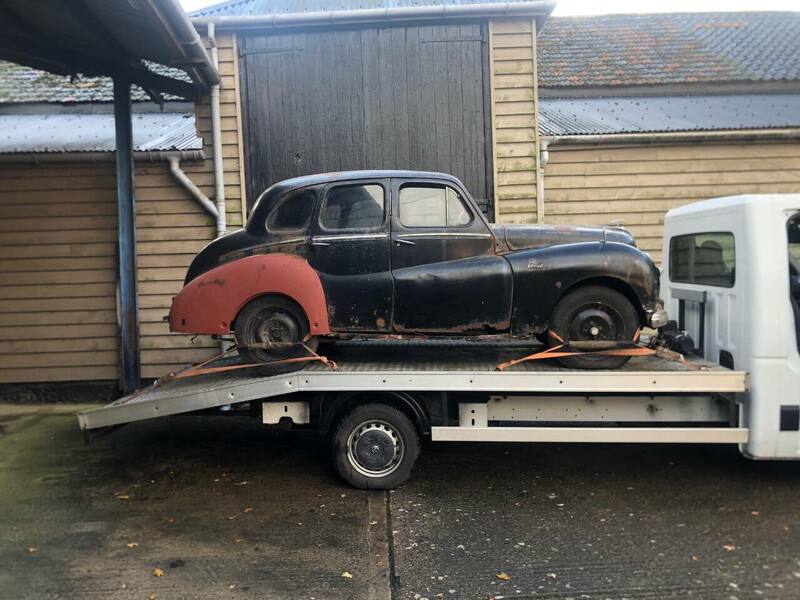

There is a pair of these languishing in a barn not far from where I live, which I spotted while covering a dust round (staff shortages).
I can pop over there and leave a note but TBH I doubt you'd get any kind of response.
Phwoar. Hampshire shite bran fined motherlode.
What a find! They have the appearance of Ozzie or NZ imports possibly. Wonder what the story is there?

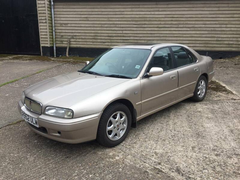

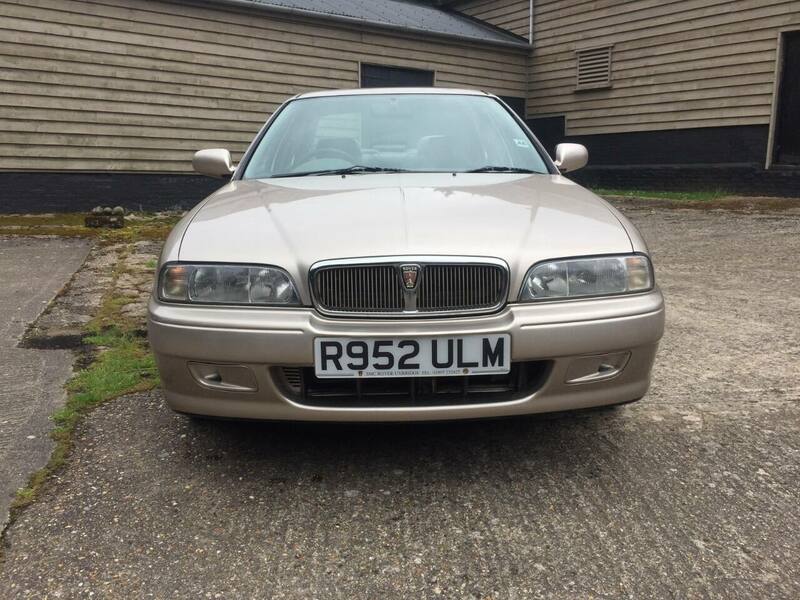

I’ve been mega busy lately so progress on the fleet has slowed somewhat, but here’s an update on the Rover.

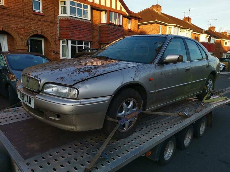

Since purchasing it in November, it’s been pretty much* trouble free. I immediately pressed it into service and have managed to clock up 10,000 miles with relative ease. It had 98k when I got it and it’s now on 108k.
* Well it’s never FTPd, the issues have really just been due to age and neglect.
First thing I noticed was a severe wheel wobble when braking hard. It was pretty horrible and although the car had recent rear calipers, pads and discs, the front pads had also been changed but the discs had been left. That’s because it’s a big job to change them on these. I did look into doing it at the time and thought it looked a total ballache, the discs on these are held on with four bolts at the rear and they are completely inaccessible without dismantling most of the front suspension.
I bought genuine Rover parts on eBay for not very much ££, and gave them and the car to my excellent local garage. Not the cheapest, but they did the job swiftly and carefully, despite having to contend with many rusted bolts etc, and the job taking most of the day.
I then had a long period where nothing much happened. I had the remote key fob repaired as that didn’t work, and then just used it. All the time looking out for a 600 breaking in the same colour (White Gold Metallic) that I could get a half decent bonnet and bootlid from. The paint on them was FUCKED, the roof was no better. I think someone had used a Brillo pad to remove the peeled lacquer, shame really as it’s a straight original car.

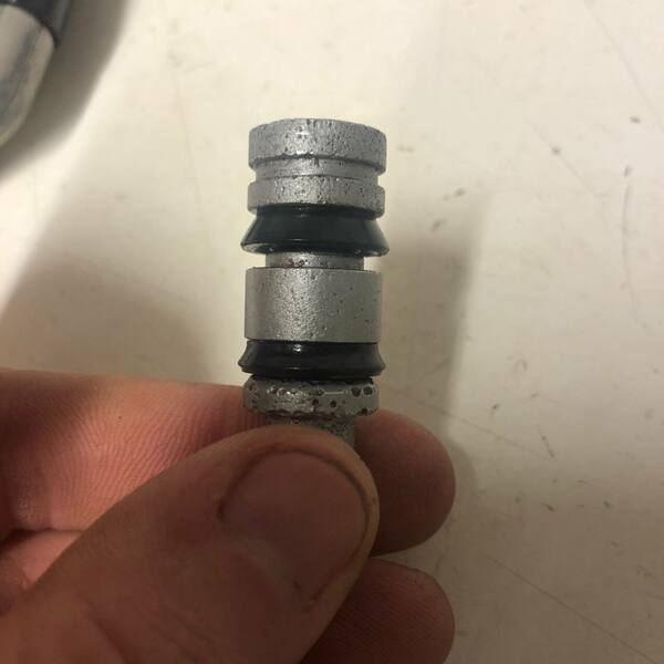

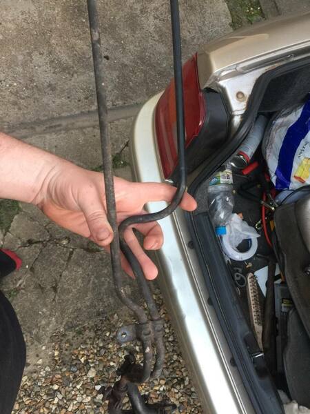

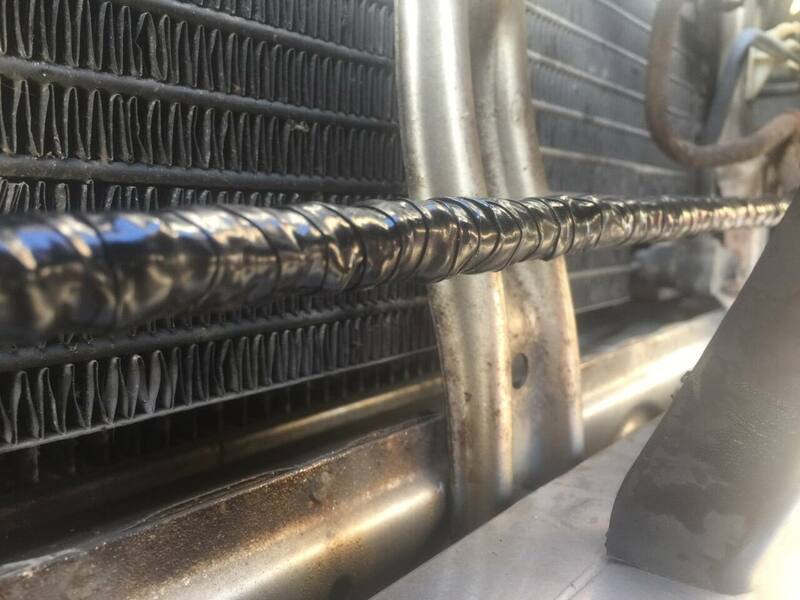

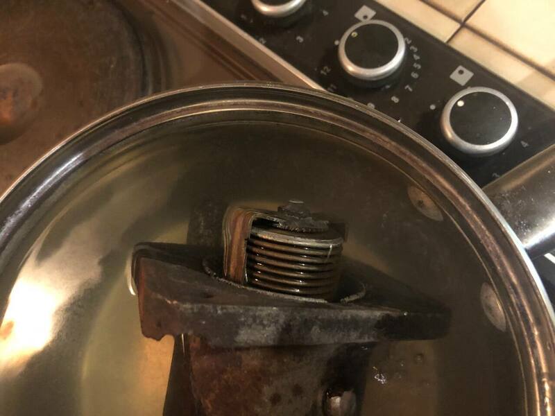

I noticed the power steering oil cooler pipes were in poor condition when I got the car. They are mild steel, and run along the bottom of the radiator support panel, with predictable results. I remember looking at 600s in scrapyards 10 years ago and the pipes were all rotten then. They basically loop around and go back to the pump, with a couple of short lengths of flexi hose which connect the oil cooler pipes to the rest of the system. It does seem a bit over-engineered to me, and I did wonder if you could just bypass the pipes with longer piece of rubber hose. But Honda deemed it necessary, and I like my cars to be as original as possible.
On one of my regular checks under the bonnet I noticed the pipes were damp in the middle, a closer inspection revealed a drip forming on the bottom of the pipe. Although it didn’t appear to be leaking very quickly,  I seem to remember dollywobber lost his PAS due to the rotten pipes on his one, so I started looking for a set. There was someone on eBay with some secondhand ones for £50. Seemed very steep. As a temporary measure, I wrapped some tape around it, but it didn’t really work.

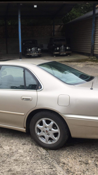

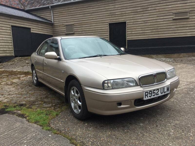

I was browsing the Rover 600 group on Facebook when I saw this post from Rover enthusiast/breaker Jared Whiting, showing a White Gold 620 he’d just purchased.
The passenger wing was clearly dented like mine was, but I excitedly messaged him to ask if he was breaking it and if so, what were the bonnet and boot like. He confirmed he was, and sent me some pictures which showed they looked ok. Few small scratches and stone chips, but nothing much. He gave me a good price for the bits, the only problem was today was Thursday, he already had it booked for car take back on Monday so I needed to get there sharpish. Where was he again? Market Drayton, other side of the country. Oh well, it’s a day out!

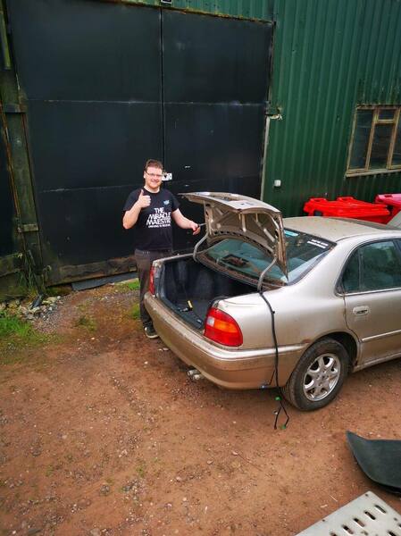

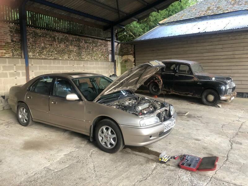

Arrived about 12 after getting hopelessly lost and failing to find his yard. The 620 had 170k miles on it and was very rough. It was filthy inside and out and was still full of the deceased previous owner’s possessions. I didn’t feel guilty about stripping it for mine, it had been sat for a few years too. It still started and ran ok with a battery, good old Honda engines.
That’s me while the job was going reasonably well!

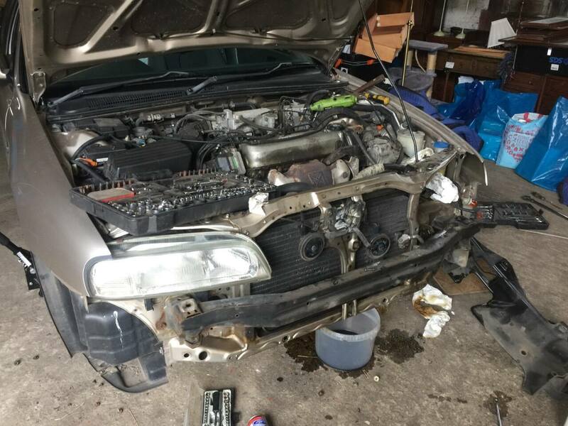

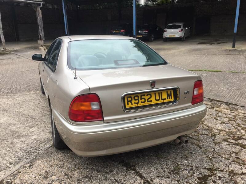

I started with the bootlid, which I thought would be a battle. I was right, getting the actual bootlid fitted wasn’t too bad but threading the loom through was tricky and swapping over the lock and connecting up it and the internal boot release was a massive ball ache. Which culminated in me shutting the boot to test it latched, which it did. However, I had failed to fit the internal release cable correctly, meaning the boot remained resolutely shut and I’d thrown the keys down in the boot while swearing at the mechanism!
The back seats do fold forwards but you have to pull straps inside the boot to release them, meaning that was a non starter. Fortunately, the lock was worn enough that wiggling the donor car’s key in there popped the bootlid open!
Eventually got that all working properly, so then swapped the bonnet. That was easy enough, four bolts and the washer pipe.
I wanted to take the electric Ariel, as the one on my Rover is partially seized, but I couldn’t shift it, so I had to leave that along with the nice GSi spec door cards that I simply didn’t have time to remove. I did, however, manage to save a set of genuine mats in grey, which are quite rare. The drivers one has lost some of its colouring but the others have cleaned up really well. They fit much better than the old universal mats do and look much better.

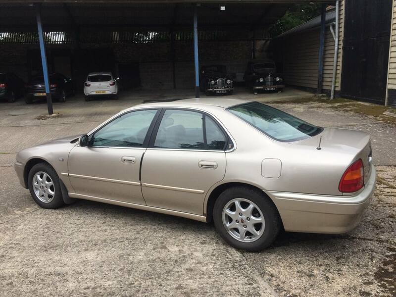

Another bonus to this trip was that unexpectedly, the pas pipes on this Rover looked in remarkably good condition, with most of the paint remaining. Best secondhand ones I’ve seen, not sure why as the rest of the car was rough and it was quite high mileage. Anyway, Jared cut through the pipes higher up with his power saw so I could salvage the clips, which were totally seized.
With its ‘new’ panels the Rover looked much better. The roof still looks shit but I haven’t got much choice with that apart from to have it resprayed.
Then it was time to tackle the pas pipes. I blasted and painted them, and they came out really nicely. Managed to free the donor hose clips with heat and copper greased them to prevent them seizing in the future.
Actually fitting them was a right old war, I had to use a dremel to cut through the old clips them wrestle the pipes out, they were obviously fitted before the engine at the factory and not really designed to be replaced! I took the bumper off and the headlight out but it didn’t really help that much, in fact taking the undertray off was probably the best thing I did.
Eventually got it all back together and bled up successfully. No leaks either, and the pas fluid hasn’t moved from the full mark since, which I’m very pleased about.

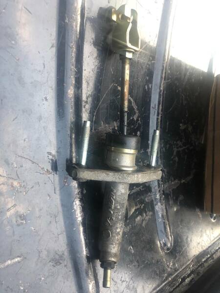

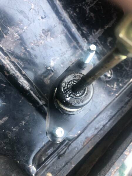

Over the last few weeks I’ve noticed the occasional crunch when changing gear. I thought it was me not pushing the clutch down properly, but then the gears started getting very sticky and reluctant to engage. I checked the clutch fluid reservoir, which was empty apart from a load of black sludge at the bottom. Oh dear. It was ok when I last checked it but that was a few months ago. I did think the fluid looked dirty, but I didn’t want to go looking for trouble!
The question was, where had it leaked out from? The slave cylinder looked dry, but a quick look up at the top of the clutch pedal revealed a telltale line of brake fluid running down the bulkhead from the master.
After a battle (I hate ‘standing upside down in the footwell’ jobs on cars) I managed to remove the old master cylinder. It’s a 5/8” Nisin centre valve type unit, this particular one also used in the comtemporary Honda Accord, which the Rover 600 is of course. It’s a very typical 80s/90s Japanese clutch master cylinder. New pattern ones are available on eBay, but they’re about £90 so I thought it was worth seeing if the old one could be salvaged.
I didn’t take a picture of the inside of the cylinder, but it was full of rust and old black brake fluid. The piston put up a fight to remove it from the bore, the old seals were obviously toast with no flare left, and the valve stem was seized into the back of the piston (done a few of these, never seen one that bad on a working car). I’m convinced the clutch fluid had never been changed.
The piston was quite badly pitted and corroded, but it was fine with a new seal kit fitted. Piston cleaned and new seals fitted in this photo.
Surprisingly, the bore was in good condition and just needed a light clean.
I then fitted it back in the car, which was a shit job and my elbow is still hurting after I trapped my arm behind the pedals while trying to tighten the master back onto the bulkhead. Hopefully I never have to touch it again!
I managed to bleed it up ok, and it feels much nicer than it did before, a lot smoother with the occasional snatch when moving off in first gear now gone. Inevitably, the slave will need doing at some point but it’s not currently leaking, and that’s nice and easy to get to on this car. So not too worried about that.

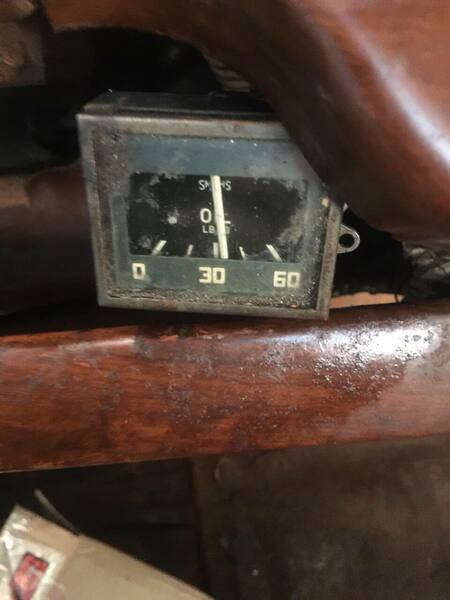

I knew from my churning the engine was delivering the nice clean oil to the top end well, but I had no oil pressure showing. I suspected the oil pressure gauge was seized as it never moved off 20 psi. I had a rummage through my spares and found a spare Somerset one which had the right connection. I connected it up and it showed good oil pressure when cranking.
Original stuck gauge:
Temporary one, while cranking:

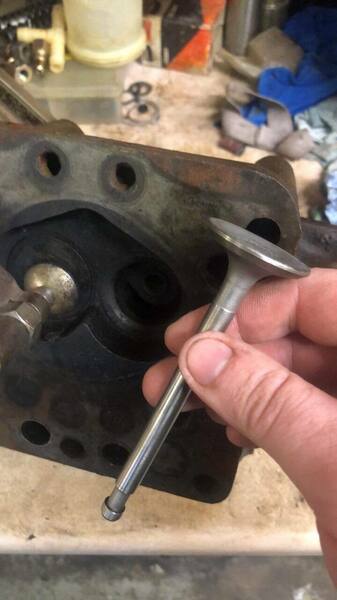

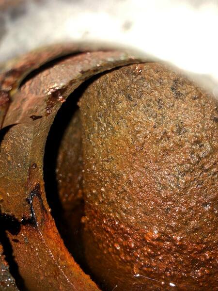

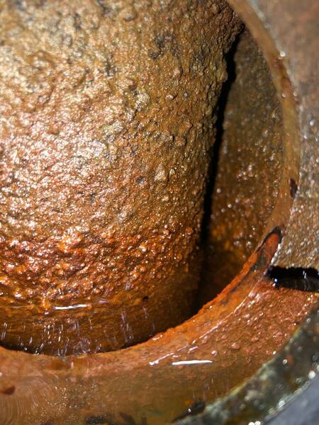

The stuck valve had resisted all my efforts to free it. I managed to get it moving but it was still too tight in the guide to move without assistance from a couple of crowbars. In a moment of frustration I fired up the blowlamp and tried to get some heat into the guide, although all I managed to do was melt the stem seals and ruin and distort the valve spring and slightly damage the one next to it.

I decided the head would have to come off, so after procrastinating about it for most of the BH weekend, I got the spanners out and had it off in an hour.
I took the water pump off, primarily to get access to the block waterways, which I imagined would be clogged to high heaven. Surprisingly, they looked pretty good.

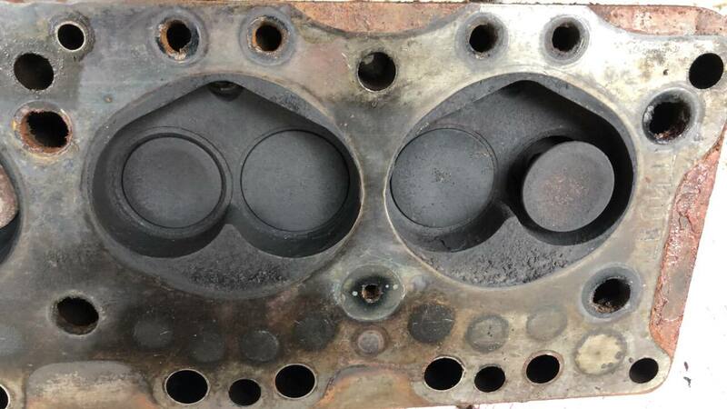

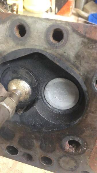

I took the head into work and used the press to push out that stuck valve. The guide on that one was full of rust, I’ve honed it smooth but didn’t  want to overdo it and take metal off the guide. The other guides are all in perfect condition.
I cleaned everything up in the parts washer, and made a start lapping in the valves, the old fashioned way with a stick and paste! It’s nice working on an engine that isn’t totally clapped out, I decoked the combustion chambers and polished the mating surface with some very fine w&d. The heater valve was full of crud as was the thermostat housing, and needed several goes in the ultrasonic cleaner to get it half decent.
Look at how well that Gold Seal paint has come up!

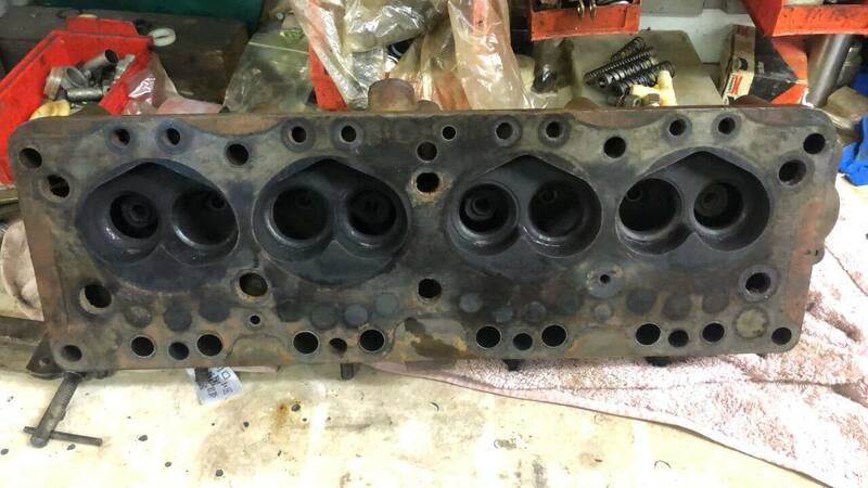

I finished rebuilding the head and refitted it.

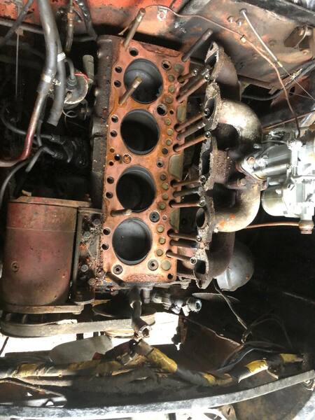

When fitting the pushrods, two of the cam followers dislodged and I then dropped a pushrod inside the engine. Balls. So I had to then remove the inlet manifold and push away the exhaust manifold and downpipe (because I couldn’t get the downpipe bolts undone) to access the cover for the cam followers.
The pushrod had dropped deeper into the engine. I could see it laying on top of the camshaft but attempts to retrieve it made it drop into the sump. Ffs!
I took the sump off and took the opportunity to check everything over. The oil strainer looked very clean and there were no issues. I scraped the congealed old oil out of the bottom of the sump, then refitted the sump with a new gasket.
I removed all the cam followers and pushrods, cleaned the surface rust off the pushrods and oiled everything up before fitting them back in and fitting the cover with a new gasket. It had been pissing oil out for years by the look of it.

Dishwasher tablet in cooling system is one approach but I don't know if you want to take that option on such an old car.
