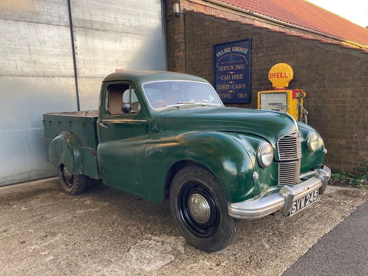

Floor in and finished with dark wood stain, trying to make it look like it wasn’t all new in 2026. I think it looks pretty good if I do say so myself. I’m waiting for some period-correct brass countersunk, flat head wood screws to arrive then I’ll fit the restored ironwork (the steel strips that run lengthways down the bed).
Fuel filler neck was rotten, two holes in it and a bit thin in places, I brushed on a coat of POR-15 fuel tank sealer over a couple of little tin patches, then once dry a coat of black enamel. Rubber hoses replaced as a matter of course. The originals were in very poor condition.
I bought some rough sawn planks from a local reclaimed wood place, they needed a fair bit of sanding but have come out ok, nice bit of patina on them as well.
 Metal rubbing strips having had a coat of zinc primer.

Thanks. I’m quite pleased with it!
It probably would have been less work but it still would have needed a good few days spent on it.
The Briggs body (the usual one fitted to Hampshire pickups) has a steel frame with aluminium sides. All the steelwork was rotten on the flat packed one John had.
Incidentally this has now been purchased by a club member in Northern Ireland, who intends to fit it to an Aus import pickup which is fairly solid but its body tub was missing.
To be honest, I’ve been enjoying the woodwork. Makes a nice change from seemingly endless welding.

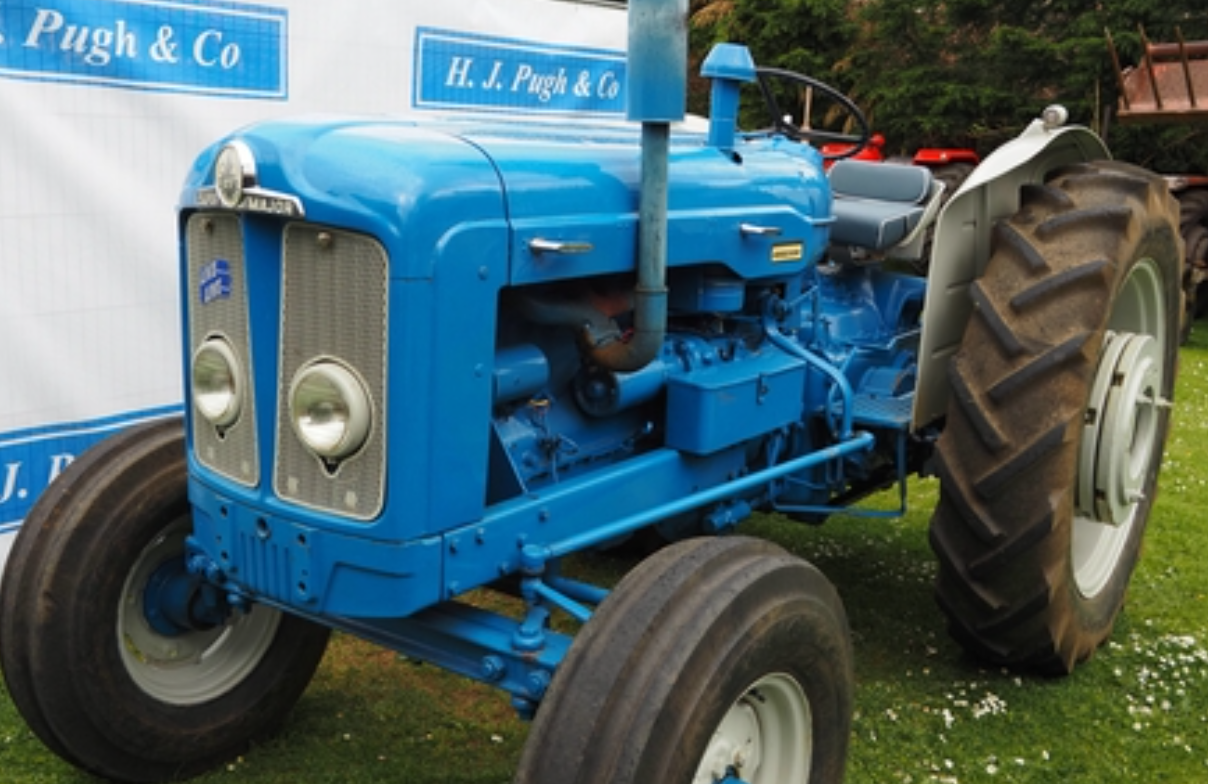

Another thing I thought about was if this was painted in Fordson blue back in the day, the new paint they are applying today is almost too glossy I think and unsure if the tractors were really like this new and unsure if this would fit the pickup. Someone maybe make a ai pic of it in this color?

I suppose the problem is it’s not very original! It was originally supplied new in fawn (with black wings) to a farmer near Colchester. I don’t know how long he had it but presumably not very long. Ernest Doe then bought it, repainted the fawn parts blue and had it blue with black wings.
Then once they sold it, the paint was flatted back and resprayed the current dark green.
The signwriting is interesting, but a lot of it is almost totally unreadable, especially the bits on the cab.
That looks more like the later Ford tractor blue, I recall Fordsons as being a different kind of blue. Certainly never saw a shiny one. Neither of the Fordson Majors  that I drove were anywhere near new mind!
Presumably the correct blue is the blue that can be seen on the back of the cab in the photos with the bed removed on the previous page?  I assume it survived in the places that the green respray didn't reach.

I think I’ve made up my mind. A sympathetic restoration back to Doe’s colours and livery. Resprayed in cellulose so it doesn’t look ridiculously shiny. Interior left as it is.
