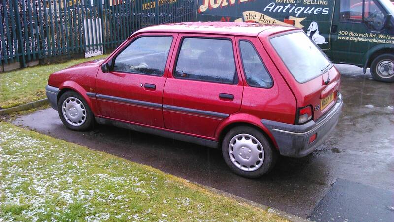

Looks tidy and the colour suits the shape well. That key ring looks lush also! I like a good key ring!

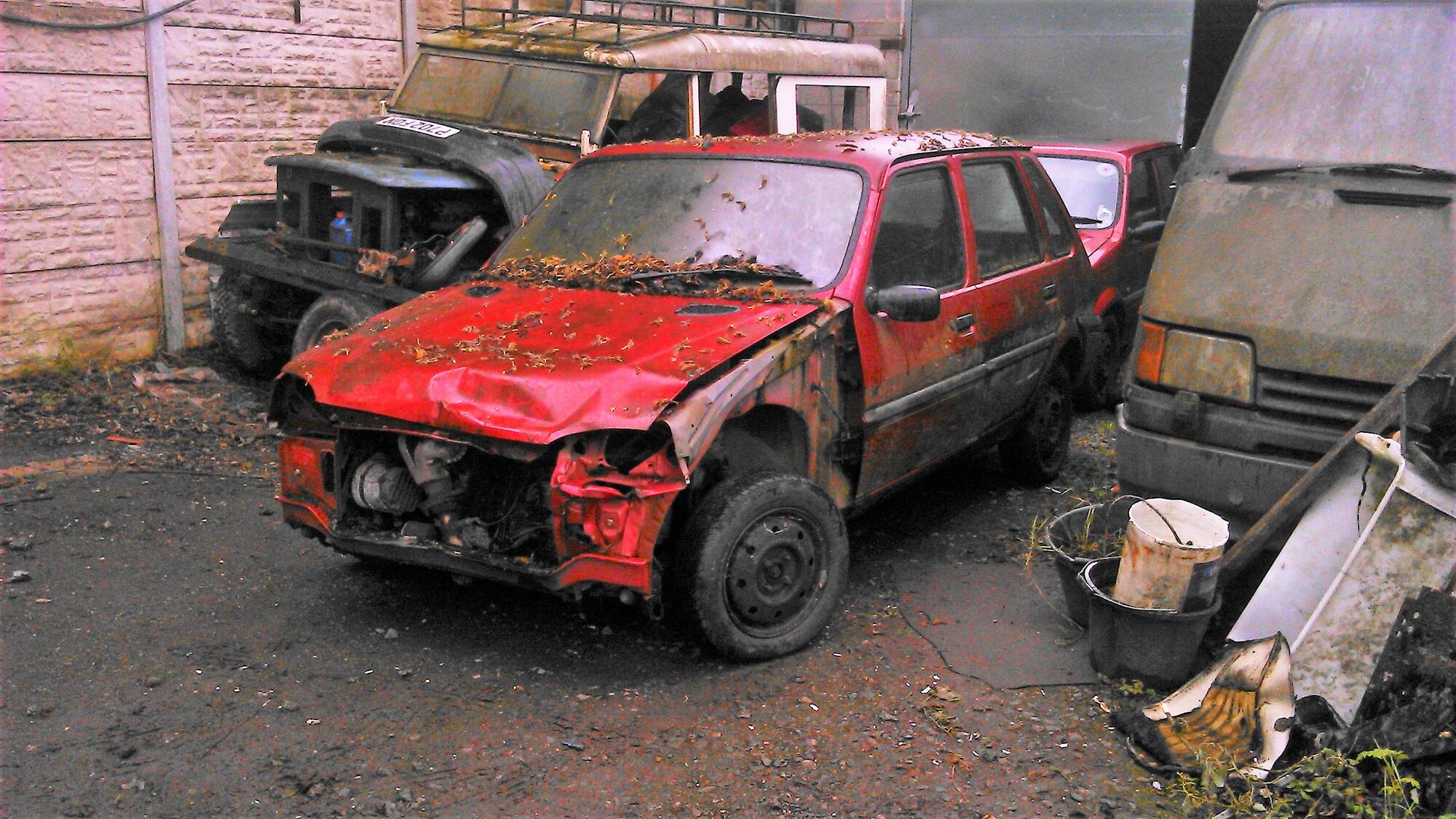

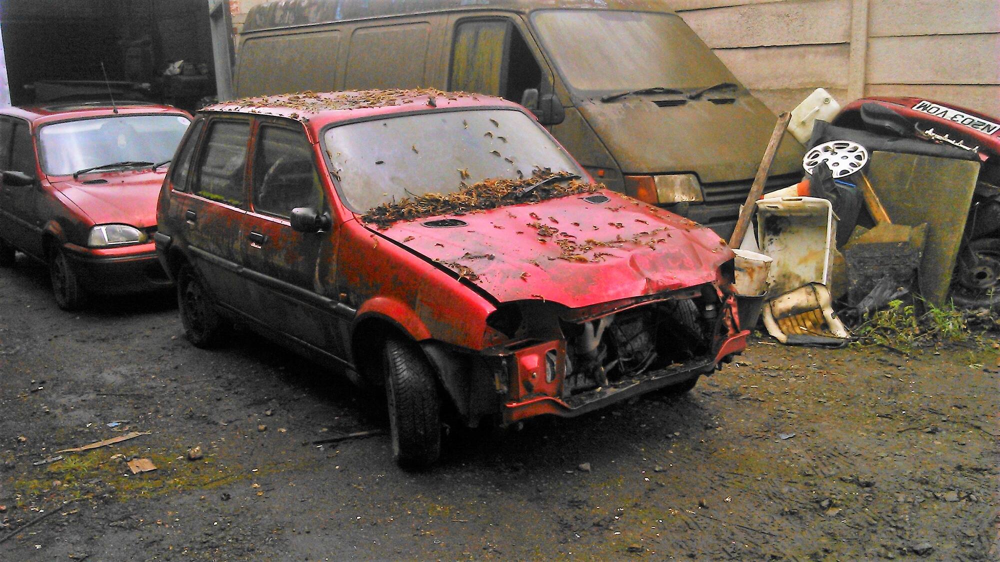

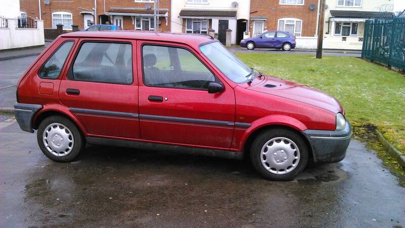

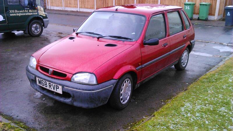

I wouldn't be to worried about crashing it compared to similar cars of the era. This wrote off a Fiat Punto and Vauxall Astra and the driver ( my son ) walked away uninjured.

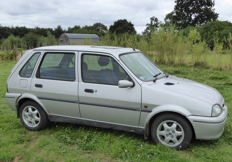

I was given it HGF on this forum and my friend helped me change the head gasket, but in spite of everything we did it would heat up quickly. I stood it in the field and one day I got it out to photograph it for an advert and it was fine. Hairnet drove it backwards around the field and it was still fine so I can only think it was an airlock. By then I had bought the fully running beautiful SLi in nightfire so sold it on for the price of the bits still needing an MOT.
I agree, crash resistance wouldn't overly concern me either.  A lot was made of the 100/ Metro's lack of crash resistance but it has to be put into context. The basic shell lived far longer than intended. When Metro came out in 1980 it was actually on a par or better than it's contemporaries. It just lived so long that in that respect there wasn't much Rover could do as the basic shell was an old design never designed to meet a much harsher offset crash test. It was designed to hit a barrier at 30 mph head on & did that rather well.
A 1970's/1980's Fiesta or Polo would be pretty similar in an offset crash test or probably worse. A friend of mine worked at TRL where they crash test cars & couldn't believe how poor a breadvan type Polo was in a wallop but nobody goes on about them being unsafe.

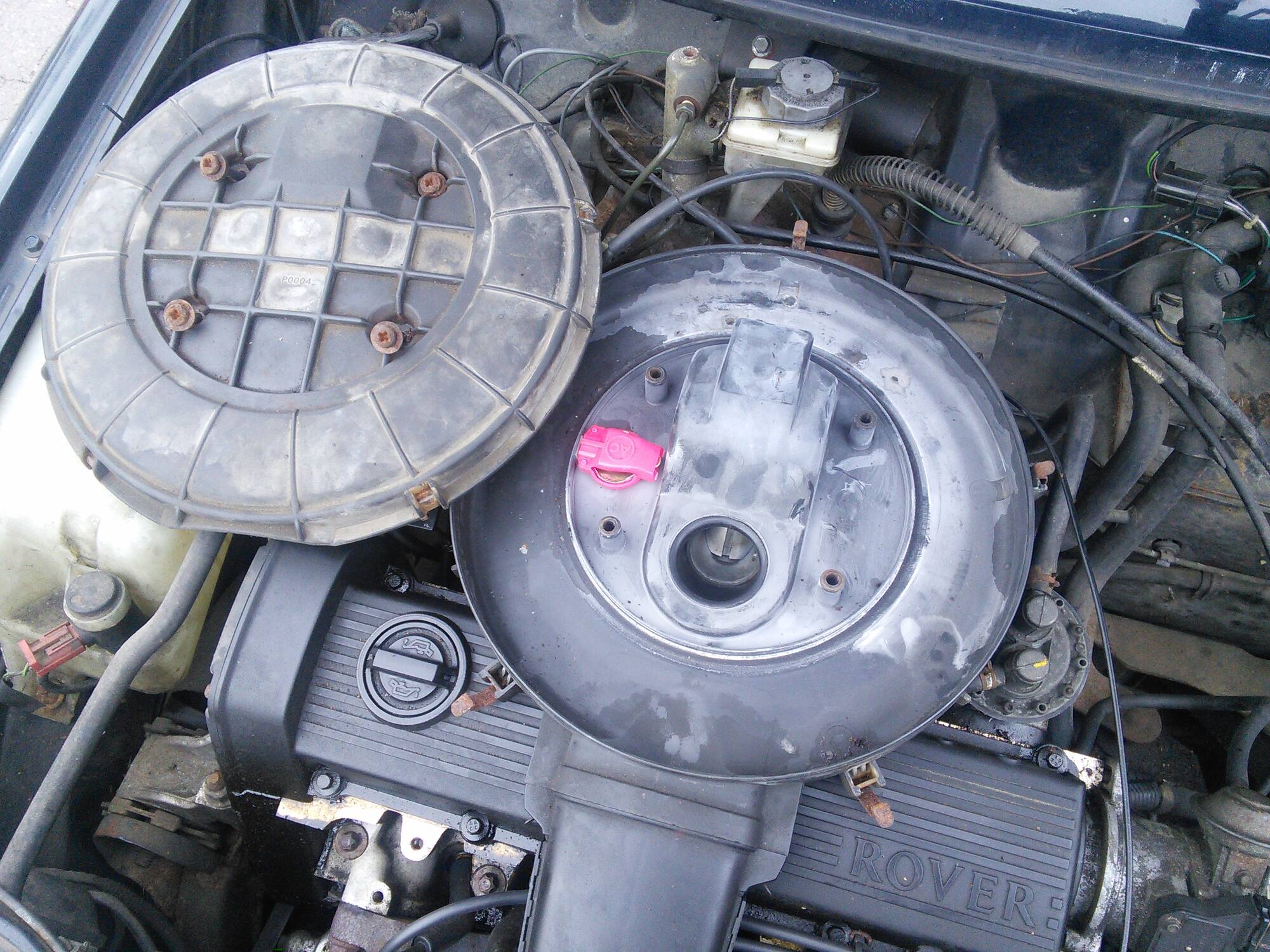

Let's check the air filter, oh there's not one... what's that pink thing?!
Oh, I think the water leak status has just been upgraded to 'urgent'
Bugger! I just hope the previous owner didn't cook it.

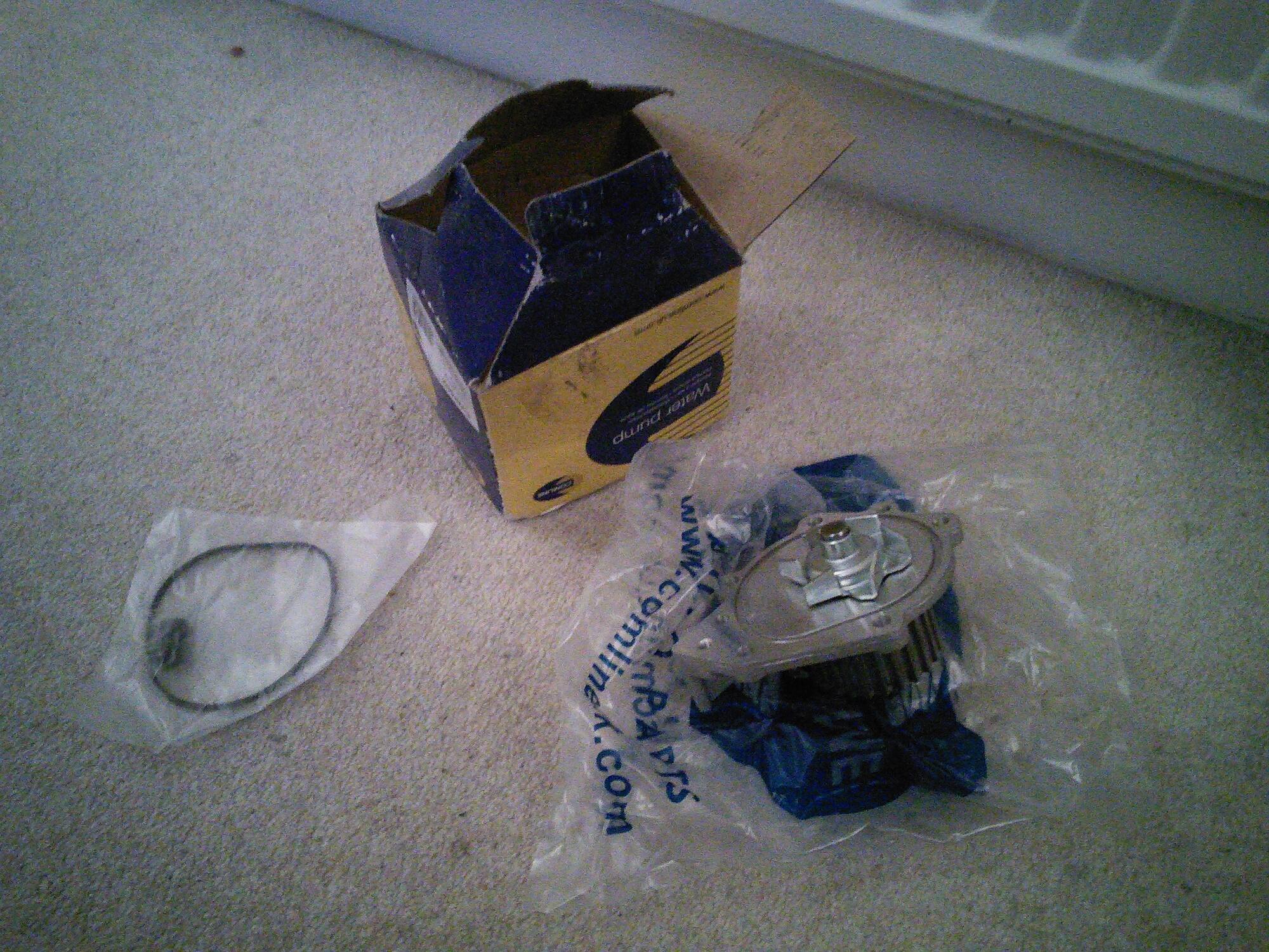

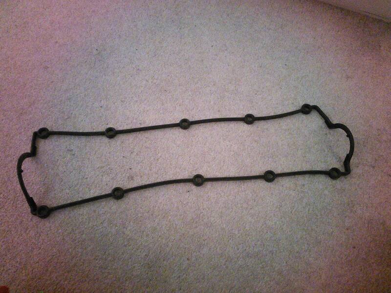

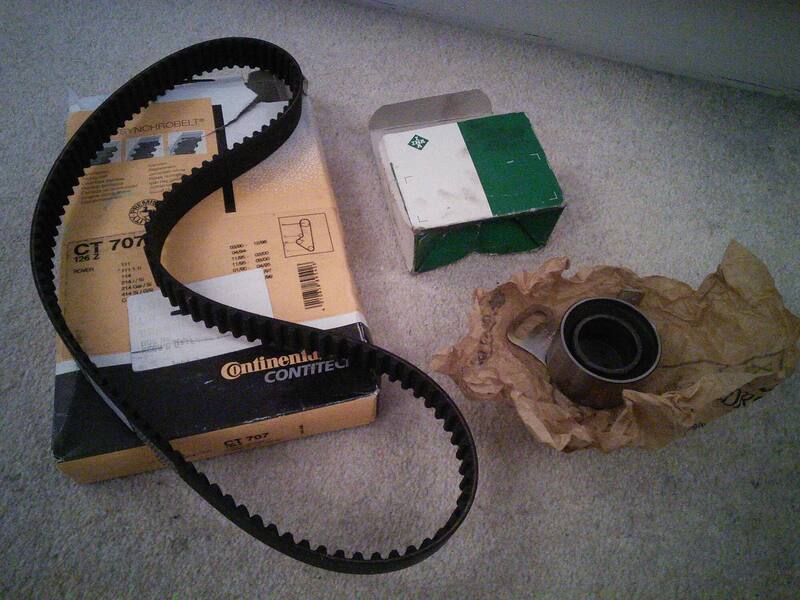

One compensation of a possibly large garage bill is the parts that came with it, cambelt and tensioner, a tiny water pump and cam cover seal. There's also a drive belt that has got mud on it!
So I also probably need...(or garage supplies with their mark-up)
Crankcase ventillation perhaps?

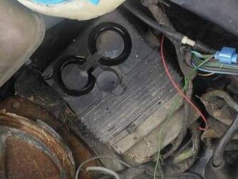

Interesting idea - infinite* speed control?! You'd have to explain to me how that would be wired in. Spliced into existing switch wiring?

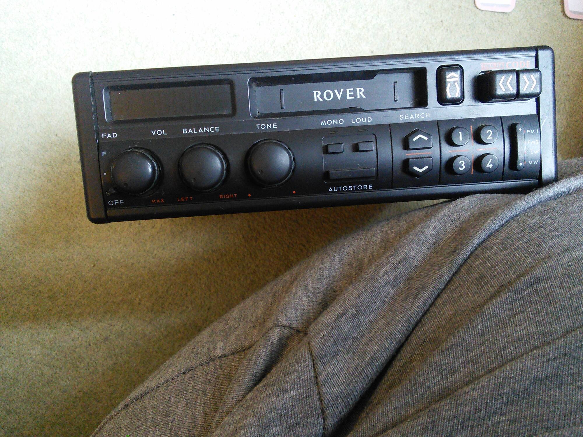

Thanks to @JimH for the donation of an OEM cassette player!
I don't have any of the connectors on the car, just bare wires, but it can't be beyond the wit of even an egg to do something with it.
from memory rover radio wiring colours are thus
blue, green, orange & grey- 4 pairs with trace on one of each colour = speakers
brown or purple= perm 12v+
red= switched 12v
black= earth
orange?= lighting circuit for display illumination/dimming
take a pic of loom and it might jog my memory betterer
Thanks, I have seen that one too, but I thought it wasn't quite right as connectors on the resistor look to be in a different place?
I can see why they are dear too, they are popular LR Series heater conversions by the looks of things.
It wouldn't bother me. I can't imagine BL/ Rover launching an R and D exercise and development of a new heater control for a metro which is largely taken from the old metro. But then that's probably why I have an excessive amount of parts bought that don't fit.
