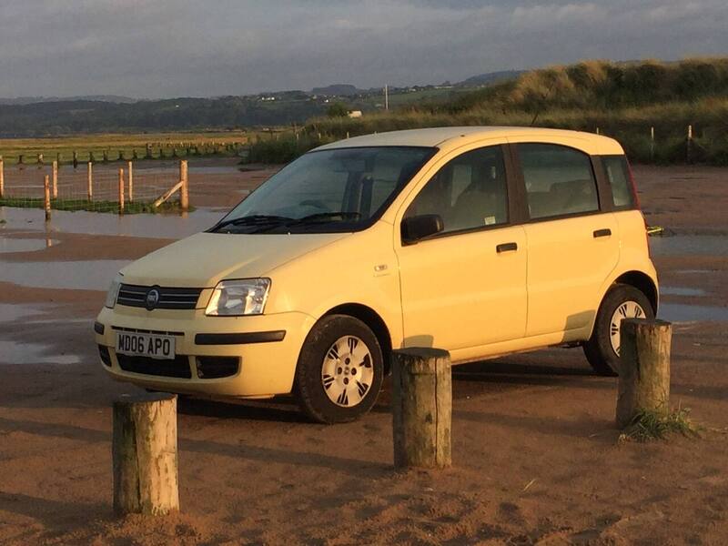

I also have one, I love it.
Its in yellow with yellow interior. There’s nothing to go wrong, Fiat made a really good, solid car.
Same colour as the one I had
Mambo yellow is the bestest colour.... Fuck the 500 yellow on 2010+ ones.

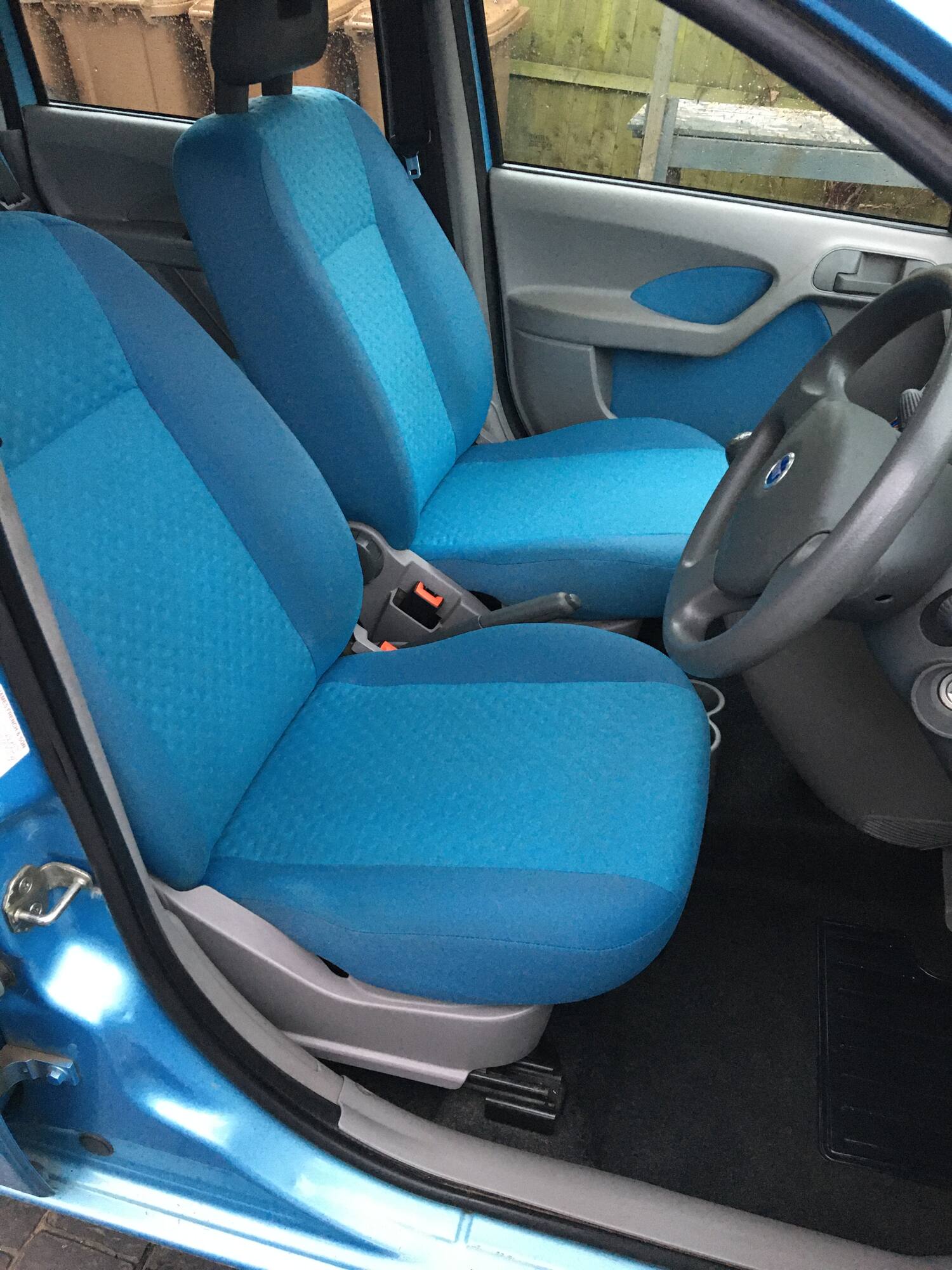

How did you clean the seats?
That's what I was gonna ask. My Alessi seats are manky.
It’s called ValetPro Classic Carpet Cleaner.
Theres a shop near me that specialises in proper car cleaning kit. Very helpful and recommended this stuff. The 1ltr tub is concentrate, only cost about £8 and has done the whole interior, seats, boot, headlining and carpets. It’s all gone though.
I’ve used other stuff in the past but I was impressed how easy this cleaned the stains. Will buy again.
Dilute it 1:20, use a household type spray bottle and I found saturating the surface worked better.
I then used a nail brush to scrub it clean. Very simple.
In theory you leave to dry or dab with a micro fibre but first I vacuumed the surface and then left a dehumidifier in the car.
Ah, I assumed you used a carpet cleaner. It looks great for being hand done.
Ah thanks. I found a nail brush makes the fabric bobble more, depending on fabric. I just damp cloth with cleaner on the 206, but loads of elbow-grease.
On the parcel shelf, this did indeed happen but the seats were unaffected despite vigorous brushing ?

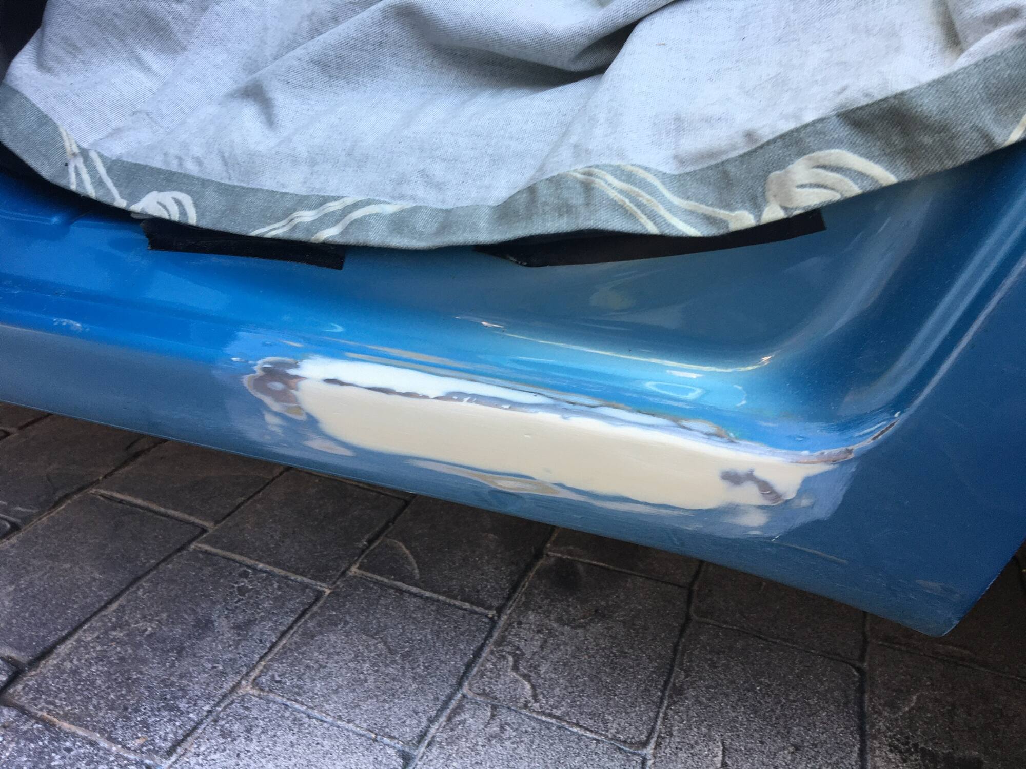

I’ve done very little to this car since buying it, except cleaning the interior which is now lovely and rebuild the front brakes (original pads and discs were fine, just stuck from inactivity). A couple of ‘innocent’ comments from the wife though regarding it’s decidedly battered bodywork led me to a sunny afternoon trying to tidy the old girl up. It’s only done 42k and drives fantastically, very little corrosion apart from the rear beam which is very salvageable.
Initially I attacked the drivers side, the bottom half has taken a thorough scrape, the worst dent was the front wing which i’ve managed to straighten a fair bit, it’s a good 60% now. Removing the arch line gave me perfect access with a hammer and dolly. I then hit it with some 1200grit followed by some G3 with the machine polisher and then some old polish I had lying around. Some of you will be pleased to read I didn’t even bother washing it before doing all this, G3 seems to remove bird shit well enough....no buckets.....The bottom of the doors are fairly rippled but i’ll get some paint and cover the scratches. The sills and rear arch are undamaged though.
I threw some tyre gel at it and truth be told, it looks great. Well used, but loved.
Then came the passenger side, the rear door is totally wrecked. Destroyed along the crease line. I took the door card out and gave it a good thrashing but I can’t do anything of value with it really. I might try and source a replacement when all this shizzle is over.
The real main event though today is the sill which has also taken a battering. It’s been pushed in such that it touches the bottom of the door where there should be a 4mm gap. I decided to hit this with a budget version of something I saw Ed’s China doing years ago. I, of course, don’t have a couple of grands worth of dent removal kit so I employed a drill, wood screws and a slide hammer that i’ve been waiting for an opportunity to modify to make it vaguely useful.
It still needed an incision to regain that 4mm gap but is starting to take shape after its first skim (read trowel) of filler. I even filled the cavity with some Dynax S50 I had spare.
Everything i’ve done is with consumables that i’ve had lying around the garage for probably years so ZERO spend so far. I will need to buy some Azzuro Frizzante paint though for this and the other touch ups. Anyone know where I could get some online? Ideally half a litre in a can rather than aerosol.
