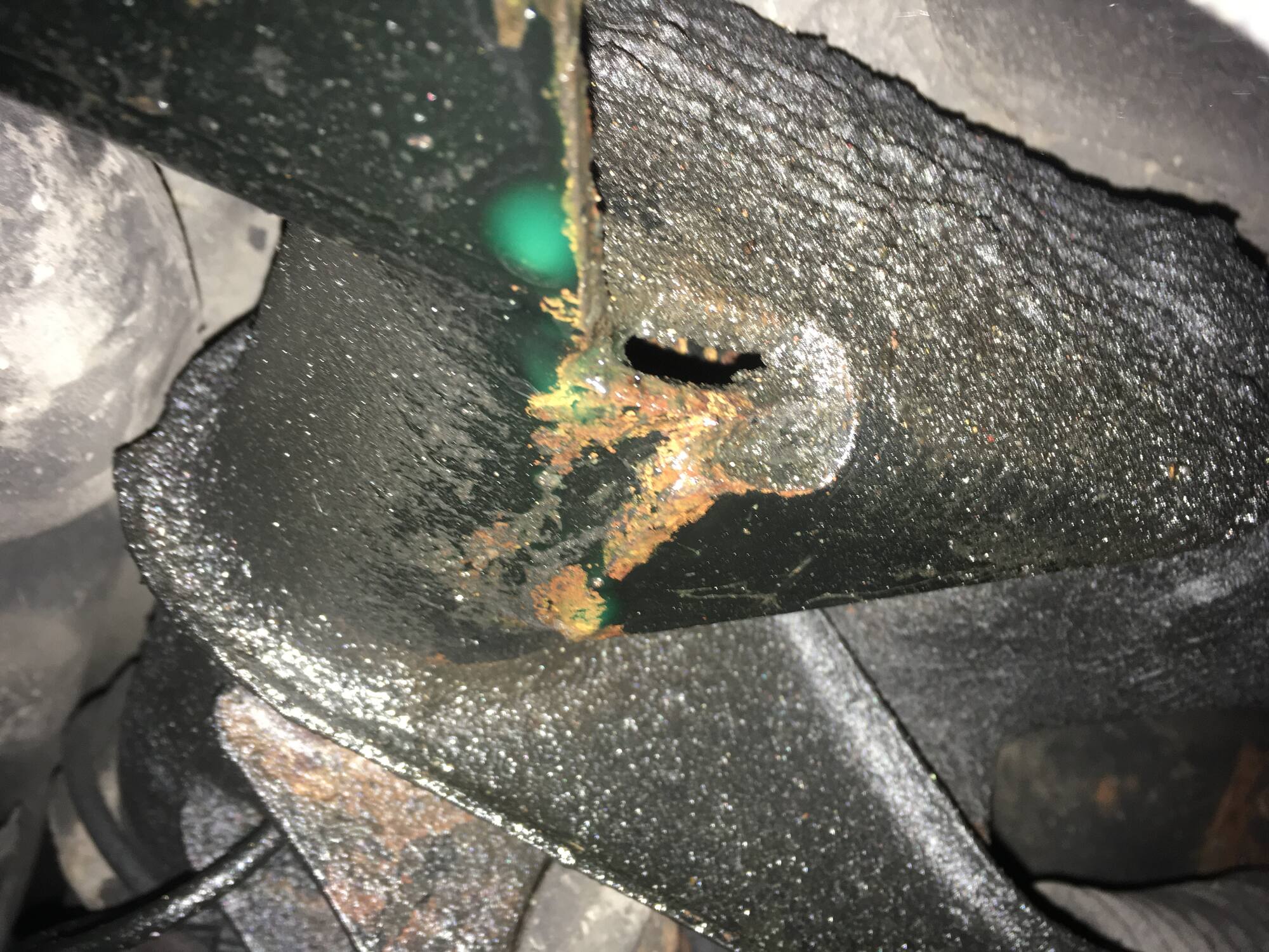

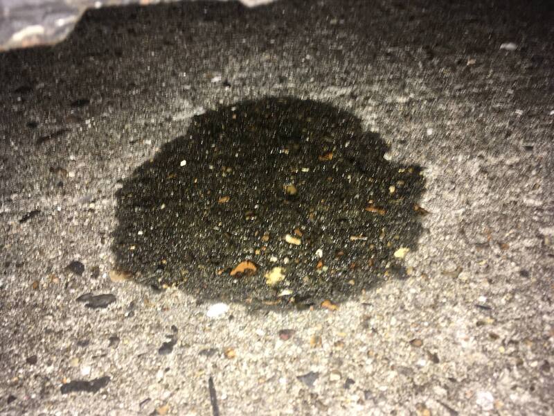

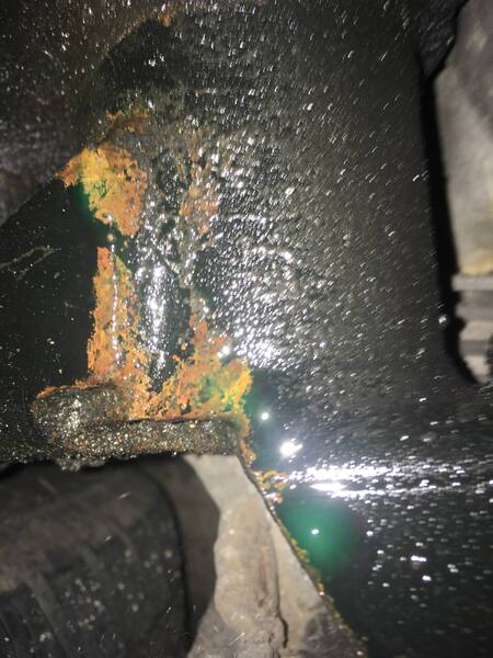

Noticed a little patch where this has been sitting for a couple of days, and closer inspection revealed that it's LHM. Hey ho, at least it looks very fresh!
This is the rear suspension arm bearing area, so it could be coming from the strut I'm guessing. This has appeared as the rear suspension has sunk, so does that mean that it's a low pressure return pipe? (Crosses fingers)...
It's spontaneously preventing rust.

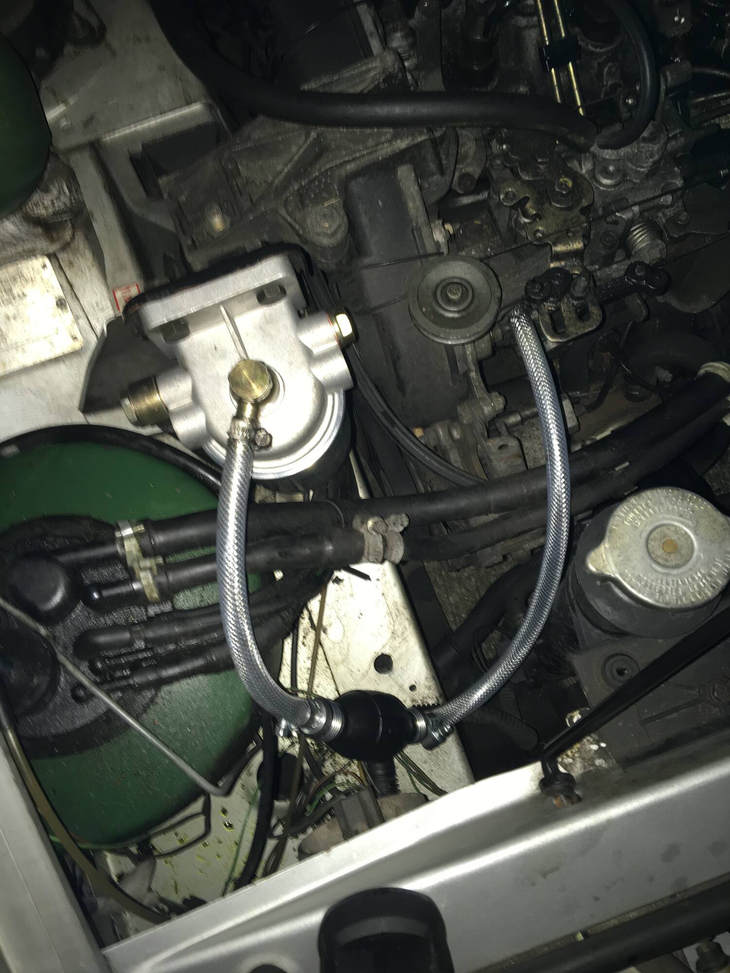

Fitting the new filter in the dark. FUN!
the flipping hose to the filter is 10mm which has scuppered my plans.. any reason why I can’t put the priming bulb AFTER the filter?
Currently like so, just to get it running
That was what happened at the front of mine not long after I got it, and I just had to replace the low-pressure return  pipe where it had snapped. They both went within a month of each other. I didn't get a neat little puddle like that though, the stuff pissed out everywhere while the car was in the process of settling!
Only reason I can think of it working better before the filter is you've not got to fight the extra resistance of the filter pulling the fuel through.  Interestingly, that leak at the back mine had too and then the leak just went away.  I assume I just had a bit too much LHM in from when I massively overfilled it.
It seems to be running much better now with the new filter housing. Just the glow plugs to do now, if it even needs them.. we’ll see at the next cold start.
I had filled mine pretty full too and the leak hasn’t happened again.... hmmm!

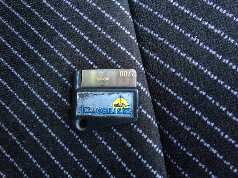

Another obstacle between me and a happy life is this flipping ancient immobiliser chip. I’ve only got one, so rather than risk losing it I just leave it plugged in all the time.
The connections are a bit dodgy and you sometimes have to give it a bit of a press to get the glow plug relay to engage, which isn’t helping me diagnose an occasional reluctance to start.
How hard can it be to get rid of it? If you try starting without it in, the glow plugs don’t light up but the starter turns. If you yank it out when it’s running, the engine dies, meaning it must operate the stop solenoid? Could it just be those two things or am I missing something?
How do they work? Are they wired to the fusebox and interrupt the existing relays or something?
I wonder if it might be possible to give those immobiliser key contacts a wipe of fresh solder to see if connections can be improved.
Yeah maybe. I’ve got some switch cleaner that I could spray into the socket too. I’d love it to be gone entirely though
What brand of immobiliser is it? Someone out there probably still has a wiring diagram.
That doesn't look very sophisticated .  It might be worth having a careful look at the loom and seeing how it is connected.  Does it just break into certain circuits and reconnect them when the key is inserted?
No such thing as a wiring diagram, I have removed a fair number of these though, you find the box for it first and then trace where it intercepts the car's loom.
Indeed.  I once removed a dealer-fit immobiliser from a Subaru Justy after I lost the keys, and I am a complete electrical numpty.  Once you find the box it's a piece of piss.
