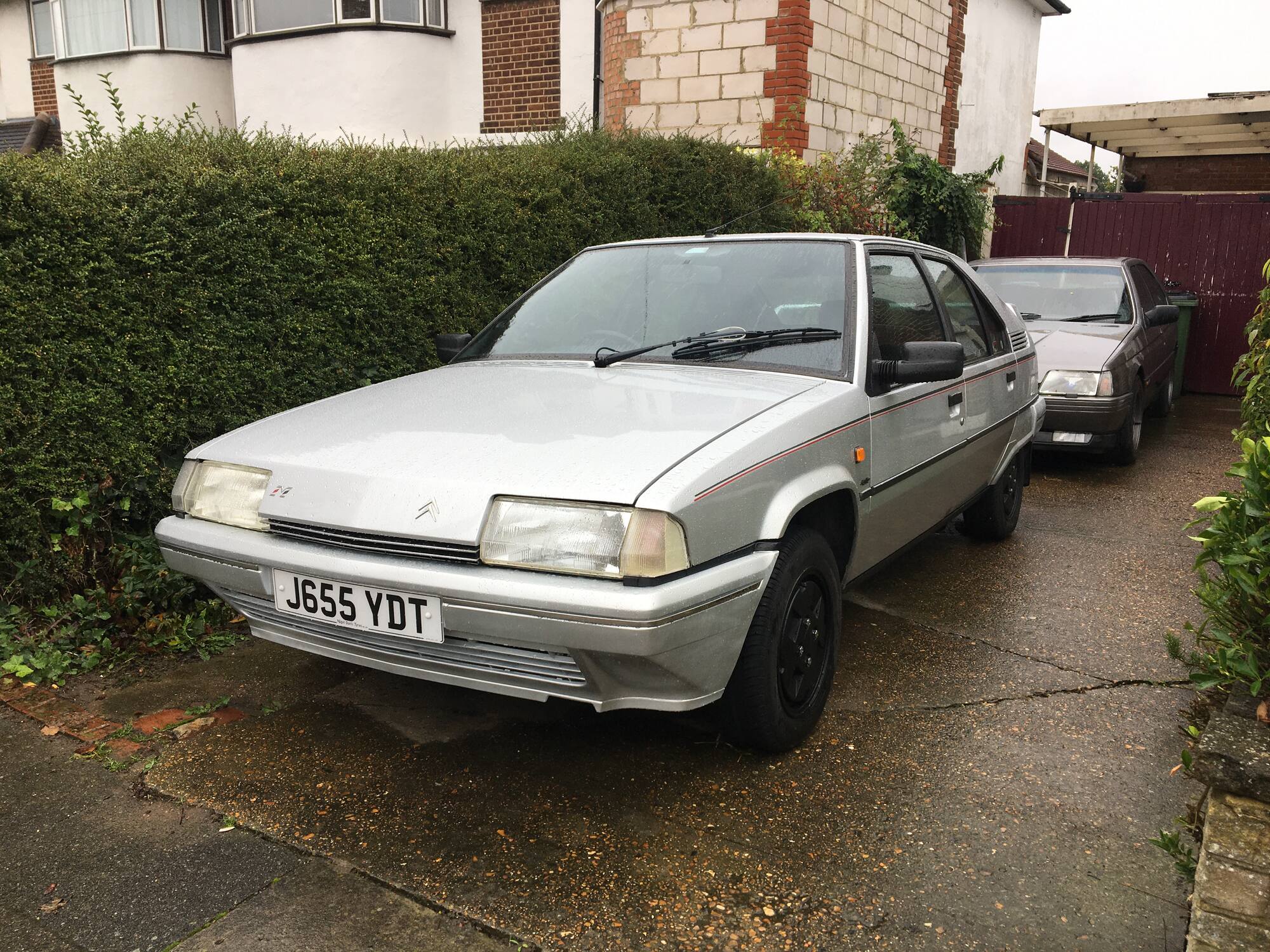

I'm soo glad to see this pic. That's my old 3litre 164 manual lusso that I sold to Clive (the vendor) back in 2012.
Glad to see he still has it. Only car ever that I regret selling and would have it back off of him in a heartbeat. Bet he would want more than the £600 I sold it to him for though!
Ha! It was in great shape and he clearly loves it. I had a bit of a poke around it..  Amazing dashboard and lovely plush seats. Here it is tucked in behind the BX

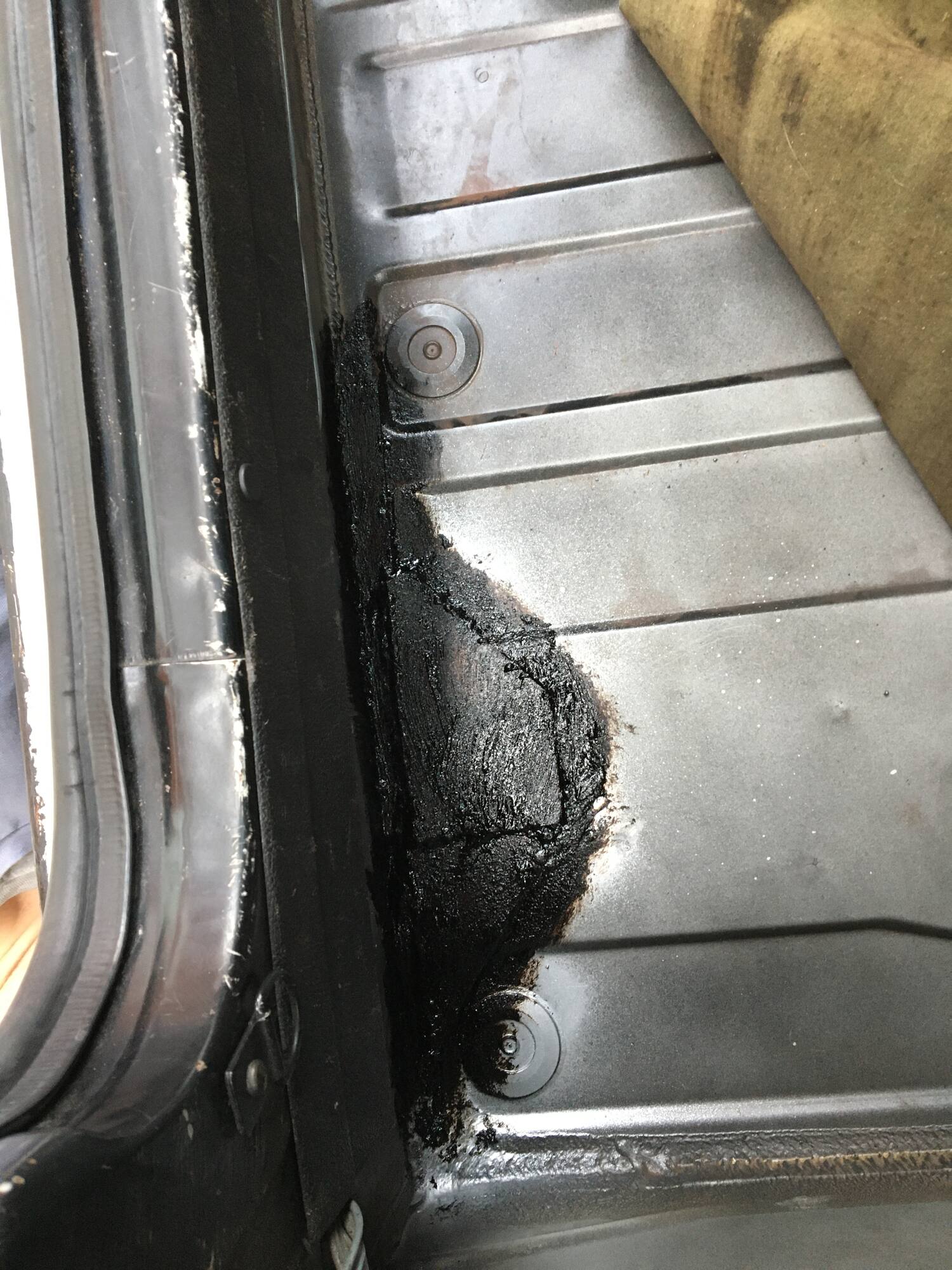

When viewing the car I'd noticed a hefty bit of rot in the boot floor on the other side and haggled accordingly. So it didn't exactly come as a surprise, but even so it's always a bum-clenching when prodding further.. luckily it seems to be pretty localised and so @Rave patched it up to keep everything solid and watertight for now. Many thanks to that man!

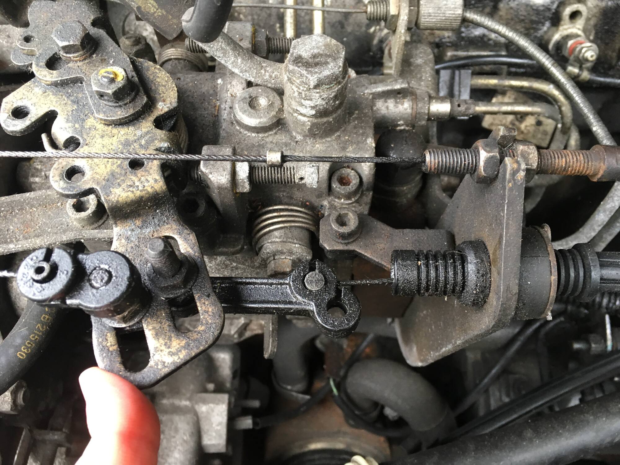

Sorted the kick down problem which is very satisfying.
The Haynes manual gave a baffling array of measurements and nonsense for the cable which varied depending on year, petrol/diesel, but gave no indication of the figures that applied to me.
You know sometimes you’ve just got to have a prod about and work it all out for yourself? The kick down cable is attached to an arm on top of the fuel pump, the same arm that operates the throttle. There was a bit of slack in the throttle, meaning that the arm moves quite a bit before the engine revs rise, by which time it’s pulled quite a bit of kick down cable.
Taking up the slack in the throttle cable and releasing some slack into the kick down cable has things operating way more as they should! It has a little ferrule to give an indication of where the kick down cable should be at rest.
Whats more, both the throttle cable and the kick down cable can be moved towards and away from the arm spindle on slotted adjusters, so I slid the kickdown cable toward the spindle, meaning it pulls proportionately less cable for a given amount of throttle.
Using these points of adjustment you can really fine tune the way it drives..! Whereas before it would hold onto second for ages out of a roundabout, now it’ll happily slosh up and down as it should.
