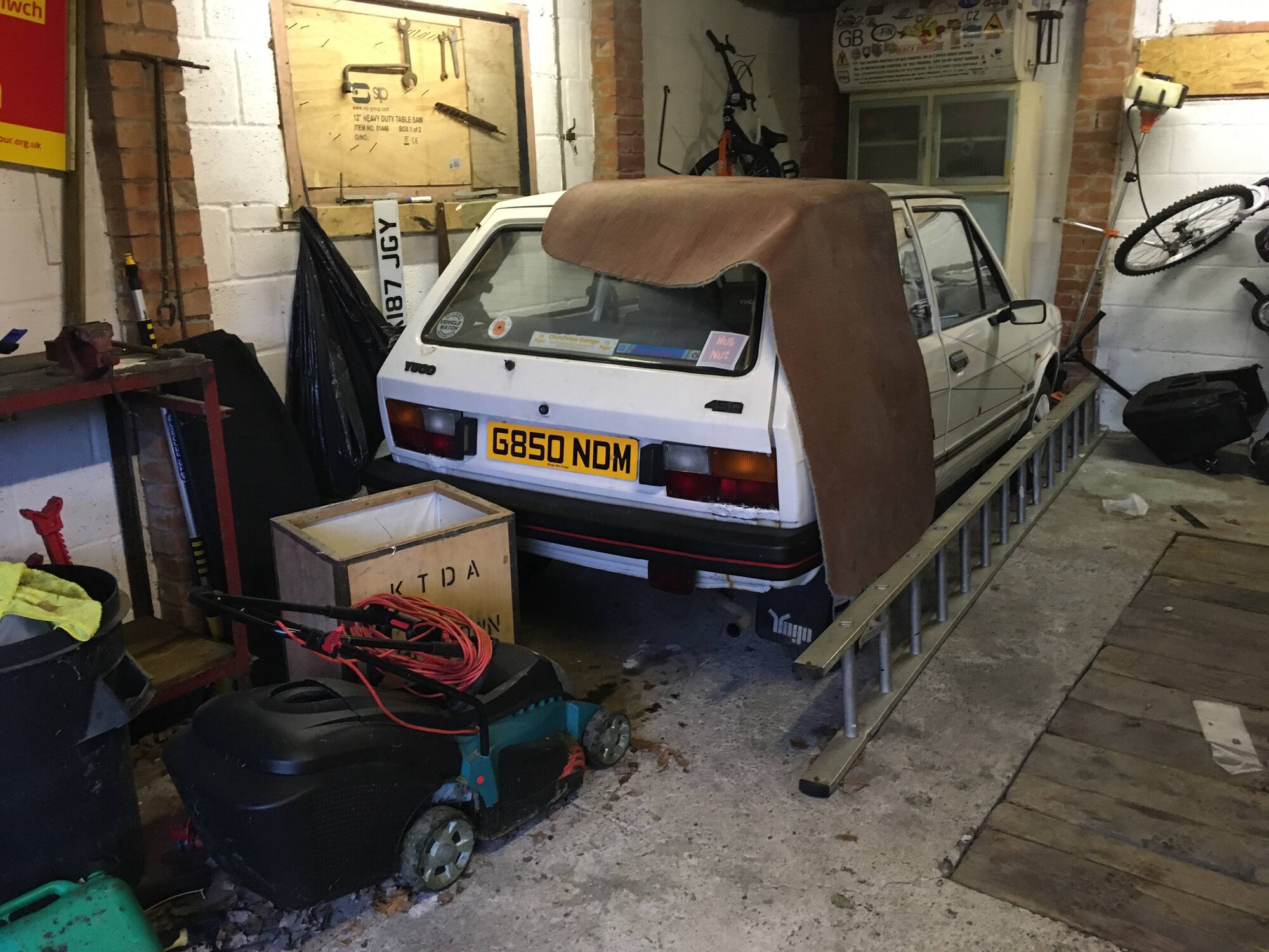

So I’ve not touched the Yugo for a couple of months. Progress had stalled due to not getting it going quickly (I’m a millennial- I like quick results). I had meant to get back to it over Christmas but it was cold and I chose to do other things.
 Today I got the 2CV out of the garage and saw this... 218857A6-1321-4A4E-9E23-269280FD0FF5.jpeg

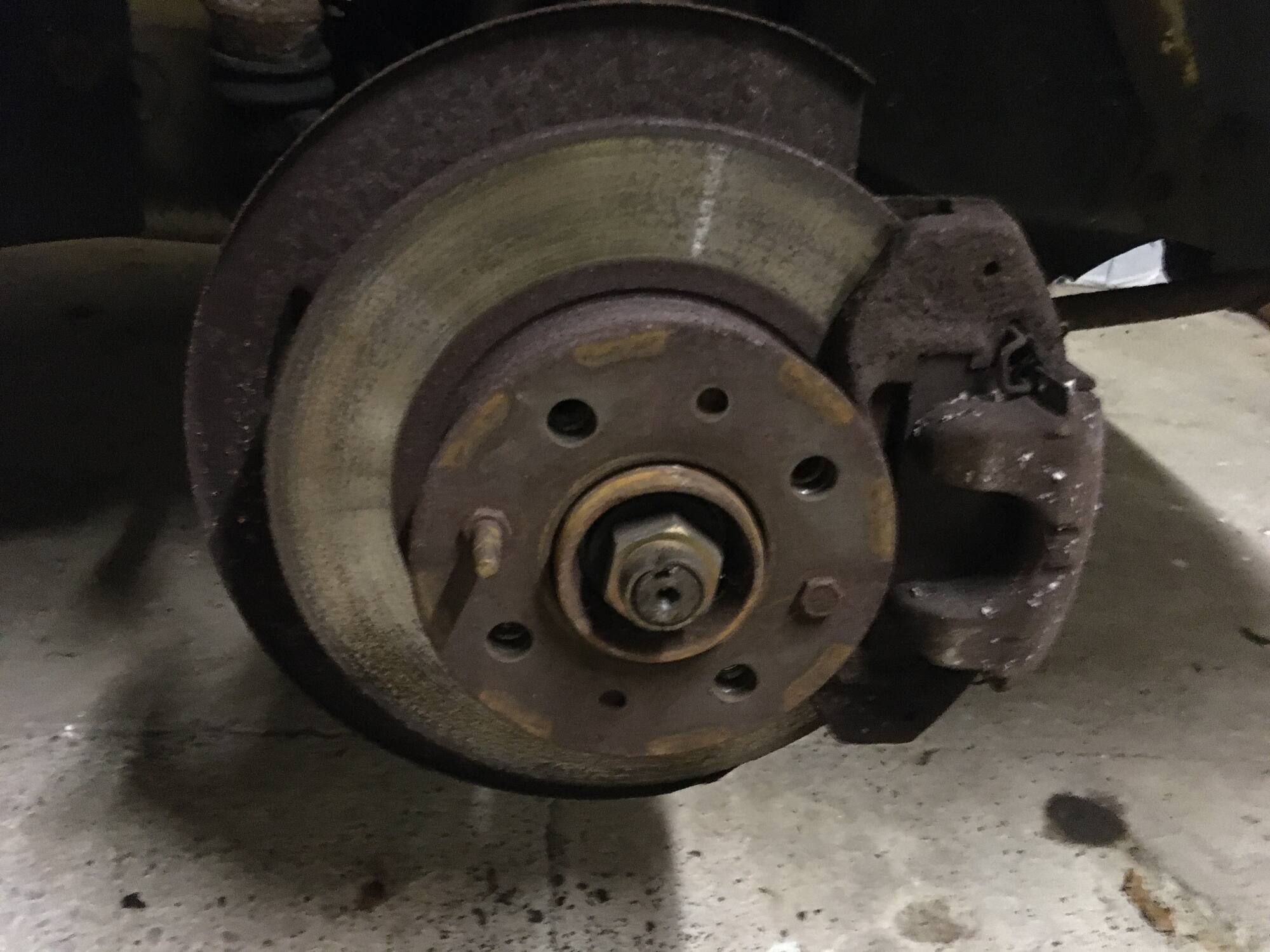

So as I had half an hour it was... wheel of to inspect the callipers...

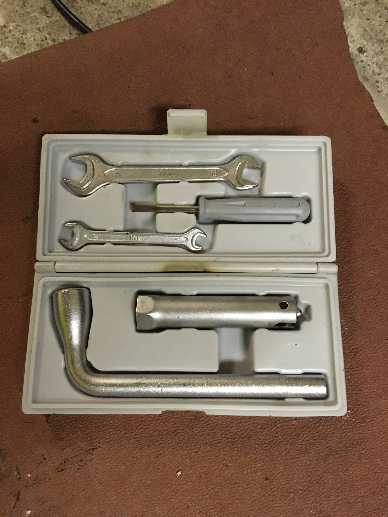

 Thankfully mine came with it’s original Yugo toolkit!

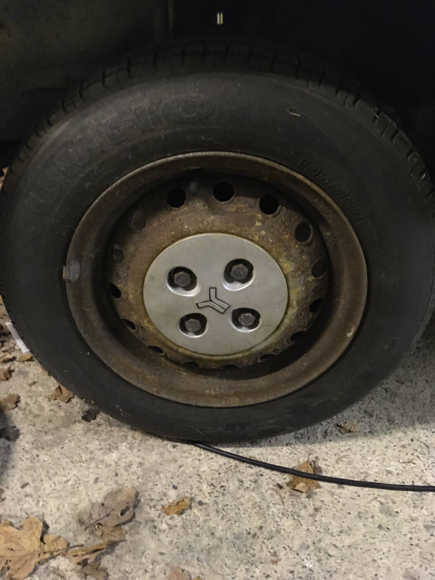

Crusty as anything. No movement when depressing the pedal and the wheel is not moving very freely. Other side is up against the wall. The plan was (now it runs....) to turn it round so the front wheels were accessible... however as the car had other ideas today and wouldn’t run I couldn’t do this. And asking my pregnant wife to help lift the car might not be the best idea...

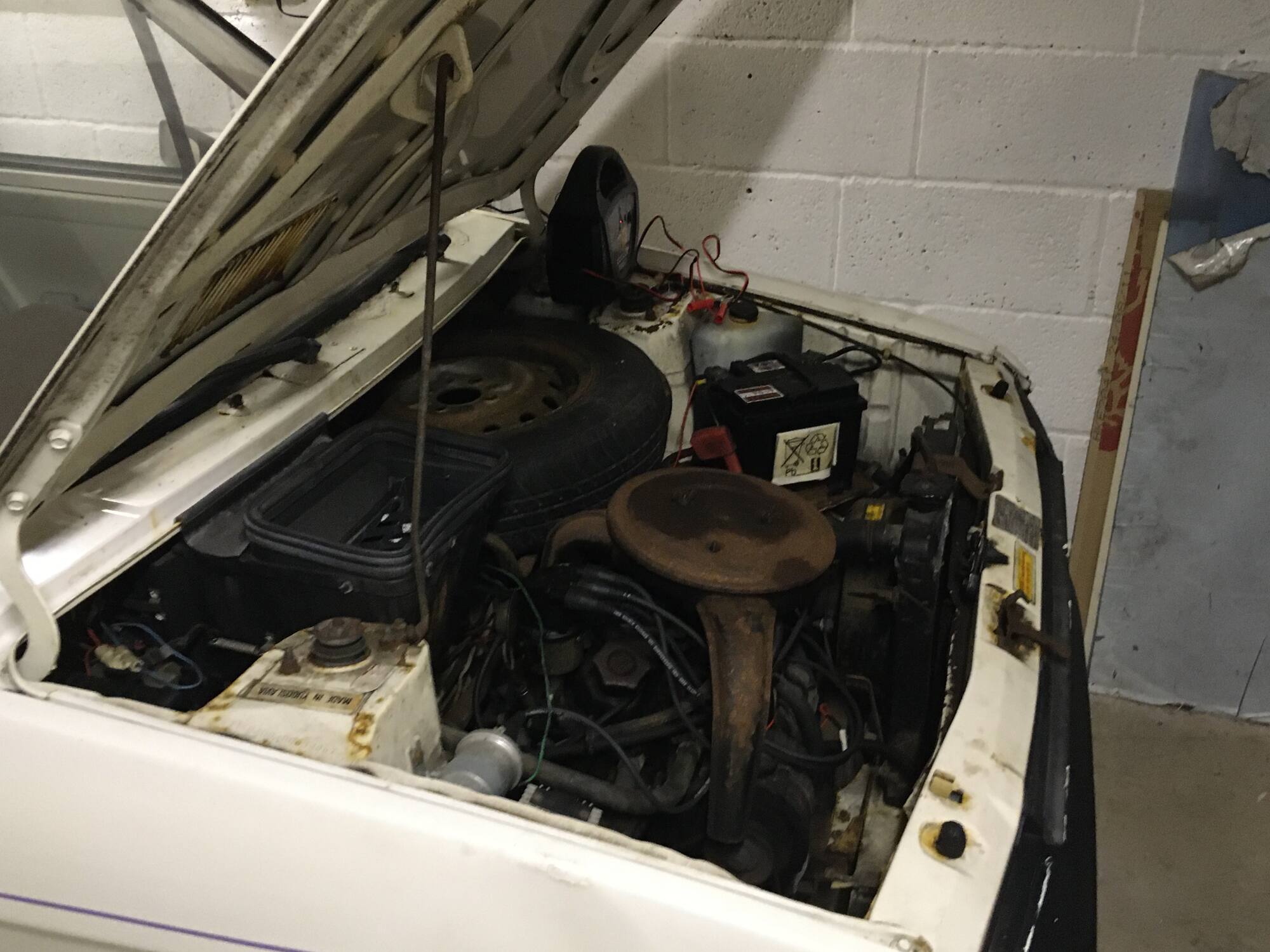

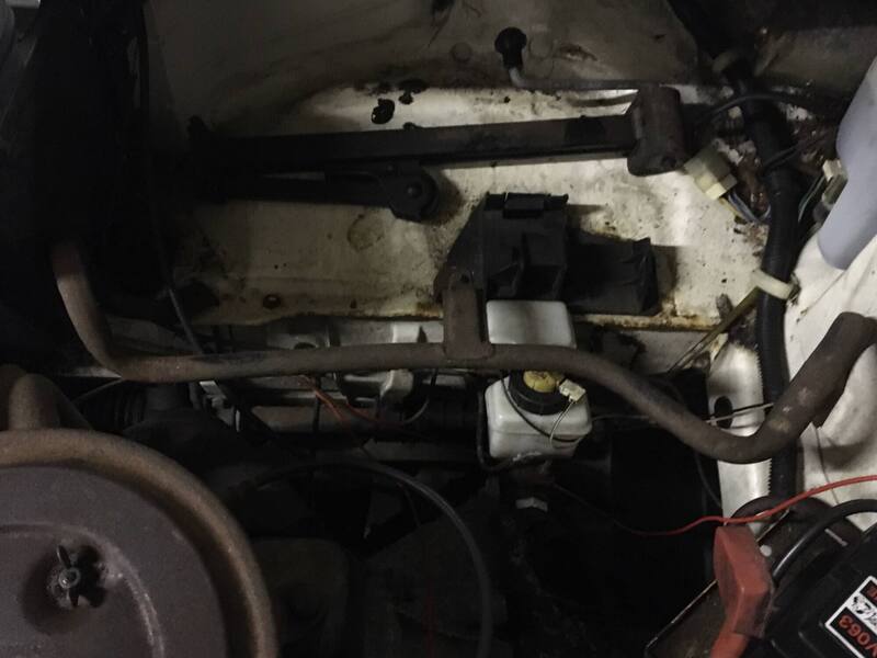

What a brilliant design the brake fluid reservoir is under the spare wheel holder!
With that removed it’s clear that there’s not much brake fluid there! So more fluid might help, but what’s in there looks clear. Don’t think that’s right. Probably best bleeding the system methinks.
Need to look up how to bleed brakes. Not done that before.

Brakes are standard small Fiat,  piss easy to rebuild/ repair. A strip/ clean will free them back up. I’d fit new flexi’s & pads whilst in there.

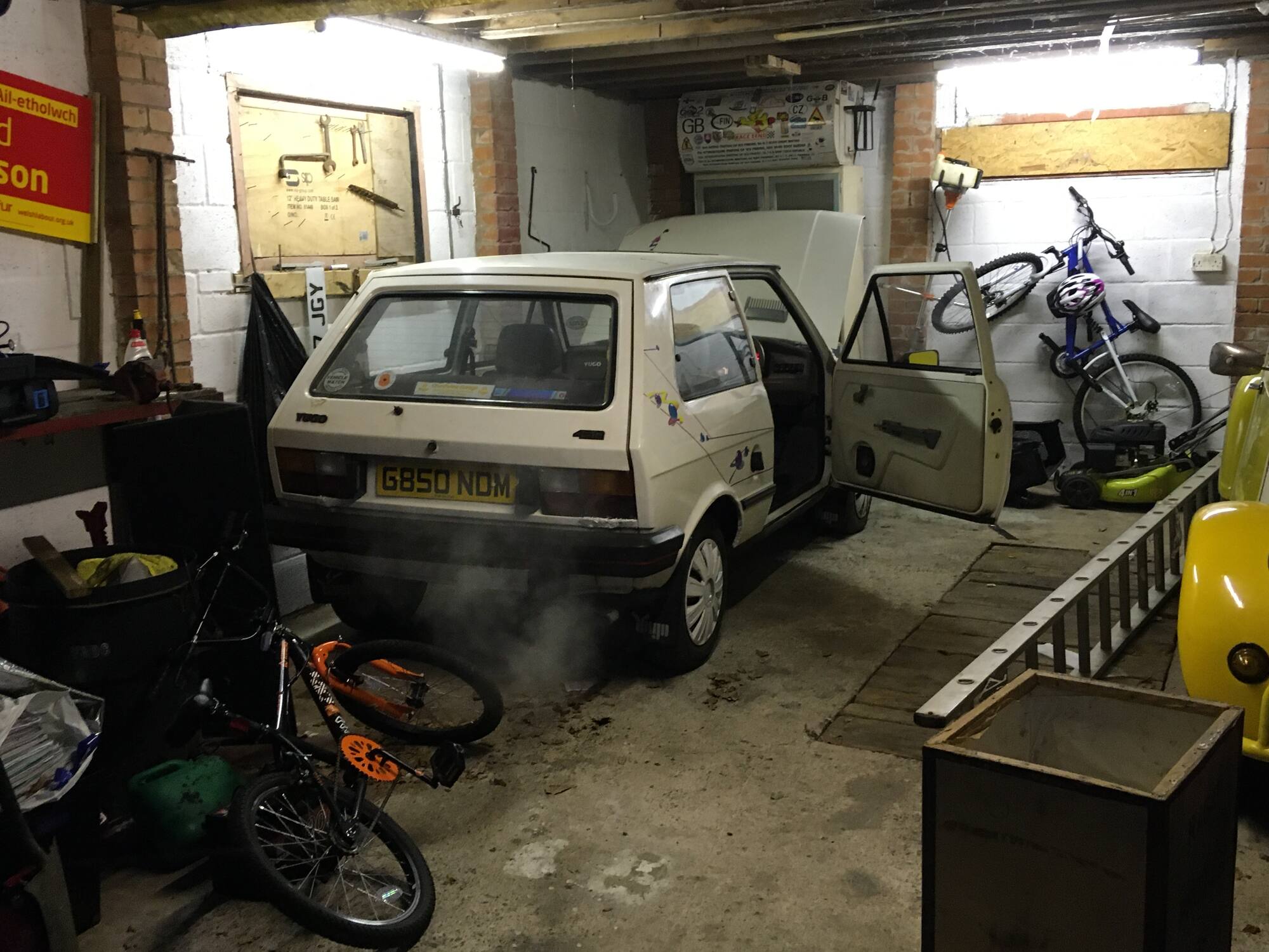

As hinted in the news 24 thread someone came out of self isolation today...

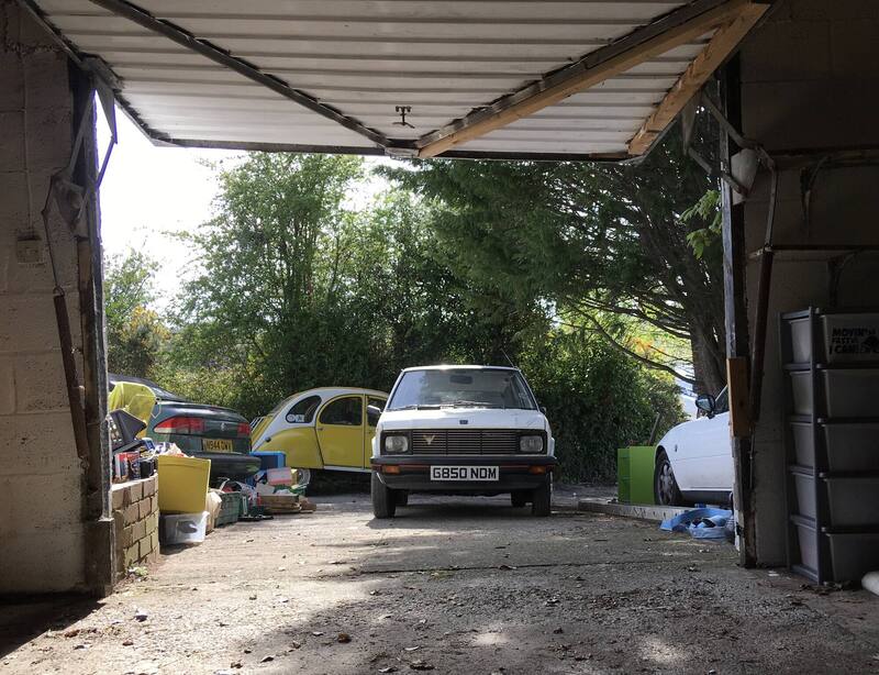

For the first time in probably three years the Yugo left the garage under its own steam!!

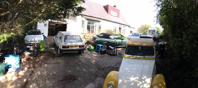

 What was the occasion? Well my garage is a mess... and it needed a proper sort out. So that’s what I did.
 My driveway did look like some kind of jumble sale today!
So what did I learn about the Yugo today.
1. The brakes do work!! Having been told that the brakes were completely inoperative I hadn’t really tested them since the day I got it. My foot goes flat to the floor and if I push really really hard I do get enough stopping power to stop the car whilst reversing down the slope of my drive. It couldn’t be as easy as bleeding the brakes could it? I doubt it, but we’ll find out.
2. The throttle sticks. This was more a confirmation. Push the throttle and you have to pull it back with your foot.
3. Putting it back into daylight made me realise just how bad the filler/rust work is. Do I do bodywork repair or do I leave the filler as ‘patina’
4. It’s a handsome little devil
 Having it outside I was able to leave it running for longer than usual and it was good to see that it gets up to temperature as I’d not had the chance to see that before.
Tomorrow I plan to give it a good wash, and then put it over the pit to have a proper poke at the underside. Then put it back in the garage backwards to have better access to the front brakes and to make it easier to move it in and out of the garage.
Then: bleed the brakes, strip and clean the callipers, then start changing service items, under seal (if it’s OK under there) and decide on what to do with the bodywork.
