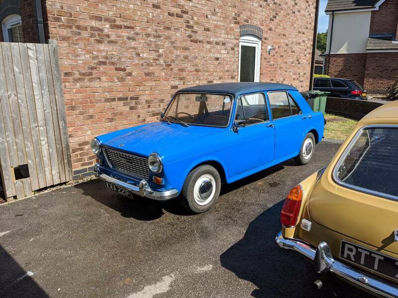

After that cleaned up i dug into the roof. The cracking originates on the factory paint so the damage is very deep. Back to Bare metal then? Err no. That requires the expenditure of more money and thats just not happening. Its getting what ive got and thats it,
I had however overlooked one thing. And that was to check the paint was still okay. Sure enough it was an unopened tin. Score!
Wasnt the colour of the car tho! Ahh well on it goes,  Two coats of coach enamel slapped on with a far too small brush. Flatted back to get some of the dust its awful wobbly and you can still see the cracks i couldnt be arse to dig down too.  but it sort lf matches the look of the car, i pressed in on the edges to give a bit of a worn look, a bit improvement for little cost, just time mostly.

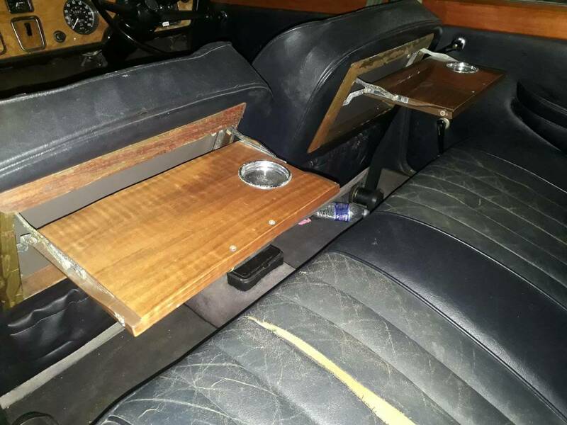

Does it have picnic tables?
I've found old fashioned t-cut brilliant for polishing up flat cellulose paint. Bought up my MGB GT paint a right treat. Then Collinite 476 to provide a wax protection. Don't use too much though as you'll be there forever buffing it! However I haven't done it since (did it a few years ago now) and still looks good.
For the roof, what about a vinyl top? I thought it looked pretty decent on mine. (I still really miss that car!)
If you ever think about selling your VP, please let me know! I can never get enough of ADO16s.

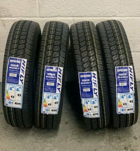

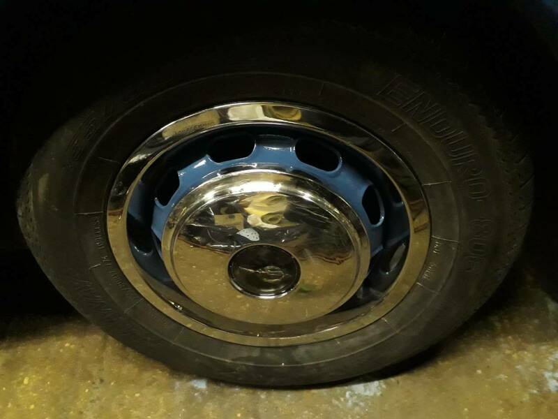

With the 3 tyres being old and one very old heavily cracked. New boots were on the cards anyways. Some 155 80 12s were ordered, hifly super2000s at £116 for 4.

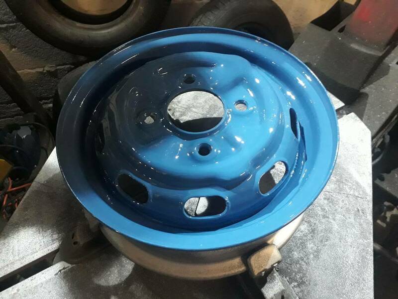

The wheels were an almost purple, deep blue and rather scruffy. A quick knotwheel back. Zinc primer and a thick coat of the same coach enamel went on.
Ring and cap polished up a an old tyre lobbed on for a test to see how it looked.
Its not a shade of blue id choose but like the roof , its a big improvement for no dosh.
All five wheels have now been painted and new boots will go on this week.

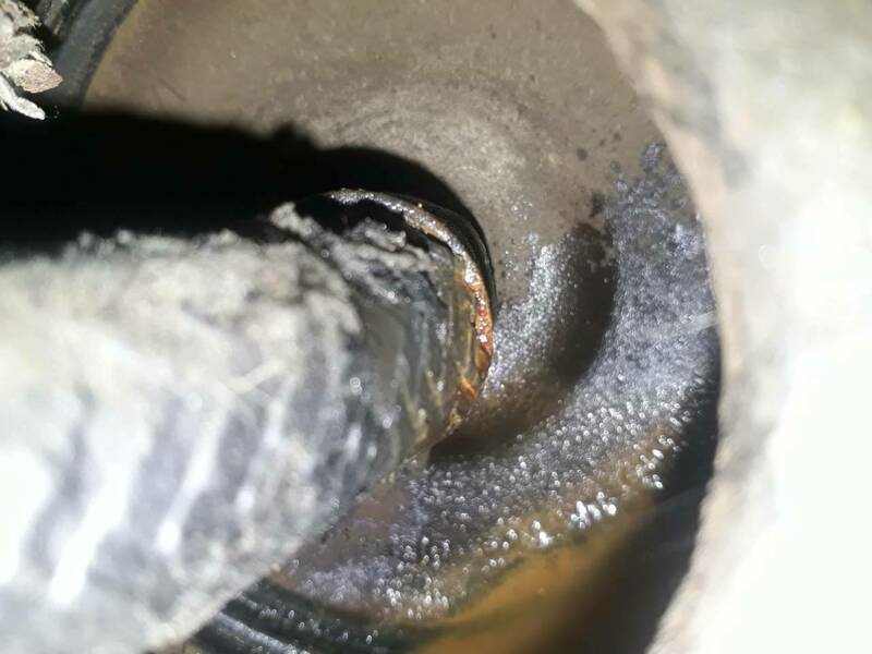

With the wheels off i stuff the tyre inflator on and pumped up the dropped side. As much as it could (100psi ish) and i looked for leaks , i expected/hoped it would be a rusted hardline pipe but sadly its the flexi to the rear displacer.  Bugger!

Tyres all fitted up now,  still awaiting the fluid pump to arrive. So its now time to tackle the displacers.
Having spoke to the very plesant lady from hahs ltd yesterday it seems they are happy to do the repair same day. So tuesday im going to jump in the steed and take a jolly to telford. Drop the displacer or maybe two in and go see what i can explore in the area. Why not make a day of it.
While its pricey (relative to the value of the car) and im sure there are cheaper alternatives if you do this and that etc etc.  A fast and proven repair is my prefered option.
I don't think you can go wrong with them tbh. Given the original hoses have lasted 50 years or so, these rehosed units will probably outlast most of us. The displacers themselves don't seem to really degrade either.

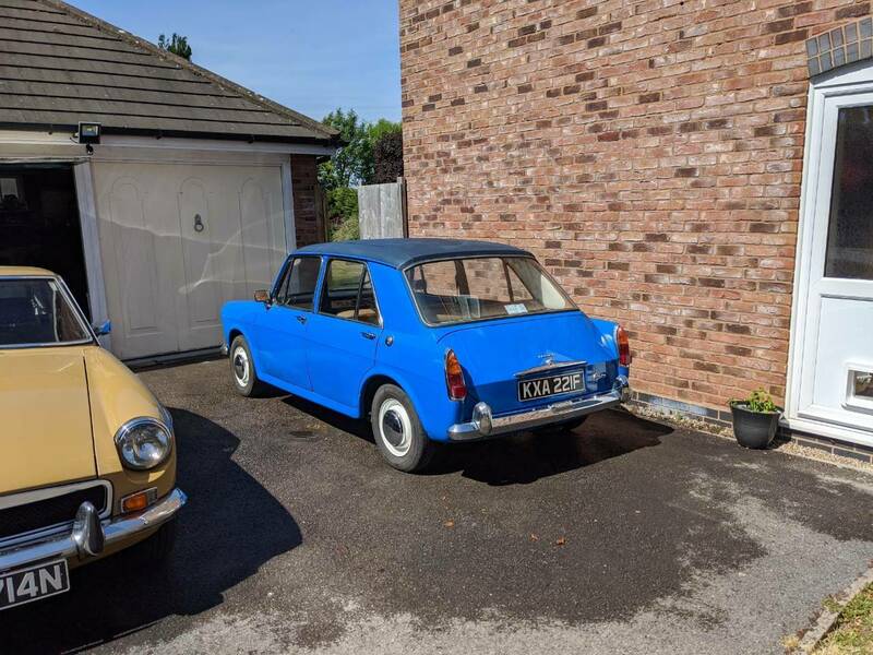

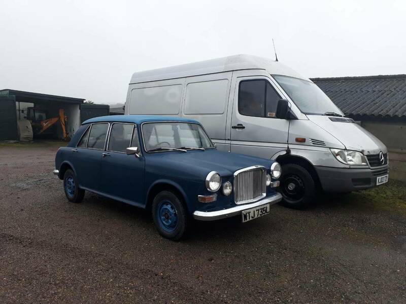

Bit of a shuffle around the workshop see these to fine automotive marvels parked up next two each other. Vp now pumped up and at correct height according to my new (to me) very handy factory looking manual.
Manual came with some extra paperwork from the 80s
I'm not sure about the blue wheels (grey or white with chrome caps probably work better?) but that looks ace.
How do you find the auto box? Very moaned about and I need to try/buy an A-Series with one to see if they're as bad as people moan about them.

Agreed the full blue wheels look a bit shite, with the trim rings and caps on they look alot better. The blue is not a colour i would have choosen to buy but its what i had so on it went. I initially fancied painting them a metallic copper orange, but that required expenditure.
The autobox is a bit pony, not happy untill warm as the engine oil is probably too thick so its a bit hit and miss at first. Once warmed up it changes smoothly it is very short geared normal driving. Up to 3rd around 25mph.
Press on and its okay. Very Revvy at 50 ish. Engine mounts are tired and theres a drone from the exhaust which i ill fix to make things a bit smoother.
Overall its a charming little scruff bag.

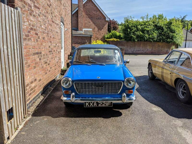

Here a a few pic the previous owner sent me (they lived in central london) which further tap into that vibe…
needs over riders to distinguish it from the hoy polloy🤣

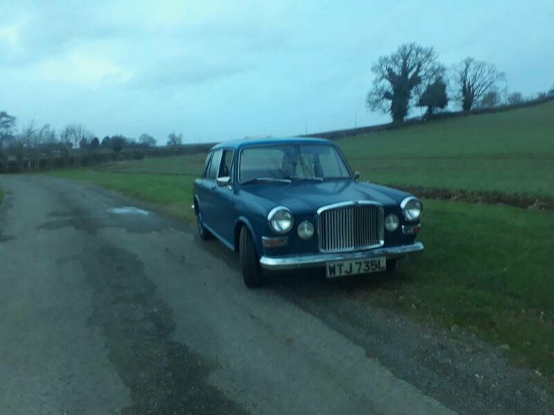

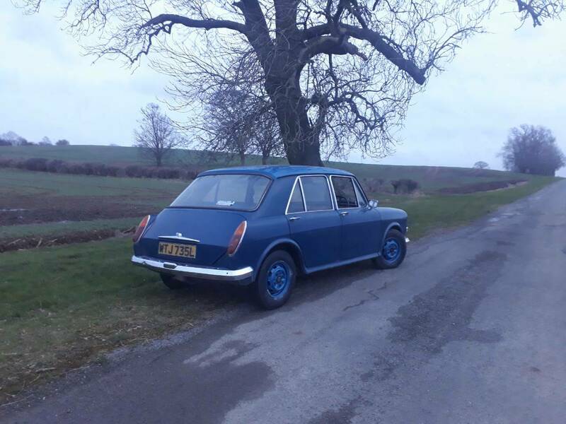

Out today dodging the occasional flooded road.  Think im approaching maybe 350 ish miles since it was fixed.  Its just been a good egg really.
  • Like 11
Looks lovely, a blue bmc 1100/1300 in the countryside always reminds me of….
