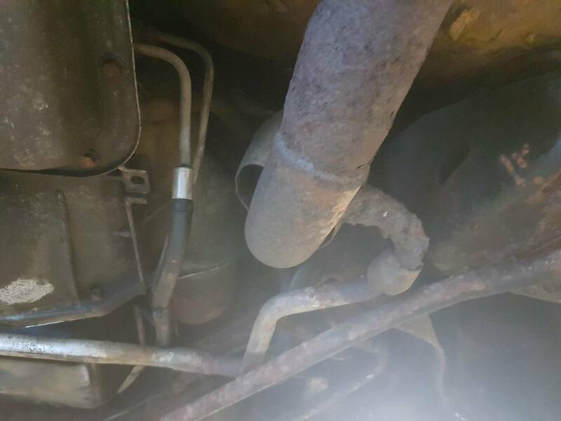

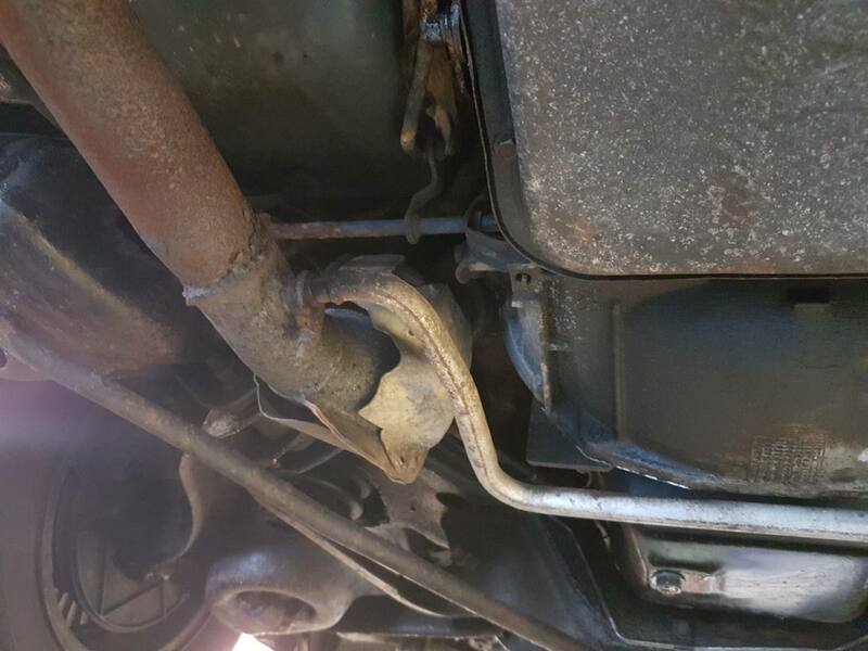

On the subject of vehicular improvements, i paid a visit to the local longlife exhaust centre just outside bristol
Which housed some tasty treats
The cat crossover pipe and the right exhaust are very much past their best and are in need desperate need of replacement
Most of the system is longlife already so it makes sense to replace the rest as such. I've been given a price of £300 if they delete both cats and add two silencers instead or £600 which will include two brand new custom made cats.
I'm undecided of which route to go down. Much pondering to be done and will happily receive advice from more knowledgeable members.
Will it pass MOT without ?
You could always get them to make it without BUT have that section removable (incase you want to fit them later on)
