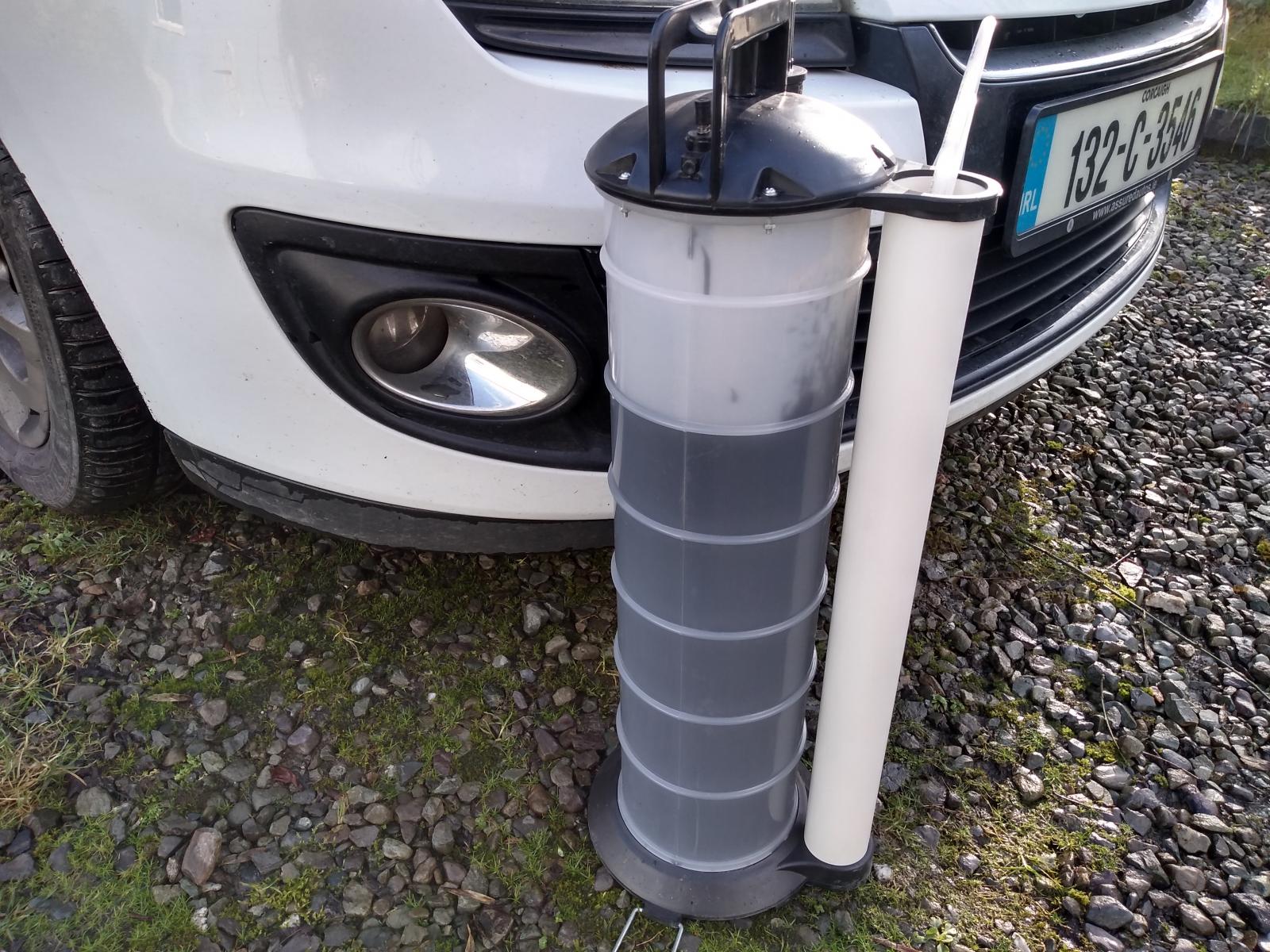

Well, it's worth a try.My Chinese style vacuum sucker just arrived.£25 on eBay.Will let you know of any disasters.

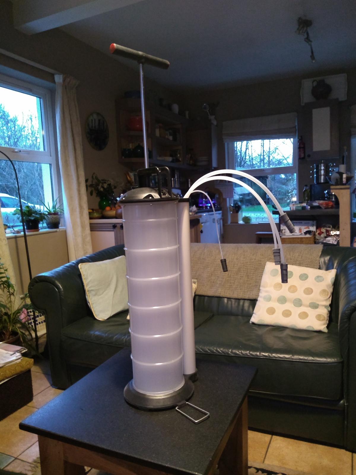

I pumped it a few times in the living room,my wife thought it was the dog having a terminal style coughing/choking fit.

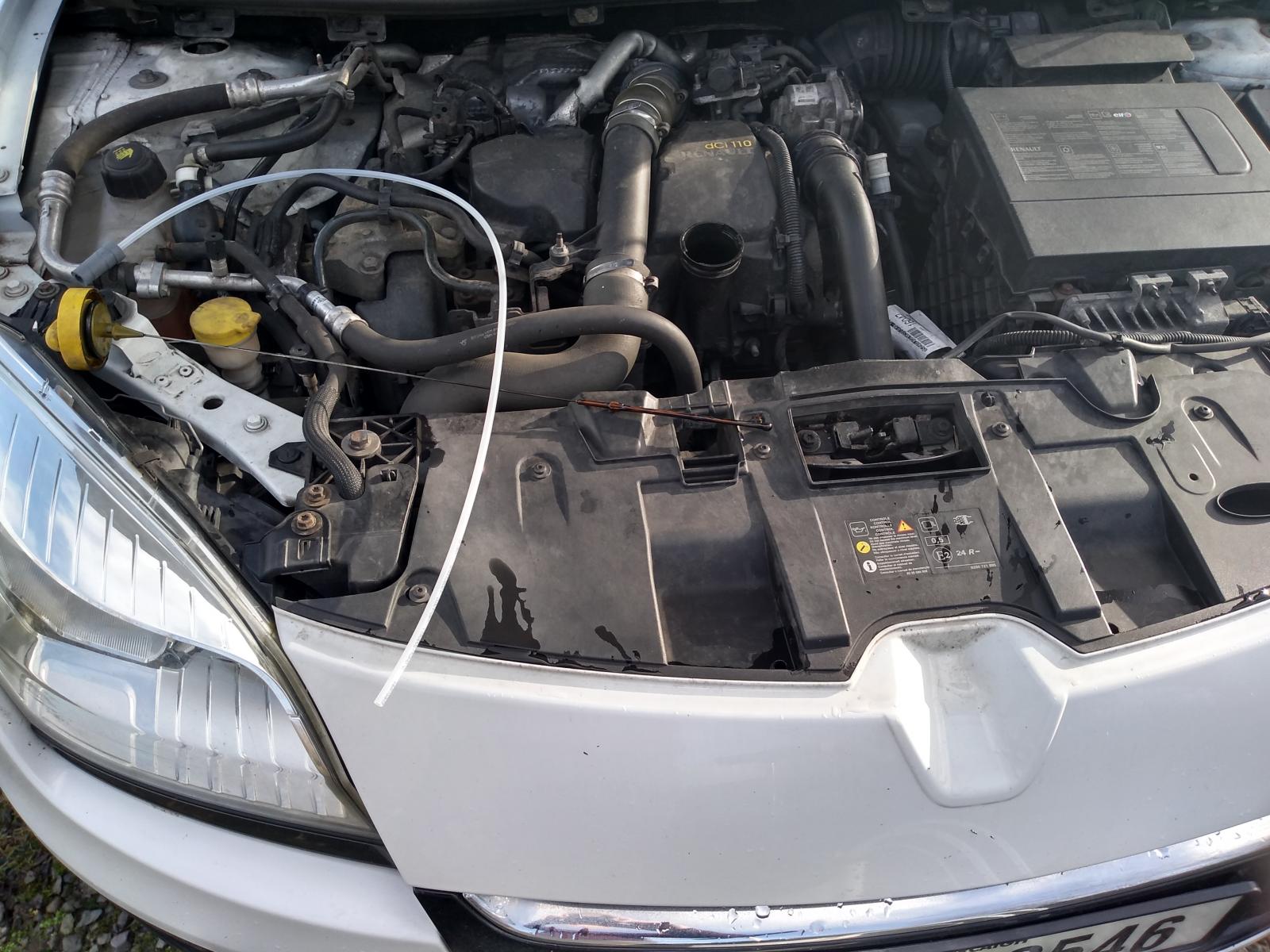

I had a spare hour today,so I tried the cheap oil extractor out on my wife's Meganepost-19075-0-63575700-1548509151_thumb.jpg
As you can see,the suction tube is longer than the dipstick,so has enough length to reach the bottom of the sump.

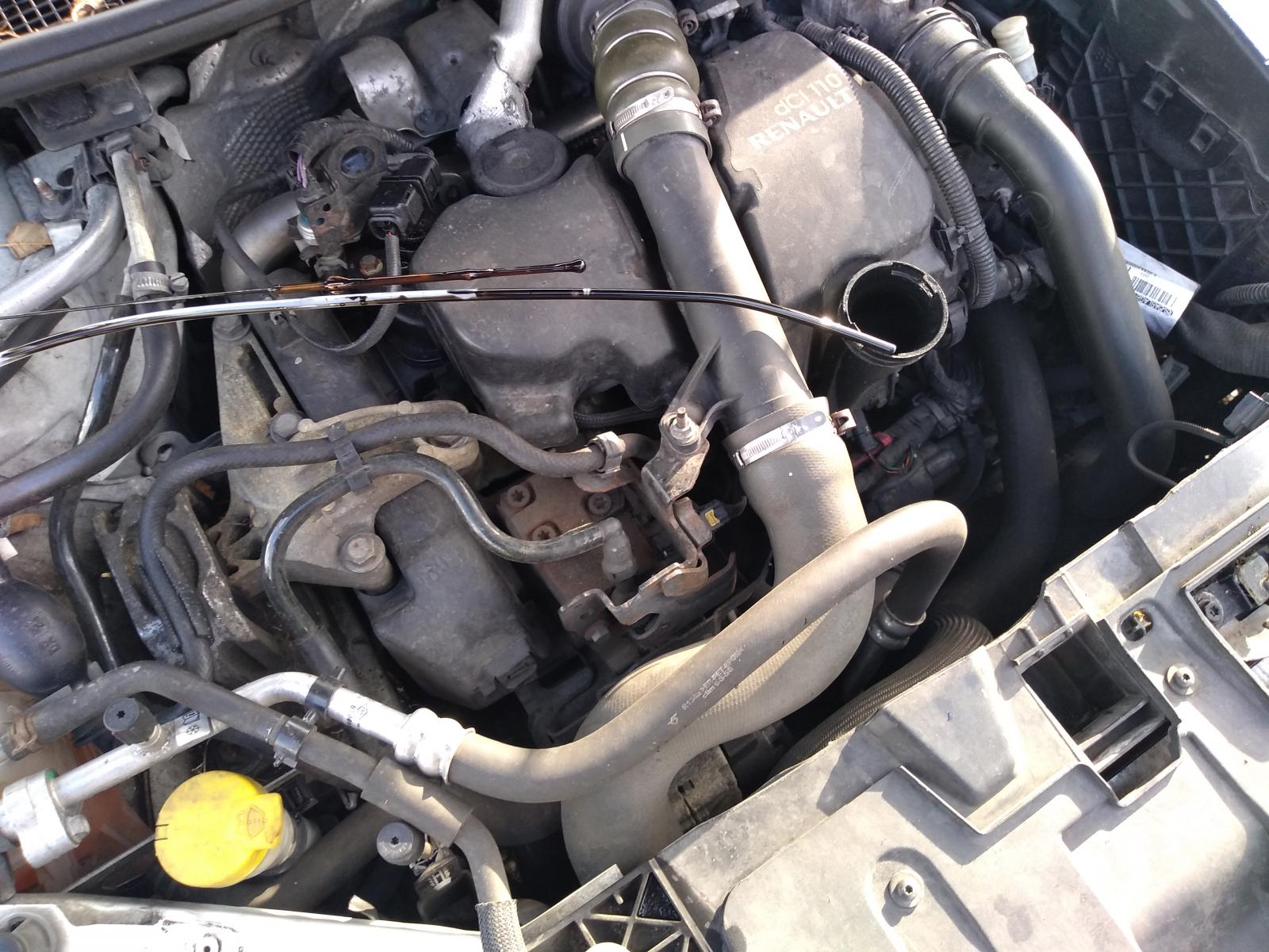

I pulled the tube back out and compared it with the full mark on the dipstick.The tube obviously reaches much further down.

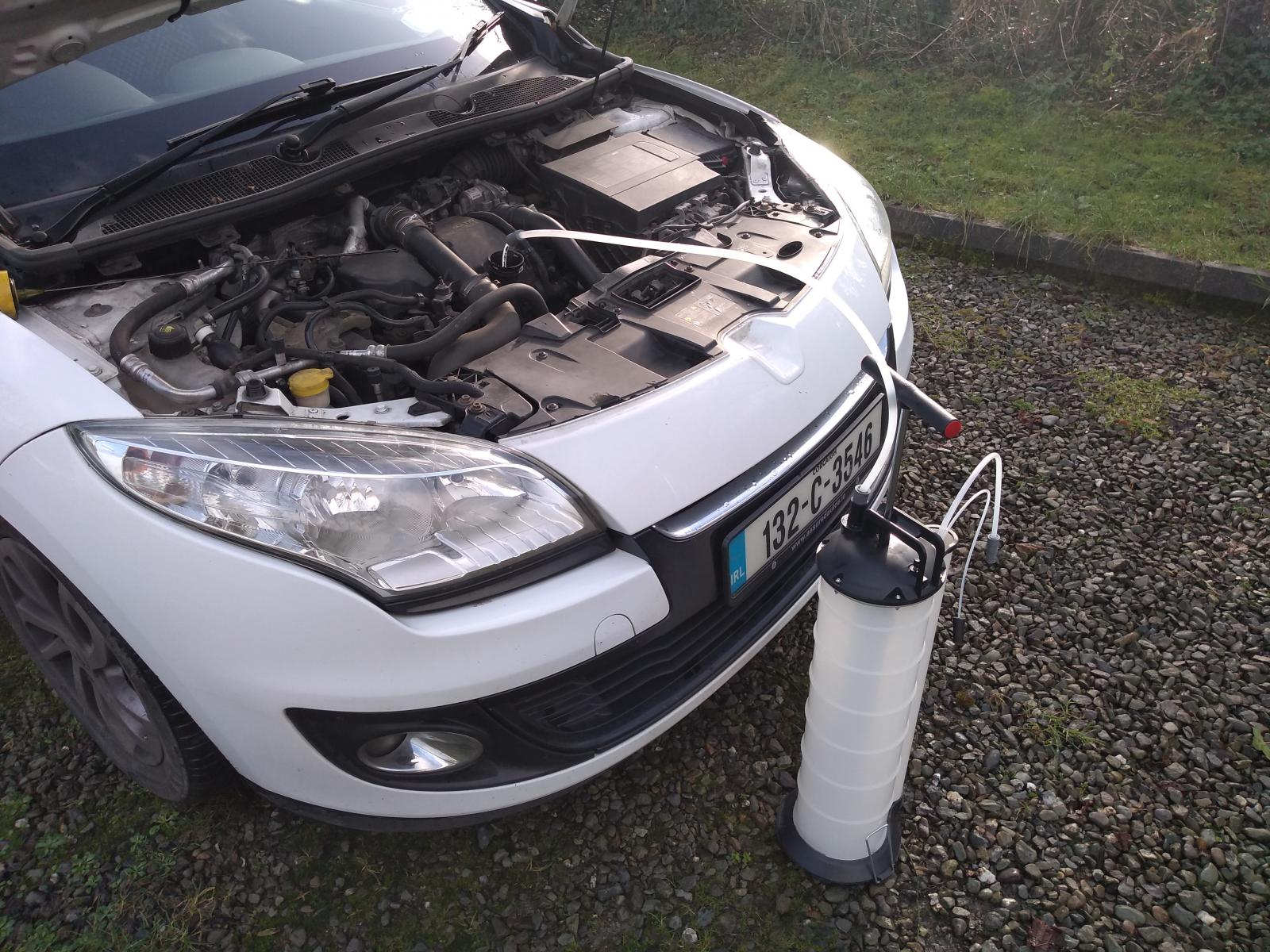

Here it is all ready to go,with the main suction tube pushed into the rubber fitting on the tube into the sump,and the other end connected to the vacuum tank.You have to be careful not to push the suction tube too hard when inserting it into the sump, especially when using the thinnest tube,as there is a danger of it bending into a U,and therefore sucking from above the bottom of the sump,leaving oil in.

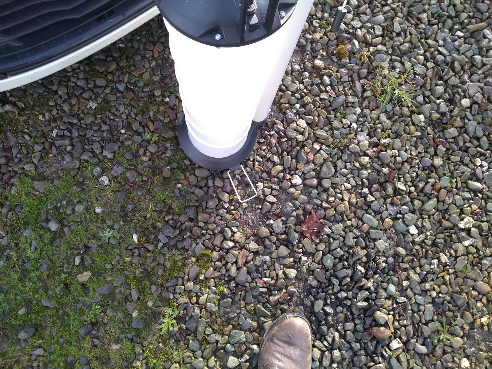

Then pump away.The metal stirrup on the tank base can be stood on while pumping.
I found I had to top up the vacuum a few times, especially as I hadn't pushed some of the fittings together hard enough.
It stopped sucking at about 4.8 litres.As I knew that this car definitely takes 5 litres I withdrew the pipe and reinserted it until I just felt resistance,then applied vacuum again.As you see above it then sucked out the last 0.2 of a litre.
So it does it's job properly,though I would prefer to use it only if I know how much oil should come out.Then some manipulation of the suction tube will mean that I can be sure all the old stuff is removed.
