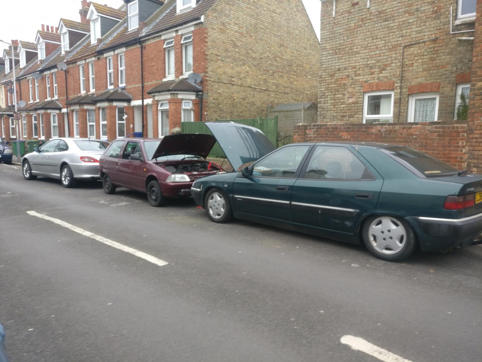

robinmasters Posted January 5, 2019 Author Posted January 5, 2019 And then... GrumpiusMaximus, rantingYoof, Joey spud and 16 others 19
robinmasters Posted January 5, 2019 Author Posted January 5, 2019 It was the battery. My thinking was that the other car's battery was doing the work, so a knackered battery wouldn't so the dead car being jumped. I haz learned a lesson today. It fired up straight away on the tiny AX battery. I was busy outside messing admit with it so didn't see the sale code, but ECP was open and provided a fresh battery, and Stuart's now on his way on the first leg of the Xantia's trip to it's new home. Rave, dozeydustman, GrumpiusMaximus and 11 others 14
Jim Bell Posted January 5, 2019 Posted January 5, 2019 Jumping it off an AX. Quality. Datsuncog, dozeydustman, Cavcraft and 5 others 8
