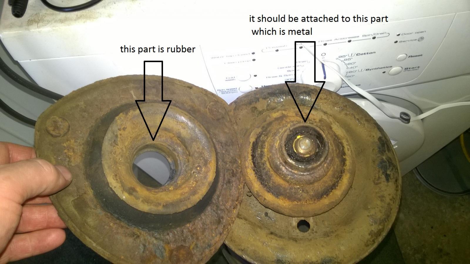

I'm changing an ABS ring on my OH's Tucson, I went to put the driveshaft back and noticed the strut was hanging down. It looks like the top mount has come apart. I can't see anything else that could hold it together but glue and luck. Are these mounts normally bonded? New ones aren't expensive but I really could do with getting it back on the road sooner rather than later. Could I bond it with something? I'm worried if I get this wrong it could pop out when the suspension is unloaded
The 'rubber' is baked and just bonds to the metal. They're all shite nowadays and last a year. Astra mk3 ones are terrible, but I've never had one go, I don't think it's possible to have any thing bad happen as only the suspension shock absorber mounts to it.

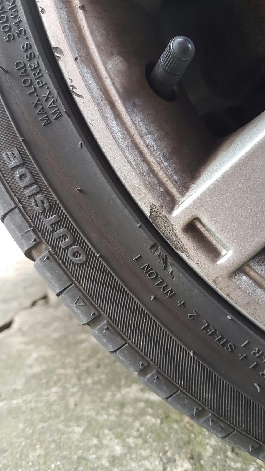

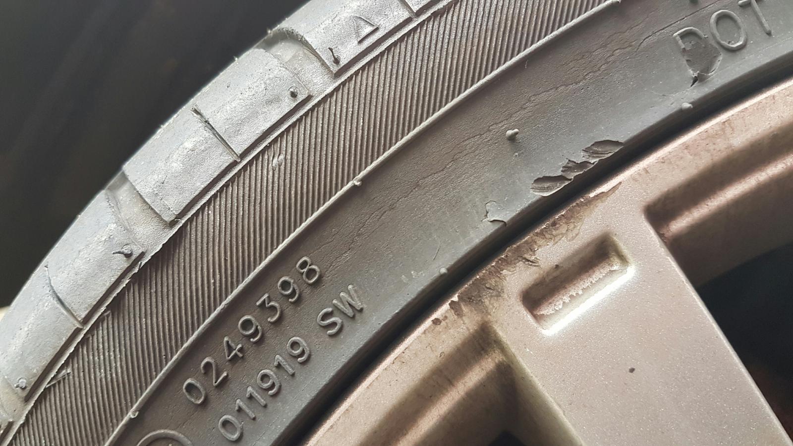

Is this tyre now buggered?
Looks like that all the way round. Mrs Shrimp drove it with 13psi in.
If I bought the car that tyre was attached to, I wouldnt even give it a second thought. I probably wouldnt even notice it. Therefor I say crack on. Your mileage may (quite literally) vary.
Guest Hooli
I think it's legal unless you can see the cord so I'd say it's fine.
Still slap Mrs Shrimp with a kipper mind.
By the way, I am talking about the wiggly line around the circumference, not the wee missing chunks which are nothing at all and not worth worrying about.
Guest Hooli
I hadn't even noticed that!
Only way to know is take it off & check the inside I'd say. I had a tyre die on the goona due to a pothole bending the chocolate wheels. It looked fine outside but half the rubber inside the tyre was rolling round loose as dust.
