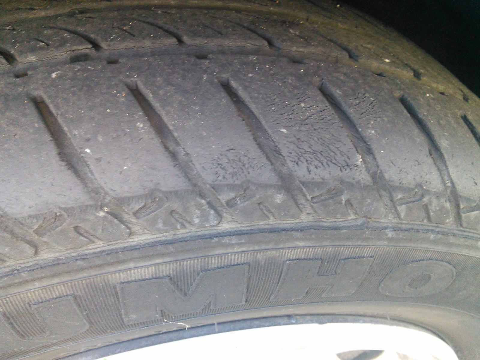

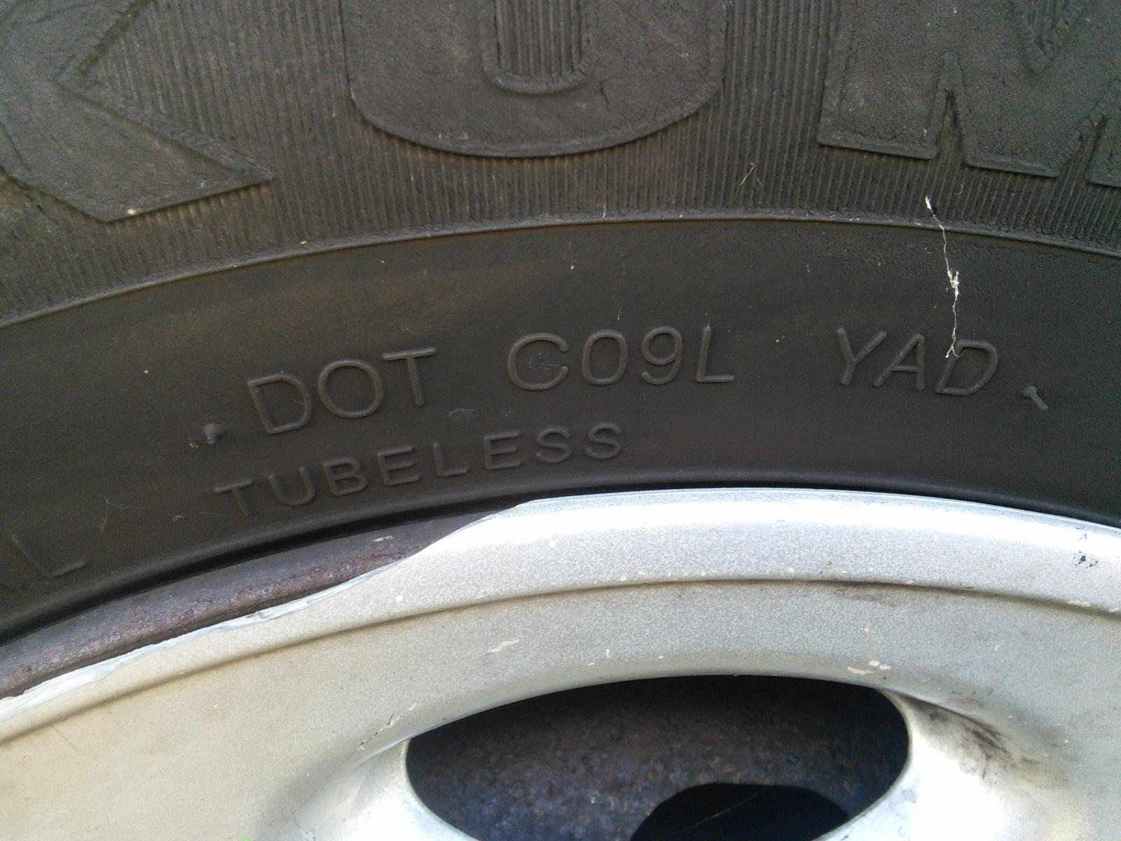

further investigation suggests the dates might have been printed on the inside? Similar Kumho powershift on the rear is 2008.
Change the front one on the Mondeo anyway before winter for new ditchfinder?
Tyre dates are usually only on one sidewall. Kumho are a good tyre at the price for me, I've had loads down the years.
