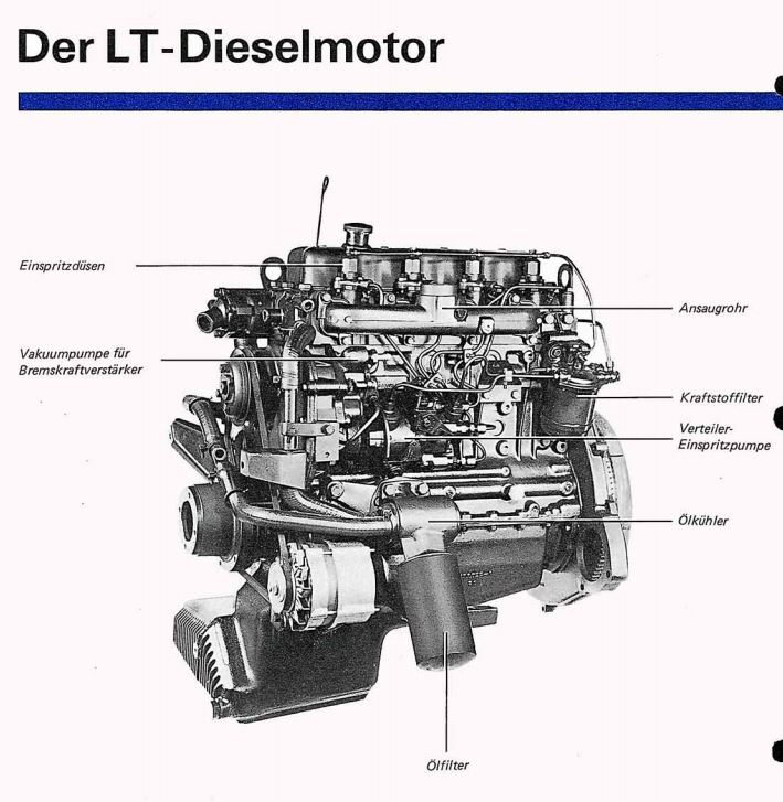

Anyone here had dealings with the VW LT which had a Perkins engine for its first year? Any info would be of interest.
Who is it that sells the autoshite dealer stickers ? My new chariot has both a soft top and a hard top so plenty o' stickers are needed :)
No dealings, but as a longtime LT fancier I found these docs. some time ago. How's your German?
PDF introduction to the engine here http://www.volkspage.net/technik/ssp/ssp/SSP_12.PDF
and to the LT here http://www.volkspage.net/technik/ssp/ssp/SSP_10.PDF
^^ Thanks for the link, looking at the engine I'm even more puzzled why it got canned it so quickly and substituted by a six cylinder version of the Golf diesel. I understand that the '4' cylinder 2.7 was produced in Hanover under licence from Perkins but Germans reckon that it was shit and thus the 2.4 6 soon replaced it. I'm thinking that it was more a case of NIH; this series of Perkins engines were, I think, a joint venture with Japan and in my experience performed very well. Meanwhile few people have a good word for the thirsty 6 so arseholes to VW.
