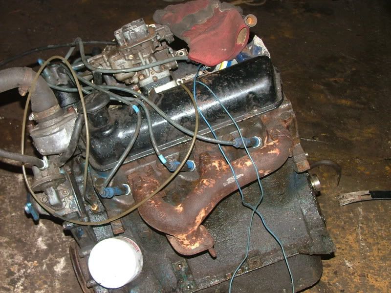

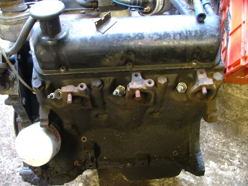

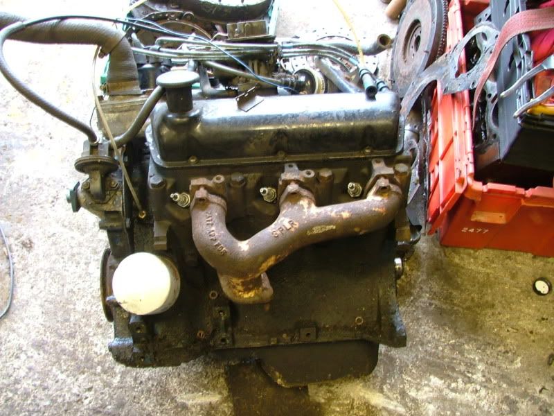

im having trouble removed the siezed bolts of out this essex manifold
any (relevant and useful) tips?
Stage 1: remove heads from bolts with cold chisel/grinder/file/laser
Stage 2: remove manifold
Stage three remove remnants of bolts

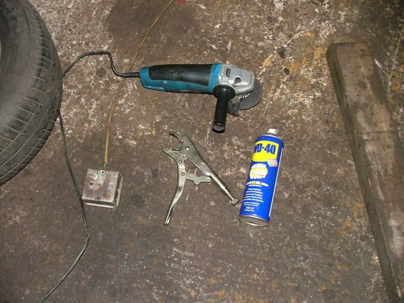

i used these:
Result!
sometimes spanners just aren't enough :?
I take it that once the manifold was off the remains of the bolts realised the game was up and surrendered quietly?

A drill chuck can make a good alternative to stud extractors (remove it from the drill first obviously) especially if a stilson is applied.
yes, a quick spray of the threads with wd40, a tap with a mash hammer and then molegrips had them moving straight away
