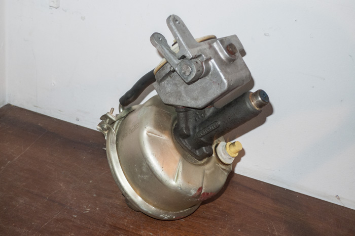

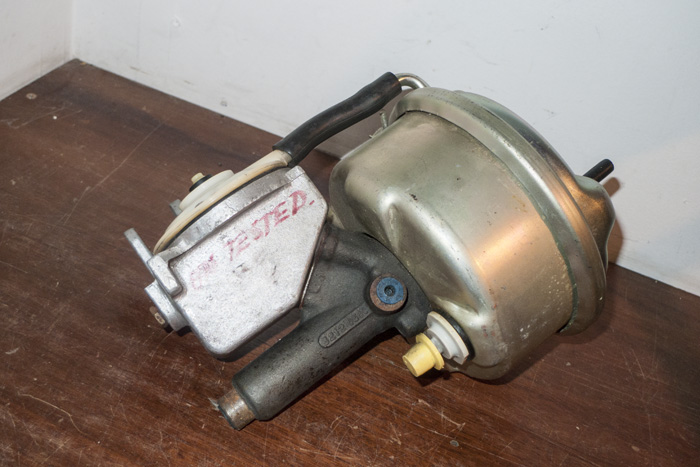

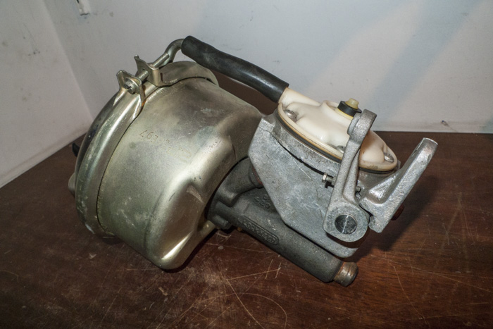

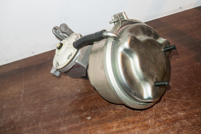

Any Fiat 127 Experts on here?
Do they use a Lockheed remote servo on any version? If so does it look like this?
If not Can anyone Identify the above servo, I've never seen one with the extra bracket on it before.
