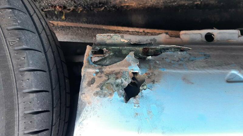

Now back on the drive and dropped the transit off for a front spring and MOT which will be done next week.
Spent over a month considering doing the spring at home and couldn't work up the enthusiasm so I'll let them do it..
Mmmm, camper conversion project in doubt...
A price being put together..
Still waiting for a call from the garage with a price to
a) patch it up to get it through an MOT
b) do a proper job, replace the sills, step etc.
Expect the cost of labour going to put either into the not viable category.
Any crazy sparkly stick wranglers want to volunteer for beer tokens & lols if I do the prep?
Thought not!

So, garage quoted 2 days labour to patch it up to MOT standard.
Found someone else who will cut out and replace inner and outer sills and do a few other bits for less so it's going off to him at some point.
In the meantime I'll deal with the other failure points  today's fun and games replace a front spring, track rod end and arb bush. Went out at lunchtime and sprayed everything with plusgas and started freeing off bolts, came out after work and  finished it off, only sticking points were undoing the top nut as my cheapo mains  ugga dugga seems to have destroyed its gearbox and getting to the 3 bolts at the top of the strut as they are behind the dashboard. Had to cut off the droplink but ordered new ones anyway..
No pics as forget/raining/twitch about doing a spring, good news still got ally fingers, head, balls etc.
If it's going to be a camper, definitely get those sills lopped off and replaced with new panels, making sure they get properly primed inside and out and stuffed full of cavity wax until it drips out of the seams.   A patch might only buy you a year.
Might be worth checking all the rest of the chassis as well just to make sure there are no nasty surprises waiting. A good going over with some cavity wax and bar/chain oil or lanoguard or whatever will keep it soldiering along.
Patching up a vehicle to MOT standard = barely acceptable repairs that will last about a month.
It always amuses me when "MOT standard" is quoted.  Essentially it means the bare minimum patch job with zero corrosion protection, crappy welding and a load of splodge walloped over the top of it.  MOT man gives it a poke and it doesn't collapse?  That's a Pass.
Won't be in a couple of years time tho.  It'll be a monumental fail when most of the structure comes away in your hand.
