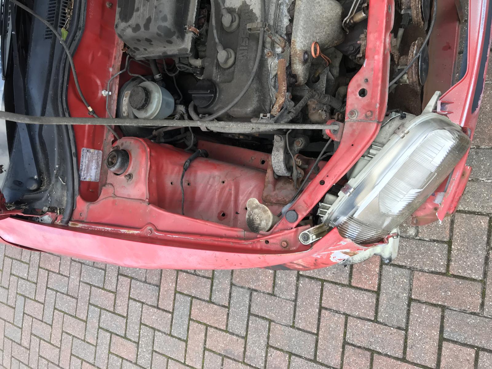

Drivers door has moved back a few mm, and there are ripples in the o/s/f suspension turret. Beyond reasonable repair sadly.

I wish! Sadly it doesn’t drive straight - I think it’s moved the lower wishbone mounts.

A trip to the breakers and a few hours spannering would have that in reasonable condition again.

RIP Micra, actually I had a set of front wings bonnet and front bumper lined up on e bay due to the paint but as you say if the suspension mounts have distorted it’s probably game over. For a k11 that front crossmember looks great!
In my experience of these the wishbone bends before the mount.My friend's son skidded on oil in his and crashed the front wheel into a large boulder, resulting in the front n/s wheel being pushed back an inch.The car made it home 150 miles with everyone thinking it was written off ,but a new wishbone and trackrod and some bodywork tidying saw it live on ,and it's still in daily use over a year later.

The terminal bit - ripples in the inner wing as well as the door having moved.

Those ripples are from the factory pressing.
i don't see anything terminal there,you most likely have a bent wishbone,although it is difficult to tell from the pic.

I concur, perfect cars for rallycross. I don't think the damage is as bad as you claim. My mother had the entire side of her Honda Jazz ripped off by a Transit in a similar fashion and some steering components, two doors and a front wing were enough to get it shipshape again. Plus I don't want to see the lovely little thing die!
Yep just looked around and confirmed this on other K11's but it would still need for only the wishbone to be bent, not it's mountings and then hope that the door is out of alignment because hinges are damaged rather than the bottom of the B-pillar. If all three worked in 83C's favour it'd still be a load of work to replace everything (which someone should absolutely do to save the car anyway of course).
