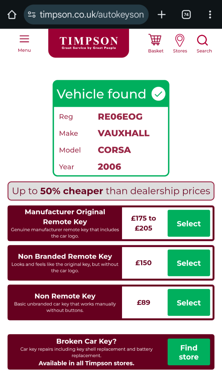

I'm pretty sure Timpsons can do a basic ignition key that will start the car but not do remote central locking. They basically clone the chip from a good key into the new. As far as the ECU is concerned, it's the same key and no rolling codes on the immobiliser.
Yeah here you go. Maybe a lot cheaper from an auto locksmith or even a local independent key shop (most can do car keys now as the margins are good) but it's one easy option at least.
I actually seem to remember vaguely that cheapskate scumbags GM actually only supplied one remote key and one just ignition key back in the day?
Given you have a code for immobiliser not recognising a key, it's probably worth getting another made in case that's on its way out. Or could be that the other key broke and that's why it's missing. Iirc the little glass RF chips were actually removable from the key and could fall out if someone fiddled with it too much.

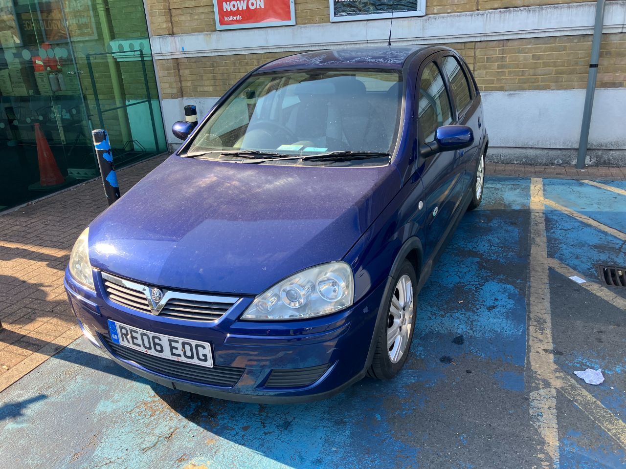

in my brothers Corsa news, we took it to a garage today to get it a bit of a going over, Garage says, exhaust is pretty much shot and everything after the cat will want replacing, but they dont think theres any head gasket issues to worry about (however they did not do a sniff or compression test) so thats a little bit swings n round abouts, still not 100% sure is it really ok or is it going to blow up LOL, but at least the general consensus is still positive and we an idea what will need doing on the exhaust front
they did however mention seeing a puff of white smoke from the exhaust on start up, and although I could not recall seeing anything like that previously, I did get my brother once at home to give the throttle a few blips and on of the blips there was a puff of smoke, but it looked more blue then white to me, but it only "puffed" once out of a few blips, so im trying not to read into that too much LOL
I think the game plan is look at getting a couple tyres fitted, I was reminded part worns are a thing so we will likely go down that route, just to get some half decent rubber on the thing, so we can safely take it for a longer motorway based trip and see how it does :) and if it does not implode/explode/drink-all-its-coolent etc, then we will see about getting the exhaust replaced
the main thing is of course my brother understandably does not want to plow a bunch of money into it, if the engine is suffering from HGF,  in that regard that perished tyre has been a right PITA since its preventing us from actually giving it an Italian tuneup

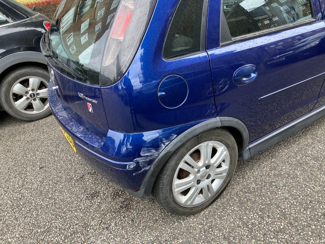

speaking of PITA, almost quite literally, also looks like it picked up a scrape at some point where it looks like someones scraped themselves on the rear quarter? , we are not sure when it happened, checking the photos I have it was not there on the 28th of June, so sometime between now and then! obviously my brother is unhappy about it and trying to work out when/how it happened!

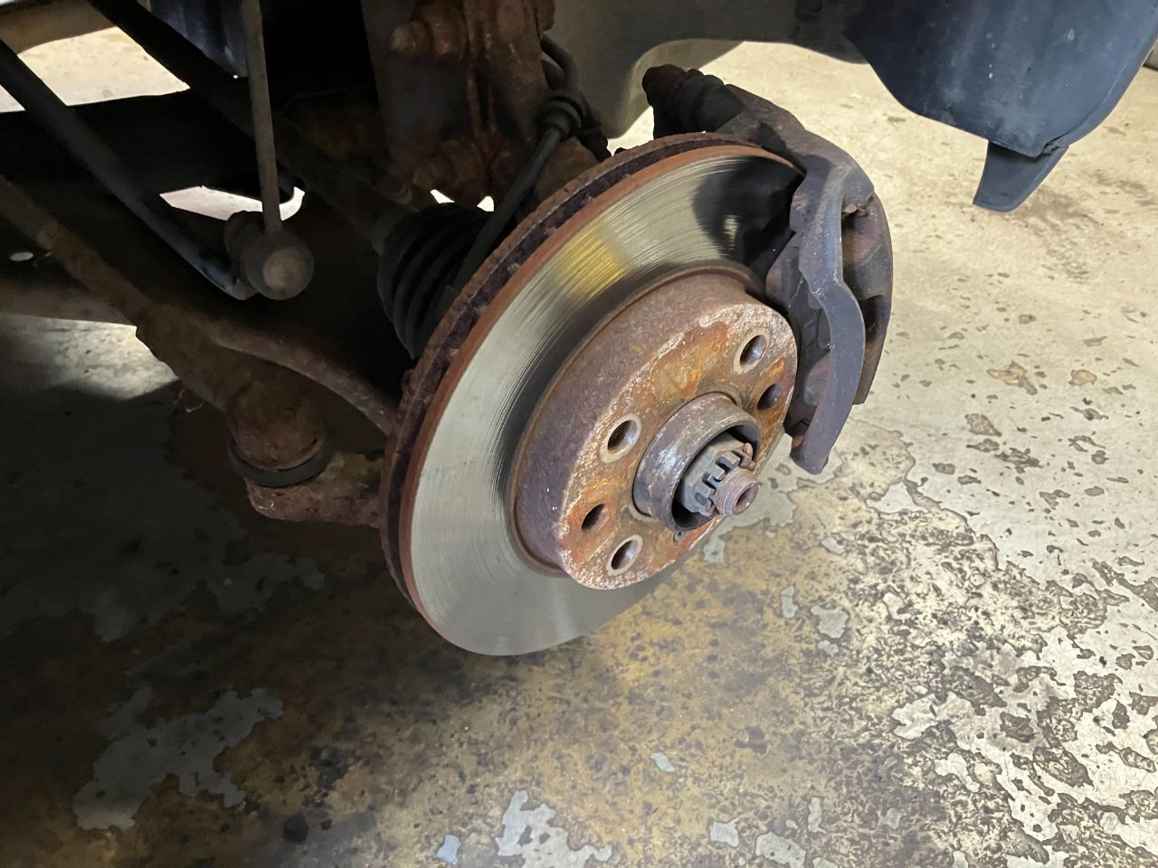

if I am looking at things correctly I think theres a fair amount of meat left on that brake pad?  was not able to get an in depth look I just snuck a quick photo while the tyres where being changed :)

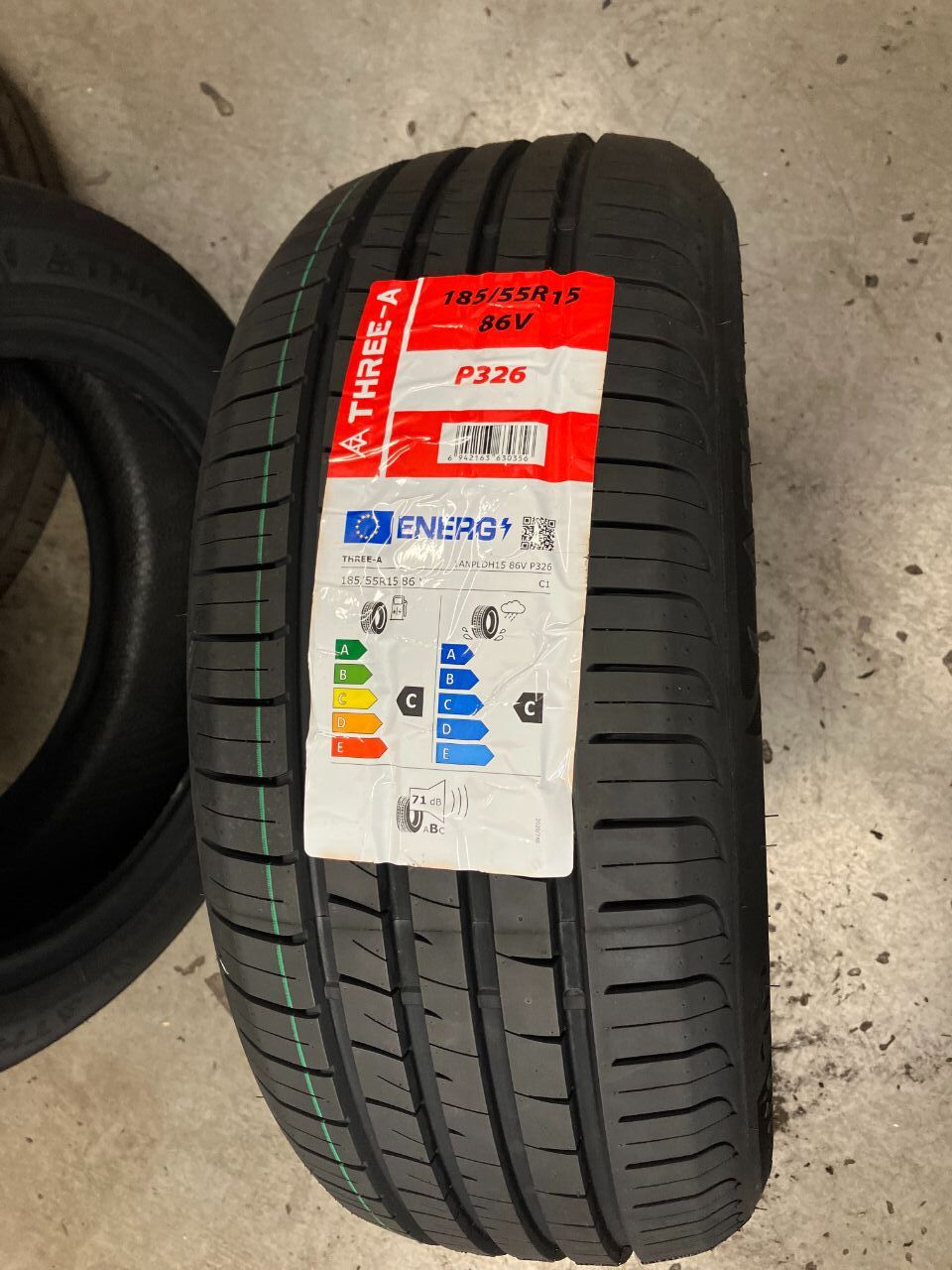

then with the new tyres fitted (and pressures set according to the owners manual, where someone previous to us had helpfully outlined them) we then took it for a blat up the M1 to my first time at a Tim Horton's just off Junction 5

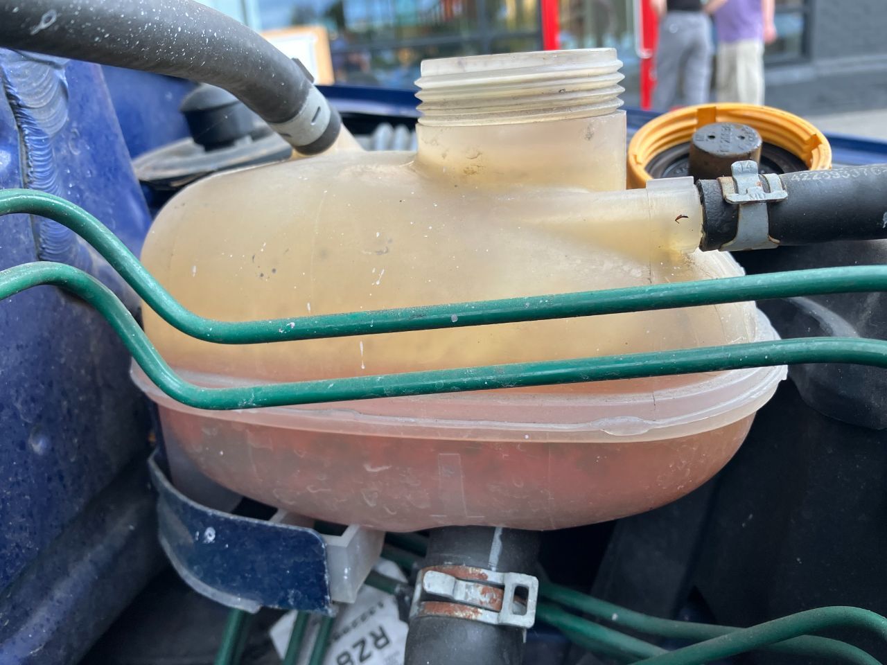

am I right in thinking its normal for the level to change slightly when you take the cap off and depressurise the system? coolant level did not change otherwise
and there was no mayo on the oil cap! also the check engine light even stayed off, so after a 2 hour round trip, ill take that as a nice re-assuring win! :) plan is now to go forward with fitting the exhaust, my brother is eager to try DIY it to save costs, and since the one @beko1987 linked to looks to be fairly simple, just 2 major parts, I figured its worth a shot, with the front flexi as buggered as it is already, I dont think we can make the exhaust any louder anyhow LOL (it certainly was pretty loud at 70) and at some point we will get the rear tyres changed too, since they are miss matched and are getting towards the end of life also, if anyone has any tips or tricks or gotcha's to watch out for regarding the exhaust im all ears :) (we are also planning a engine oil and filter service as well, maybe spark plugs and some other bits depending on how things go)

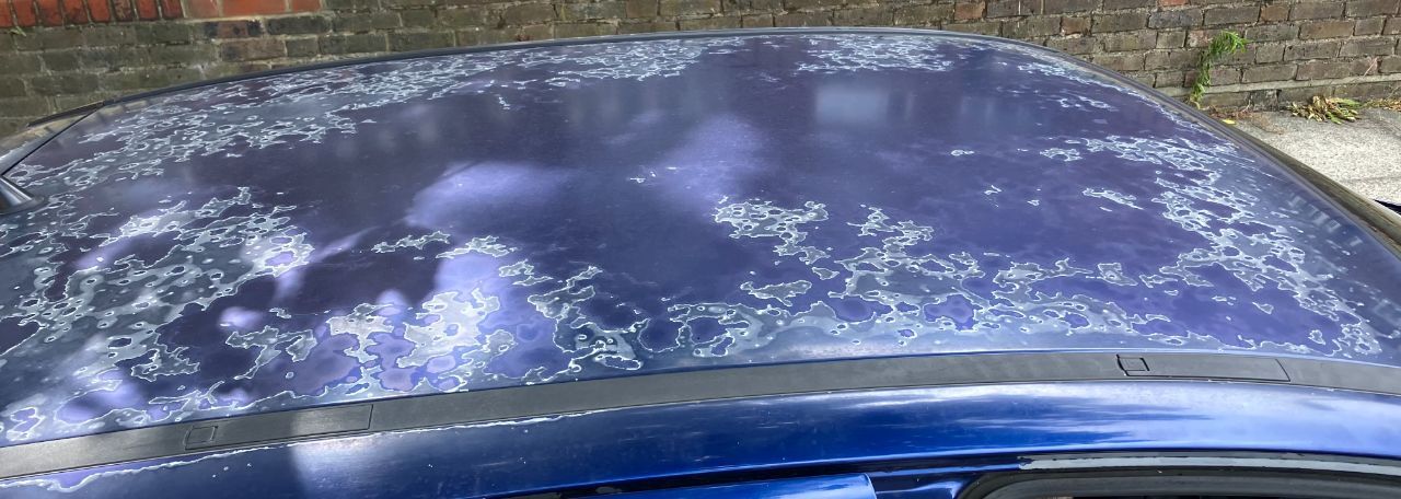

and finally a short of its magnficant roof, for all the lacquer peel lickers out there :) (we also even managed to get the Radio presets programmed in for my brothers preferred stations, the small things :)

Front pads do indeed look to have some meat on the front pad at least! The discs look quite liney though, but if it's braking fine leave it! I'd imagine it's seen more brake pads than discs in its time!

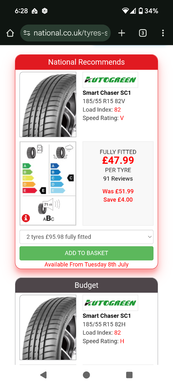

Tyres seem fairly priced too, especially for a Sunday job
Not much cheaper online

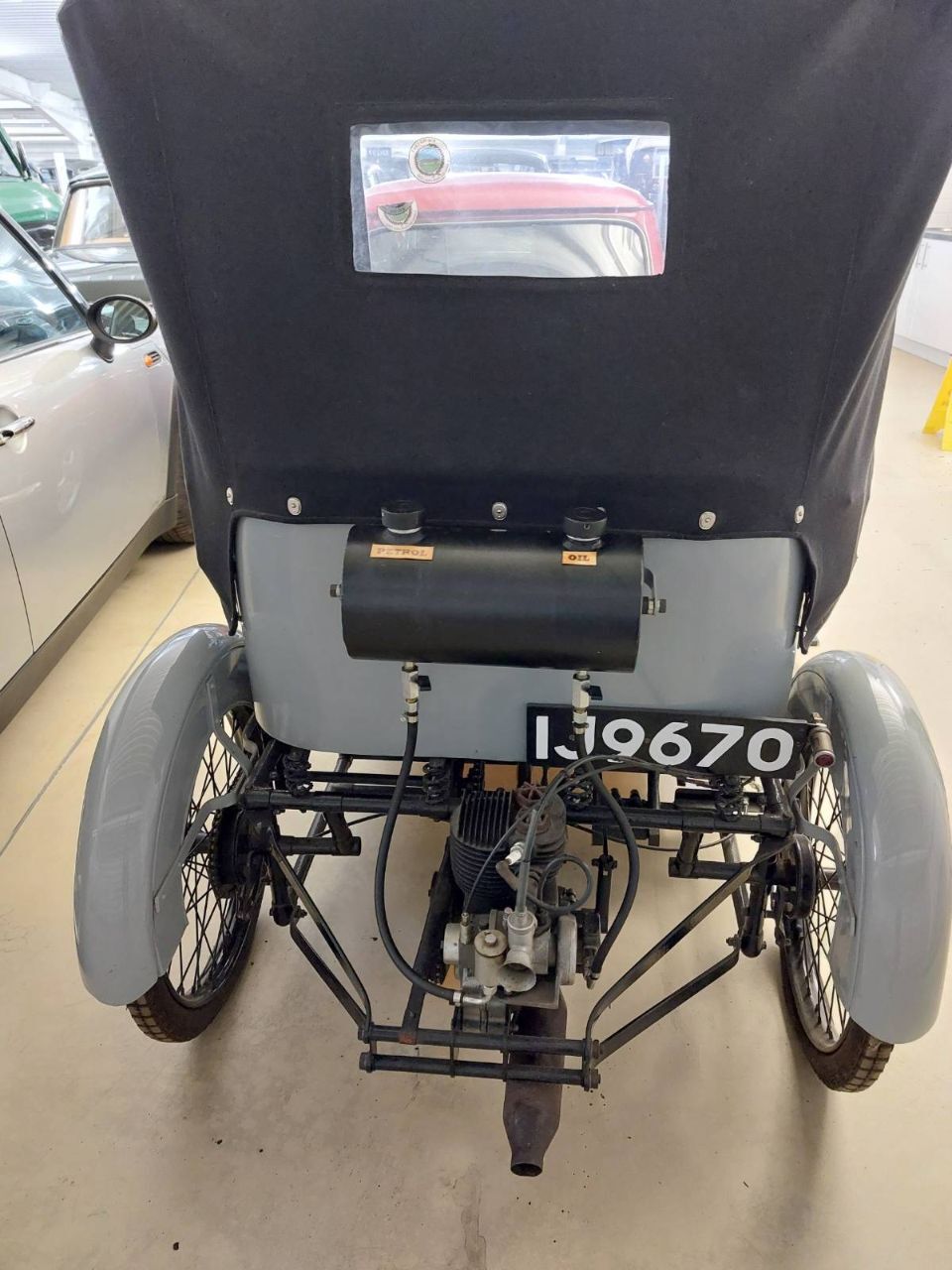

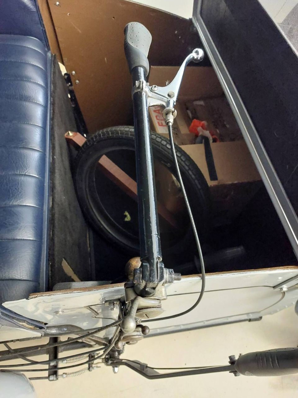

Interesting front suspension setup.  Like an Austin 7 but even more basic.
They obviously saved their engineering flare for  the rear end.  It looks too complex for a rigid set-up (i.e. no suspension) but I've gazed at the photo for a while and still can't understand how it works!
It's not rigid in the strict sense as there are springs between the axle and the body (four of them in fact), but I'm also struggling to work out how the engine is mounted.
and here I was simply looking at the petrol tank and thinking "interesting that its got a separate fuel and oil tank, I thought it would of just run on premix" :)

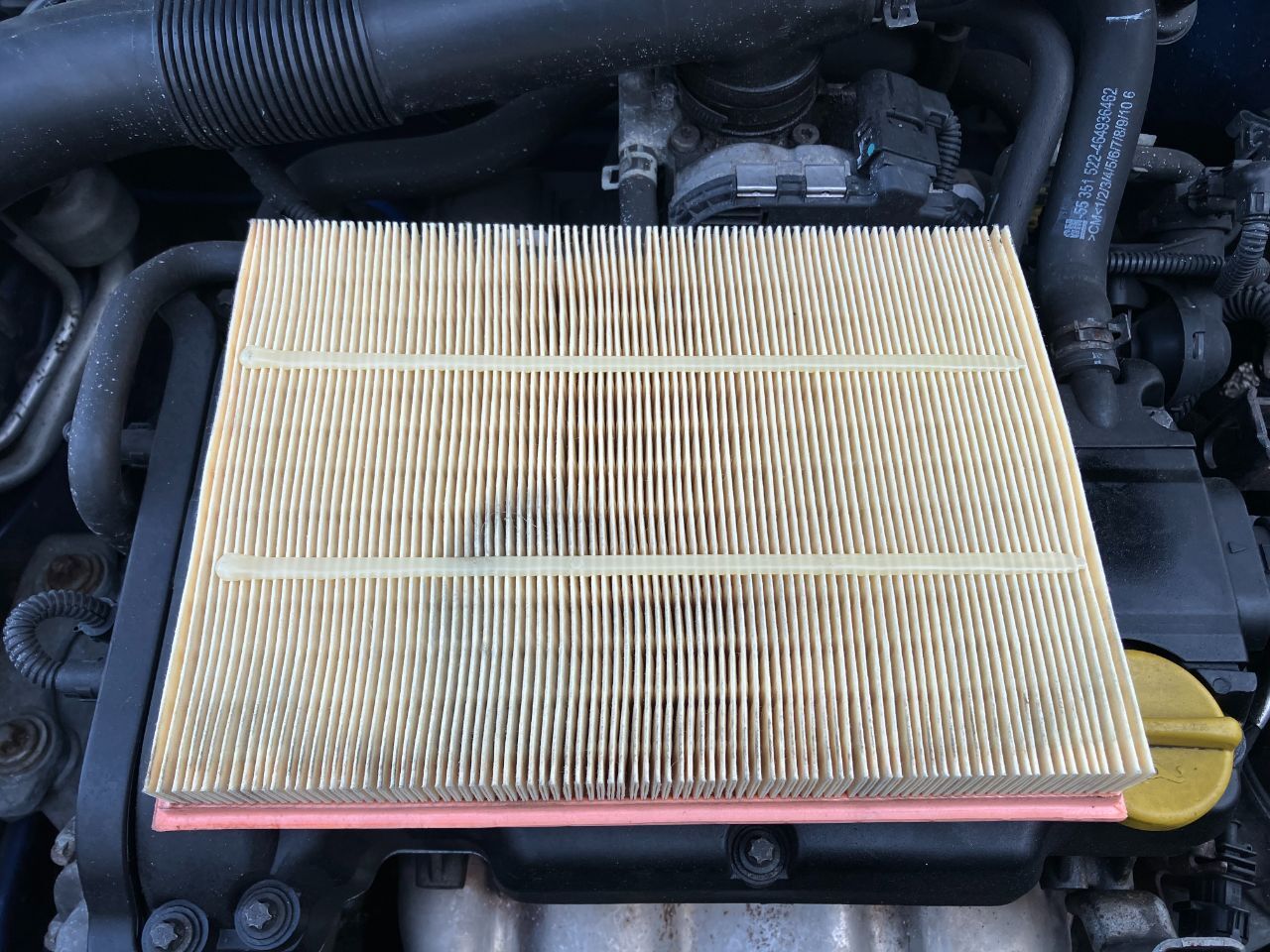

we headed home and started the service, first item done was the air filter, the old one (above) did not look too bad I think? but it was changed since we had the new one anyhow :)

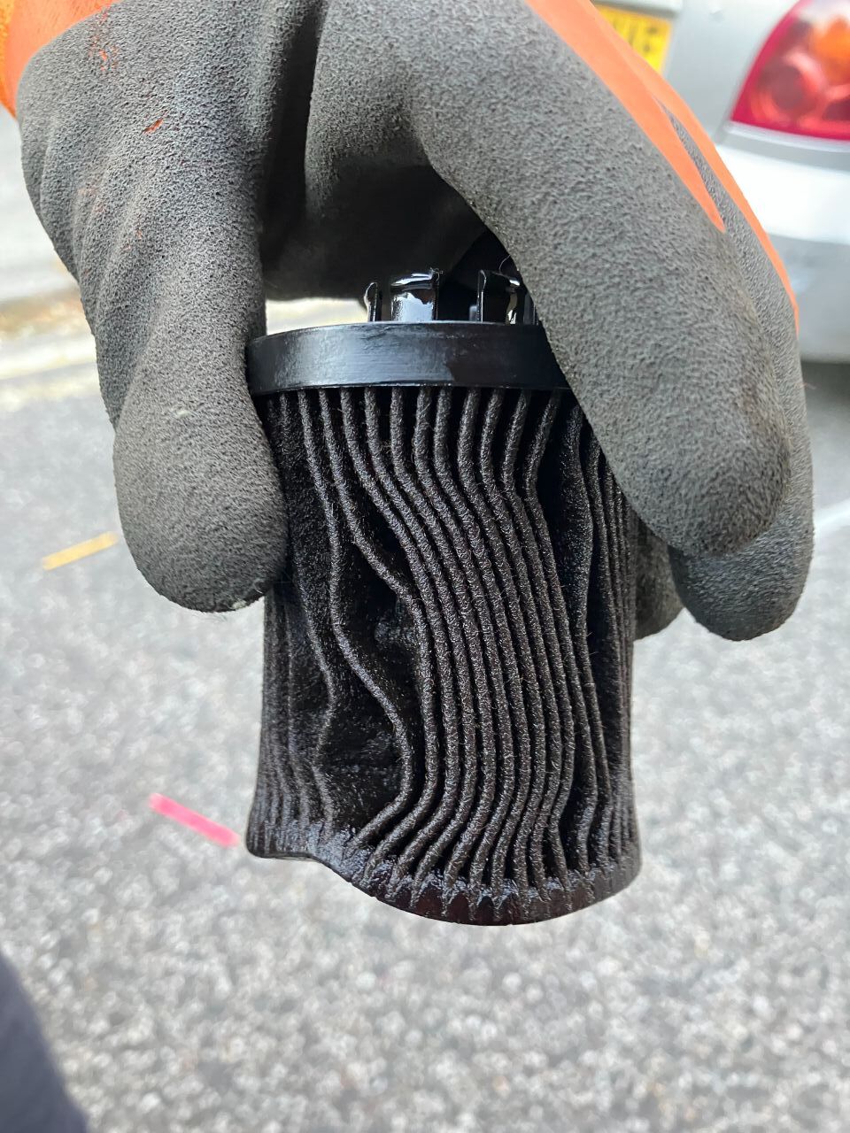

we got the oil filter out, which unlike the air filter, clearly *did* need changing and indeed the oil we took out was quite black as well
new filter (and new O-ring) in place and then, filled up with Amazon's finest Mannol 5W30 :) (and yes I did make sure to top up once the oil-filter had filled after the first start!) after that we where planning to do the spark plugs but I quickly realised after removing the coil pack "rail"

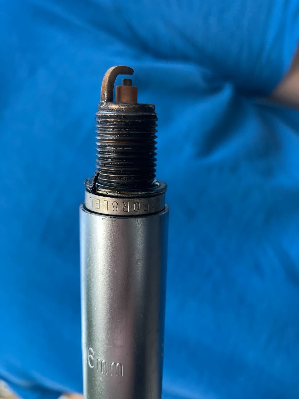

that my regular spark-plug socket was far too big, and that it turns out these Corsa's need a 16mm thin walled socket, so one of those has been ordered (its all a bit ironic because I thought to get the above rail out I needed a T40 torx bit which I did not have so purchased one for far too much in Halfords, only to then find out when actually removing the above its actually a T30 torx which I do have in my metrinch set!)

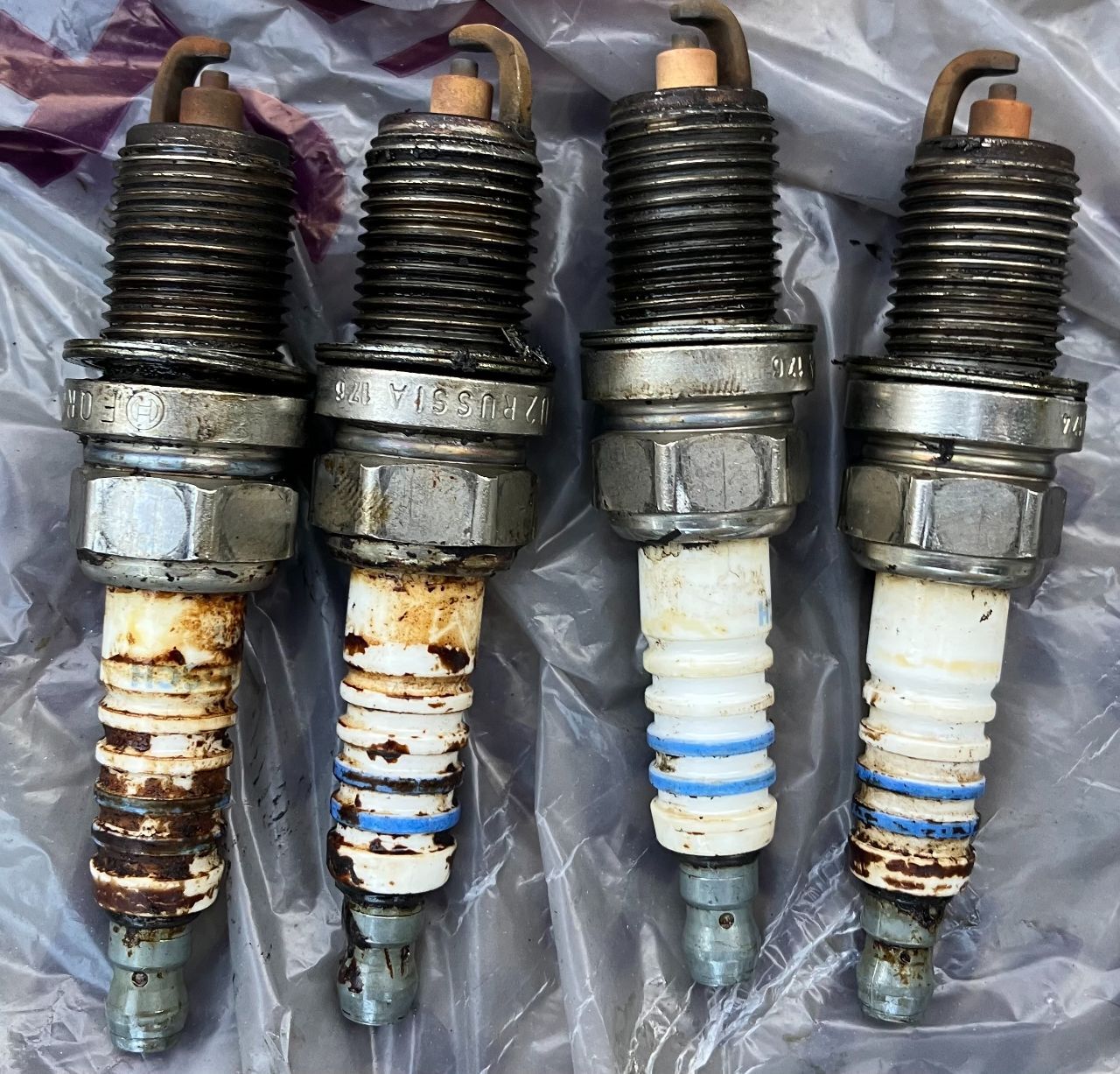

Managed to get the spark plugs changed on the Corsa :)
above are the old ones in no particular order, new spark plugs went in without any issues and we replaced some faded indicator bulbs, I also re-seated the oil filter as I realised I was supposed to clip the oil filter into the screw-cap then screw it into the housing all in one go, at this point all was tickity boo, car was running fine etc, so we packed up shop etc, and my brother went home
but just now (just before I started writing this post) my brother called me to say the engine oil pressure light had come on just as he was parking up at his home, a bit of back and forth on the phone determined that it goes out when you blip the throttle but comes back on at idle, I got him to put the oil filter back in the original way I did it (by sliding the filter onto the shaft then screwing the cap on) incase I somehow blocked something by clipping it in the cap? but that did not change anything, so I am a bit of a bit of a loss as to what could cause sudden loss of oil pressure at idle like this? (the dip stick is still reading full)
I did ask if he could see any obviously leaks or if anything was obviously pissing out oil, but nothing conclusive, maybe some drips on the floor that where not there before? but hard to say for sure atm.
it would very much appreciate it if anyone has any thoughts on the matter! (I am also in a bit of a catch 22 situation, as in true Autoshite fashion this only manifested itself once my brother was almost home, rather then say here at my place where I have all my tools, and with REV out of action I cant pop over to his place with tools!)
