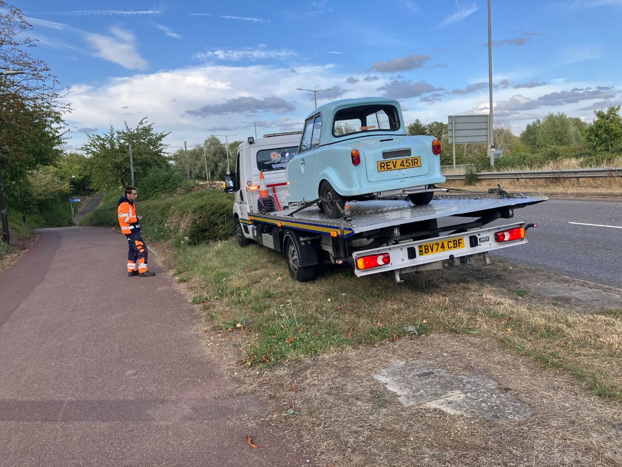

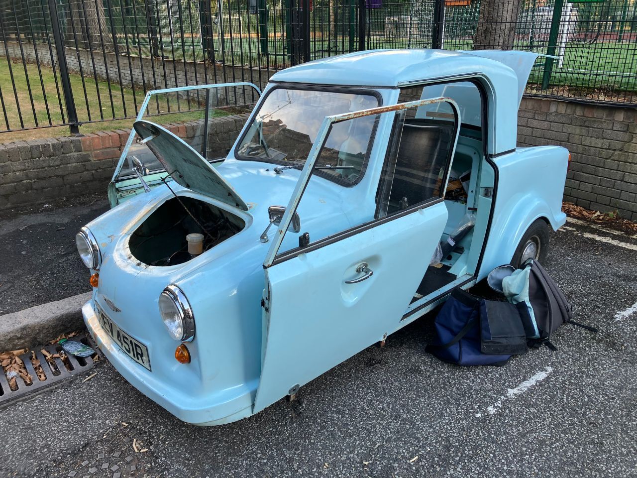

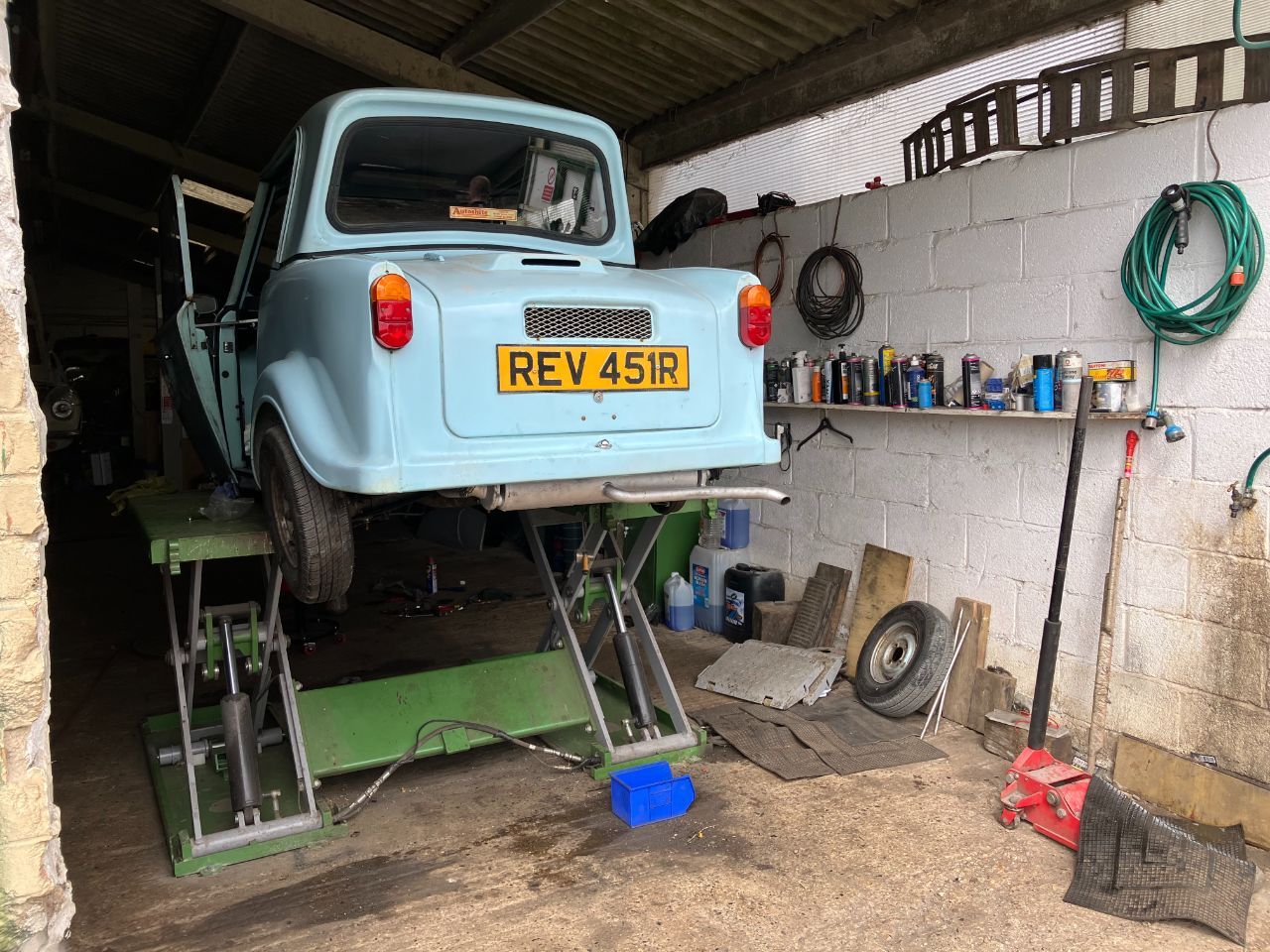

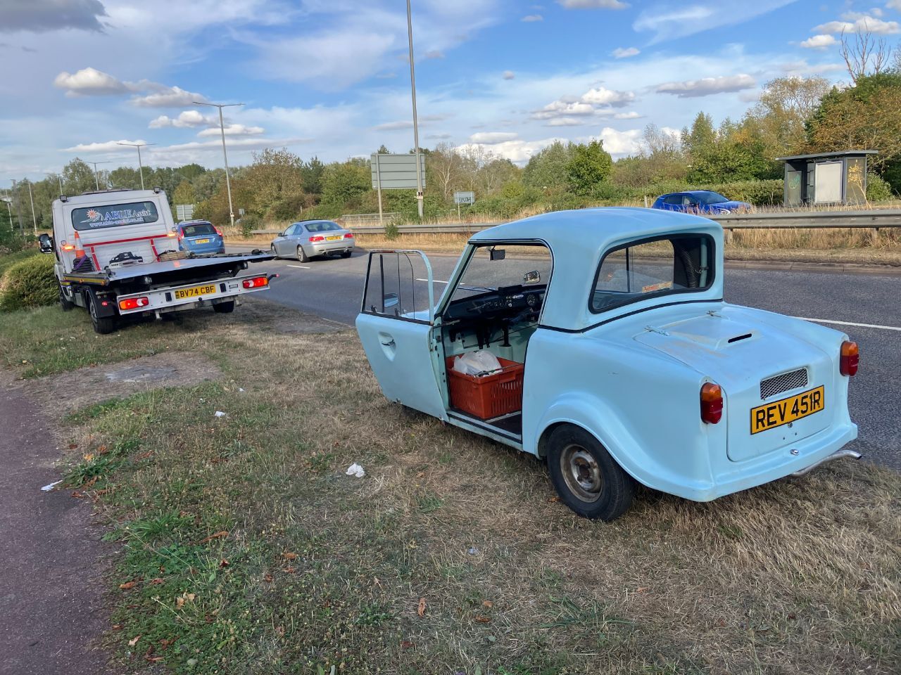

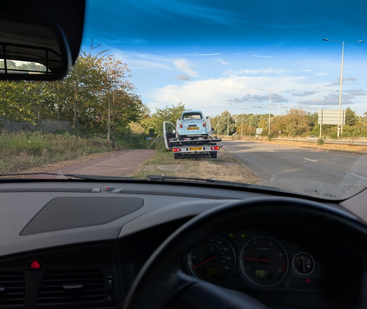

Today, fittingly for page 500 of this thread, REV finally, after literally dragging her heels last time, has finally come home!
in the most Autoshite way possible
on the back of a beaver tail, yes REV  *really* did not want to leave @Andyrew's nice workshop it seems! (I dont blame her tbh!)
you picked a fine time to leave me throttle cable! could of been worse, at least it did not let go on the all lanes running section of the M1!, it let go on one of Milton Keynes many little dual carriage way-between-2-roundabouts-bits
many thanks to @Andyrew and @Zelandeth for coming out to have a good look if it could be fixed on the road side, but alas not
many thanks to Zel for getting REV off the road itself and staying with me till recovery showed up!
and apologies to both @Zelandeth and @Andyrew for the giant Invacar shaped spanner I chucked into their afternoon/evening plans!
I did at least before then, at long last manage to grab a picture of REV with @Zelandeth's fleet, something I have been wanting to do for a long time now! and many thanks to Zel for the quick demonstration/trip out in the Trabant, your not wrong it is rather impressive just how much noise that gearbox makes!
and of course many thanks to @Andyrew for all the work done on REV, she is very much improved! even the annoying CVT whine at 53-56Mph has fucked off which I am most pleased about (since that speed is one of her happy cruise speeds) and many thanks to showing me around some of the stuff you had done on REV, its most interesting to see this stuff in actuality, and have it all explained while it in front of you and bits can be pointed at :)
hopefully I can procure another throttle cable (and find where the other half of the twist grip has gone off too) and get REV mobile before not too long :) only problem is REV's throttle cable is about 5 meters long, anyone got any recommendations on where one can get a throttle cable that long? LOL

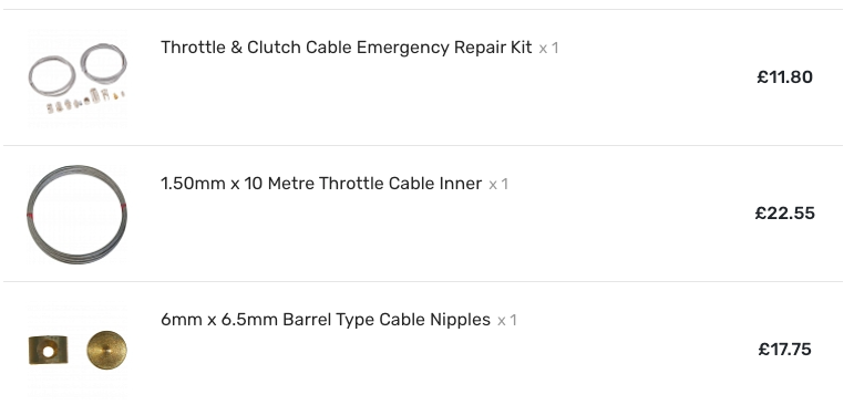

You can buy it on the roll and a bag of screw on ends,assuming you have no portable soldering equipment.They were known for snapping back in their heyday.a common trick bikers used was to have a spare cable tied alongside the one in use so if it did snap all that was needed was to drop the old one out and slip in the new one.
Here's some inner,you may want to measure what thickness your existing one is first. The likelihood is you won't need to change the whole.cable,just the inner wire.
https://www.motorcycleproducts.co.uk/150mm-x-10-metre-throttle-cable-inner/1/013498
No worries.  It's one of those really annoying sorts of breakdowns in that it's an easy 10-20 minute fix - IF you have the replacement part you need!  Bodging to limp a couple of miles would likely be possible, but nothing suitable for a trip as far as you were going, especially at rush hour.
As said, it could have happened in far worse places - at least it wasn't one of the many bits of MK with barriers all the way along the road and/or absolutely giant kerbs, and there was plenty of room to get you away from the traffic.
At least once that cable is swapped out you should be good for a bit!
Ah. A fair warning to me. I've already had one cable snap and the one currently fitted seems to have suddenly developed a lot of play...

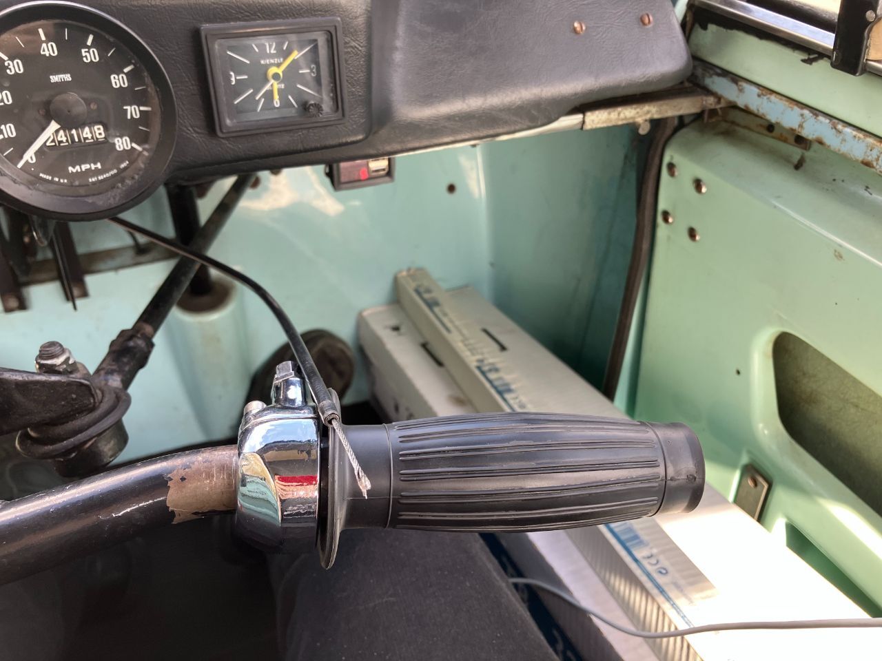

Oh yeah I have heard a few stories about snapped throttle cables on these and the fact they are a bit of a consumable! tho the one on REV barely made 1000 miles before snapping, I dont think they are meant to be quite *that* consumable mind, I had been working on getting a spare inner throttle cable assembly to keep in the car for this eventuality, but obviously I did not manage it soon enough!
it was noted while Andyrew and Zel where fiddling with it that the brass furrel/nipple on the end of the cable was a bit tight inside the circular hole it slots into on the twist grip, so there is some thought that it was binding up in the twist grip and not freely rotating putting extra strain on the throttle cable, causing the end of it to bend back-n-forth every time the throttle was actuated
so that will be something ill look out for when fitting a new cable, I also wonder if all the constant, London start-stop traffic has exacerbated things also? since your constantly on and off, actuating the throttle

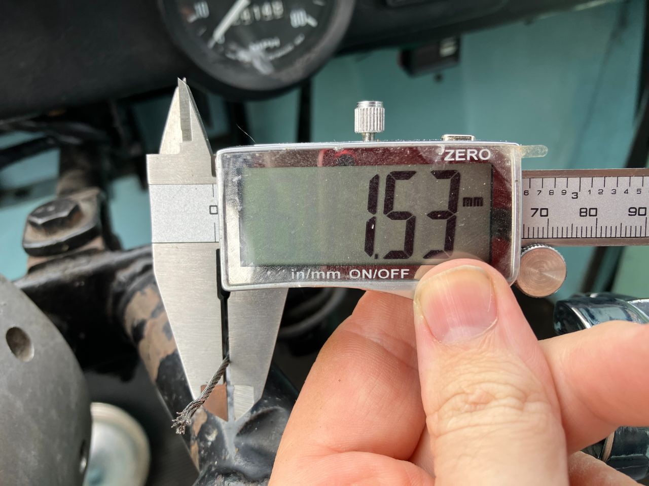

Thanks for the link to the inner-cable length :) I went down to REV with a set of callipers and measured things up and ordered hopefully suitable replacement gubbins! (and also stuck the hub-caps back on)
they did not have any 6mm diameter nipples that where only 5mm thick/long, but looking at the twist grip I think theres enough side-to-side space for the thicker 6.5mm thick nipple
(and yes it took me longer then It should of to remember/realise that the other half of the twist grip was right in front of me LOL, I had forgotten was installed flipped/the other way around as part of something to see if borrowing bits from the heater-controls could work)

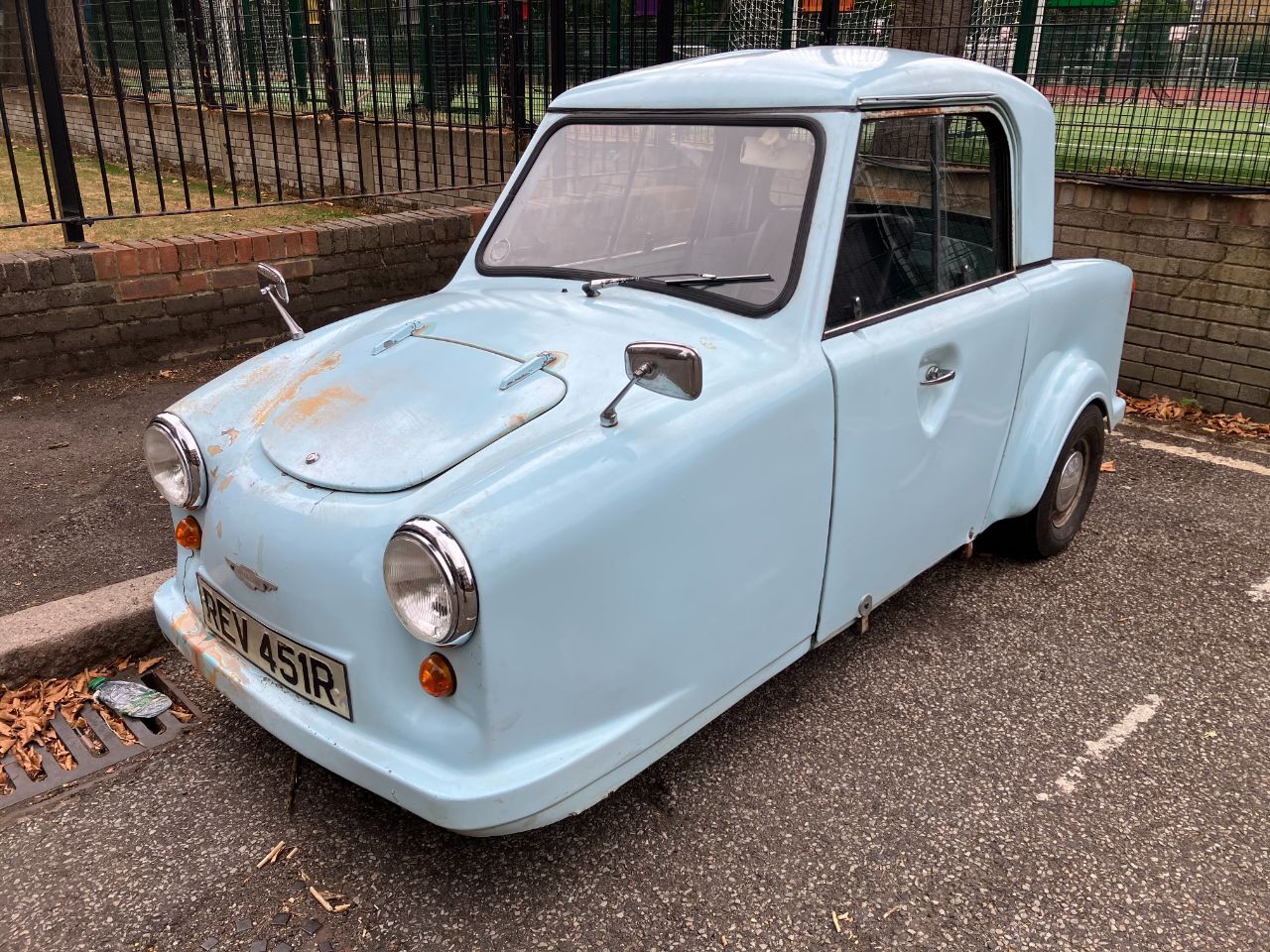

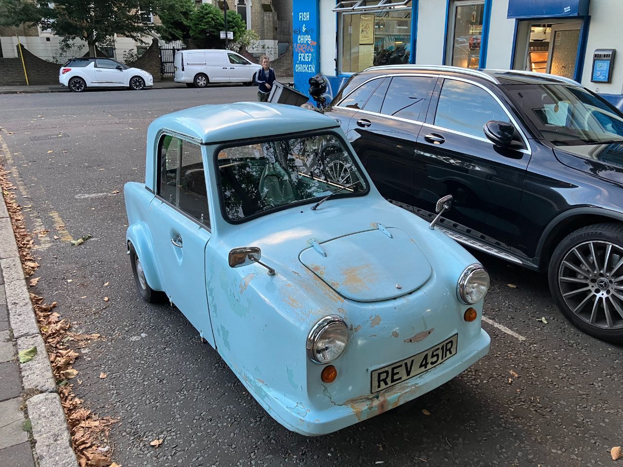

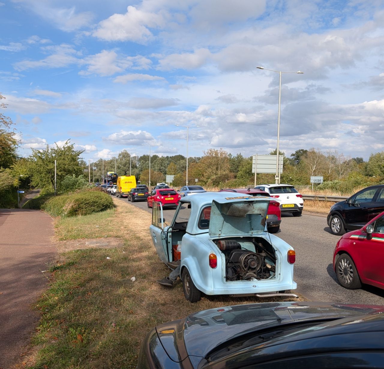

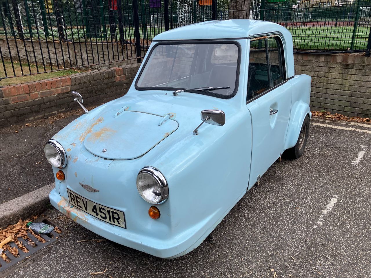

Throttle cable gubbins arrived today, and after a massive palaver and much faffing about, I managed to effect a replacement inner throttle cable and got REV mobile again :)
obligatory test run to the chippy and back of course :)
not much in the way of photos because I was too busy fucking about trying to get things sorted!
the main issue was just getting the brass ferrule/nipple  to fit in the hole on the twist grip and have it rotate freely inside that hole (I am not sure if the little ferrules I have where slightly over-size or the hole under-size, I suspect a bit of both, because it was noted that the previous ferrule was a bit tight in the hole and one of the new ones measured to something like 6.09mm rather then 6.00 on the dot.
it was also not helped by my somewhat messy solder job, it was only after I had taken it downstairs to REV did I realise you *cant* have *any* cable poking out the end of the ferrule, so i had to trim that then sand it as smooth/flush as i could, I initially thought this was the sole reason for my fitment issues, but then as a sanity check I took a couple more fresh ferrules from the pack and tried those on their own and they also did not want to go in freely, so it was at that point I realised I had to basically slightly enlarge the hole on the twist grip
I somewhat got there in the end it aint 100% perfect, but hopefully its good enough, and I think if if I do a better job soldering (ie make sure theres *no* cable sticking out the end of the ferrel) things should hopefully go smoother, the next time I need to do something like this
and there was also the faff of trying to feed the throttle cable into  the outer, the main problem I found with that was frayed ends causing it to bind up, I got there in the end, by clamping the throttle cable in a pair of mole grips and cutting flush to the mole grips to create a clean end, but I think I need better cutting tools really!

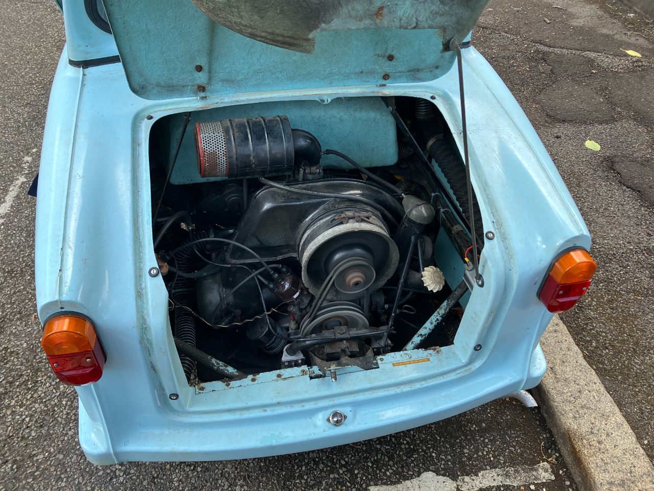

also had a rather unusual occurrence, in that while I had REV's engine running, (testing throttle cable action in all steering positions etc)
I heard a couple strange noises from outside that made me get out and wonder what they where, unable to deduce what they where, I get back in REV continue testing then a short bit later, theres a *thunk* as something impacts the roof and I see this bounce off into the road
no idea where it came from!  but it living in REV now for the time being LOL
can only assume it fell out of the tree REV is next too, but how it got stuck in a tree in the first place? I dont know, very bizarre, anyone from the shite in miniature missing a bright green Porsche ? LOL
How I used to make cables was by using a centre punch in the centre of the cable to splay the strands out slightly,then slide the ferrule up so that they were tight in the hole and flush,then heat the ferrule up with a small blowtorch and feed solder in from the cable end,suitably fluxed of course.soaking the end to be cut in solder before cutting stops it fraying
You have got that  spare one you  made up in the car  , ready for the next time it fails ?  :grin:
I had a right faff once getting solder to flow on the steel cable, so i used a bit of  bakers fluid ... perfect ! Only i didn't wash it off after , and being so corrosive , it rusted and snapped again   within months :-(
Like dan said , poke it in the hole and mash it up before soldering , it wont come out then ..
