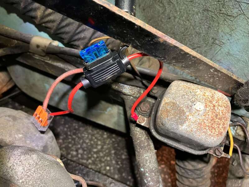

wuvvum Posted October 30, 2024 Posted October 30, 2024 4 hours ago, LightBulbFun said: ill have to get some 9.5mm spade connectors then What for? Just shove the ends of the wires through the holes in the terminals and twist them round. 👍 BorniteIdentity, Rust Collector, Snake Charmer and 2 others 1 4
LightBulbFun Posted October 30, 2024 Author Posted October 30, 2024 another day, another REV tinkering session all the electrical gubbins I had ordered had arrived so while I still had some daylight left I set about getting them fitted main thing was replace the broken fuse holder with a new inline blade type fuse and fuse holder, hopefully one will forgive the wago connector, as first of all before making anything perminant-perminant, I wanted to verify this was indeed the issue (plus not only is it the bigger size of wago connector I belive Wago's themselves are pretty decent, certainly in my experiance much better then chocolate blocks! its a fair distance from anything its not as close to the metal work as it looks) and I am pleased to report, the crusty and failed fuse holder was indeed the cause of my lack of charging, and with the replacement fuse holder charging has now returned battery certainly needs a charge tho, its very noticeable just how much brighter all the lights get when the regulator cuts in as you take it off idle! but with that and a couple other odd jobs taken care of, the battery charging once more, I took her out to the chippy and back, this time remembering to grab a night-time shot for @Yoss as I failed to do so last time! (with a bonus shot of someone probably going "HFM!" at London prices LOL) and soon-ish I was back home it was a fun drive there and back, plenty of stop start traffic, gnarly junctions, delivery riders on bicycles e-bikes and mopeds wizzing about the place and a token few pedestrians entirely dressed head to toe in black clothing just walking out onto the road, all good for keeping one alert at least (and is why I elected to still go out even tho it was dark, I figured its good to do these things so one is kept fresh and familiar with it all) Sunny Jim, wuvvum, AnnoyingPentium and 37 others 37 3

plasticvandan Posted October 30, 2024 Posted October 30, 2024 You must have been driving pretty slowly for the bag not to fall off the roof. Ideal connection would of course be a soldiered joint if you can manage it,suitably heat shrinked. Probably worth leaving the regulator alone for a while to prove the rest of the system,and if it plays up you have one ready.

LightBulbFun Posted October 31, 2024 Author Posted October 31, 2024 on the battery front, I spoke with my brother and he happens to be dropping by here on Saturday for something anyhow, so I have just gone ahead an ordered a new battery from Tayna, same type 037 just to keep things simple (and I think its even the same brand etc) my plan/thinking with that is, hopefully by the time my brother gets here on Saturday ill have the new battery in hand and have it topped up, and will have figured out how the battery clamps work, so that once he gets here, he can just lift the old battery out bring that upstairs for me to put on charge, and then right away take the new battery downstairs and pop it in for me, I can then keep the 2021 on standby somewhere in the house, so if the new battery itself then goes flat, I can just rotate the 2021 battery back in, and so forth with minimal down time of having to wait for batteries to charge or getting my brother in on 2 separate days Dyslexic Viking, Rust Collector, Mrs6C and 6 others 9
Dobloseven Posted October 31, 2024 Posted October 31, 2024 Seems like the main issues with REV are electrical and that's your forte anyway,so all seems to be falling into place for you.Wouldn't think the long periods of inactivity would have done the battery any good either.I'm a firm believer in keeping vehicles "live",which hopefully is what'll be happening now.Really happy for you as well.Keep telling us all about it. auntiemaryscanary, LightBulbFun and Snake Charmer 3

Noel Tidybeard Posted October 31, 2024 Posted October 31, 2024 i deffo think there is mileage in replacing the crappy continental fusebox for one of the new type of blade fuseboxes- for no other reason than blade fuses are soooo much easier to find/store for any "oh shit" moments when the loom smoke tries to escape LightBulbFun, Rust Collector and mercedade 3

LightBulbFun Posted October 31, 2024 Author Posted October 31, 2024 8 minutes ago, Noel Tidybeard said: i deffo think there is mileage in replacing the crappy continental fusebox for one of the new type of blade fuseboxes- for no other reason than blade fuses are soooo much easier to find/store for any "oh shit" moments when the loom smoke tries to escape oh the main fuse box on REV is your normal Lucas glass fuse box remember a Model 70 is a collection of spare parts from around the world flying in lose formation (C) @Zelandeth so the engine/Dynastart wiring is all Bosch but the body/chassis wiring is all Lucas but your right that I have been thinking it might be worth my while replacing that with a modern blade fuse box, its a fairly standard Lucas 2 fuse box shared with many vehicles so I do wonder if someone makes a modern equivalent that is the same footprint but takes a couple blade fuses instead I also need to figure wheres best to get wire from, i'd like to order up spools of wire of all the colours used in the Model 70 wiring loom, so if I need to make any additions/changes/renew something, I want to be able to keep the colours all the same, there are 9 colours in total but a few wires use combinations of those (Brown and yellow for the charging light for example) so I need to figure out how many combinations are used as well rather scarily I have seen the odd Model 70 where the glass fuses have been replaced with the wrong type in that, they are lucas 25A and 35A fuses, but thats their *blow* rating not their contious running rating, so in modern parlance they are more like 12.5A and 17A fuses but I have seen some Model 70's fitted with actual 35A chunky fuses for example! (thankfully last I checked REV's are all correct but ill double check soon)
