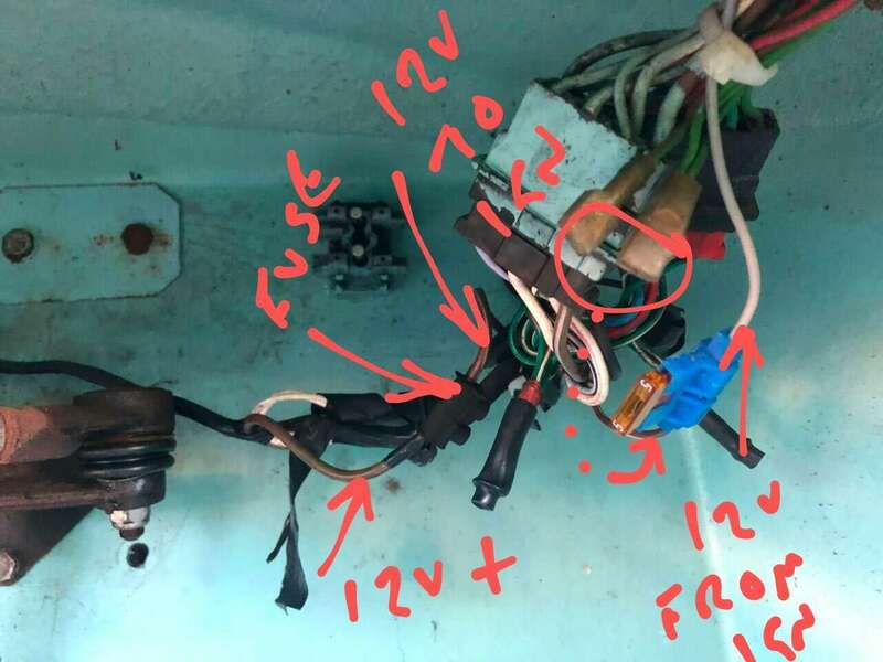

uk_senator Posted January 2, 2023 Posted January 2, 2023 8 hours ago, Harriytait said: So after cleaning up the Earths I’m now getting some life out of the rear light units, the rear indicators aren’t flashing but instead lighting the brake light on the left or right side “depending on the position of the indicator switch” and the rear lights and brake lights aren’t working at all, I’ve had a prod with the multimeter and everything is receiving voltage and checked the inline fuse next to the voltage regulator and 5 amp fuse under the dash which both seem fine and checking with the multimeter proves this. Looking at the fuse box under the dash shows no wires connected to it but since I’m receiving voltage to the rear light units I don’t think it’s my problem, obviously electrical issues aren’t my strong point and I’m honestly stumped right now. Any suggestions? Could be an actual earth lead, rather than just the connections, could try bypassing various earths (as well as feeds) with a test lead, also, could be stalk or ignition switch issues, again, try bypassing.

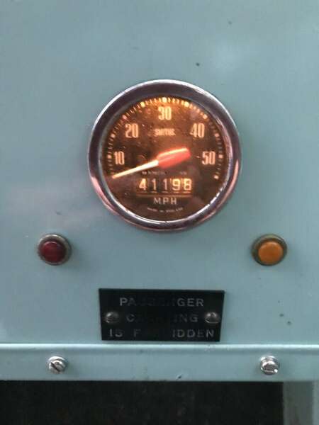

LightBulbFun Posted January 3, 2023 Author Posted January 3, 2023 2 hours ago, AdgeCutler said: 100 miles in Brian already! Awesome now get a photo of the speedo needle pointing the other way (always forget that Mk12 speedo's do technically clock up to 60 even if its not marked in a number like it is on an Acedes or Tippen Delta)
AdgeCutler Posted January 3, 2023 Posted January 3, 2023 6 hours ago, LightBulbFun said: now get a photo of the speedo needle pointing the other way Sod that for a game of soldiers! Despite its appearance the Mk12 is quite an intense driving experience and I don't fancy trying to take pictures while driving. That said, Brian does seem much more manageable since I lowered the steering sensitivity yesterday morning, he was quite twitchy before. Another thing noteworthy of the driving experience is that you have to try for a good smooth gear change, mismatching the gear to engine revs results in the drive wheel applying engine braking to the one side thus pulling you to the left. egg, Six-cylinder, Weird Car and 2 others 5

Zelandeth Posted January 4, 2023 Posted January 4, 2023 On 1/2/2023 at 3:30 PM, Harriytait said: So after cleaning up the Earths I’m now getting some life out of the rear light units, the rear indicators aren’t flashing but instead lighting the brake light on the left or right side “depending on the position of the indicator switch” and the rear lights and brake lights aren’t working at all, I’ve had a prod with the multimeter and everything is receiving voltage and checked the inline fuse next to the voltage regulator and 5 amp fuse under the dash which both seem fine and checking with the multimeter proves this. Looking at the fuse box under the dash shows no wires connected to it but since I’m receiving voltage to the rear light units I don’t think it’s my problem, obviously electrical issues aren’t my strong point and I’m honestly stumped right now. Any suggestions? Hopefully this annotated scribble will help slightly... Brown wire is the main +12V feed, tapped off the hot side of the starter solenoid. There should be a fuse between it and the brown & white wire, which then takes that feed to the ignition switch. The white wire is the switched live which comes back from the ignition switch, which via a fuse should connect to the three green wires via the other fuse. Not sure what the wire in the background behind the 5A blade fuse is doing, but those two green wires should be on the downstream side of that fuse if my understanding of the wiring diagram is right. Those green wires feed the horn, indicators and wipers...so are kinda important. Mrs6C and AdgeCutler 2

wuvvum Posted January 4, 2023 Posted January 4, 2023 On 1/3/2023 at 11:37 AM, LightBulbFun said: (always forget that Mk12 speedo's do technically clock up to 60 even if its not marked in a number like it is on an Acedes or Tippen Delta) That top graduation is 55 innit? AdgeCutler and LightBulbFun 2

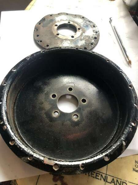

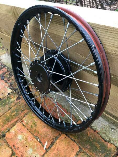

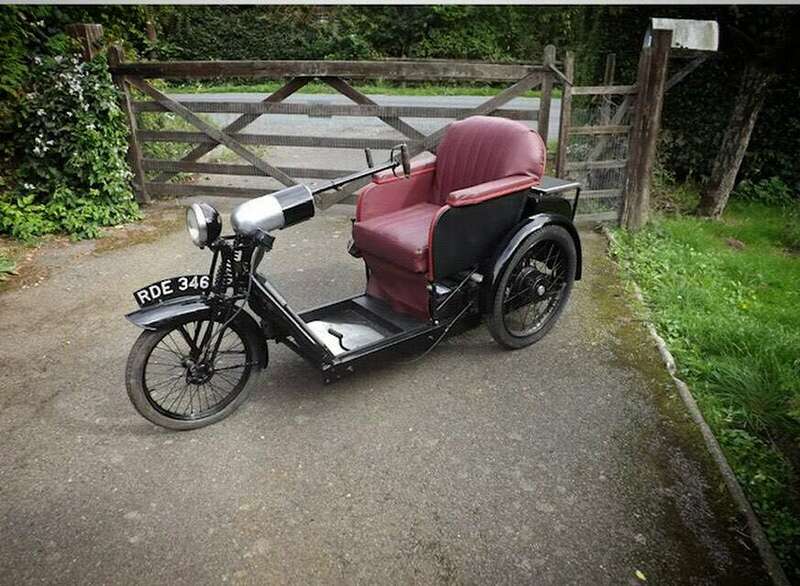

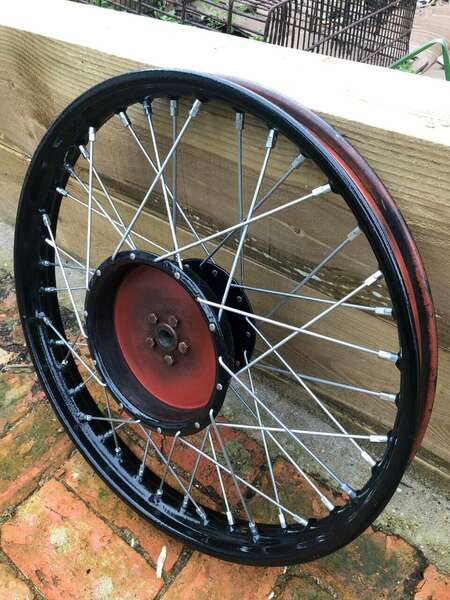

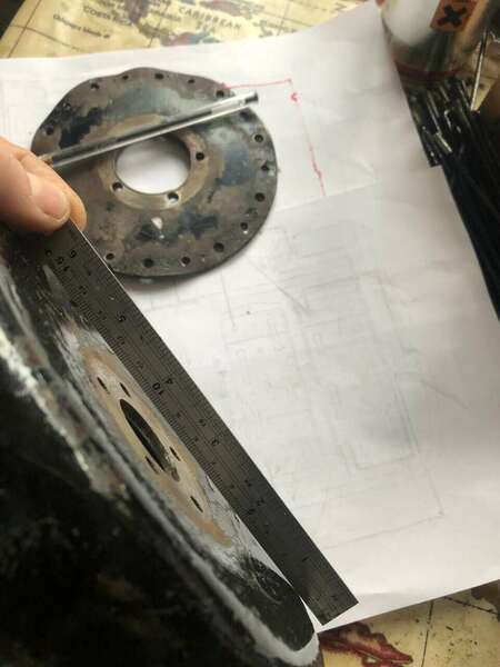

brummiejon Posted January 7, 2023 Posted January 7, 2023 More progress on “Flo” my Stanley Argson Electric RDE 346….. after fixing the dished brake drum and repainted the hub I had the wheel re-laced this week, nice job by PW wheelbuilders in Herne Bay. The wheel rim has a bit of a flat spot (probably kerbed at some point) but it will all add to the character of the ride….. Just need to paint the spokes, fit the tyre and get it back on Flo Rust Collector, AdgeCutler, egg and 4 others 7
