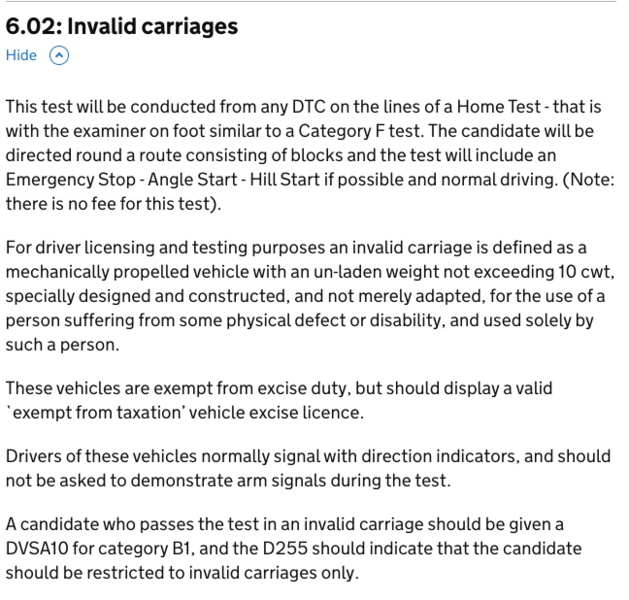

LightBulbFun Posted February 21, 2022 Author Posted February 21, 2022 did a bit more digging on the whole invalid carriage legislation front and it turns out that the DVSA still has guidance to driving test examiners on on how to give a driving test for an invalid carriage user! I wonder if this implies that if you really wanted to you could ring up the DVSA and still take a driving test in a Model 70!, along the same lines I do wonder when the last time someone one took their driving test in an Invalid vehicle was... I mean keep in mind even after the Ministry stopped issuing them and AC/Invacar stopped making them, nothing stopped someone back then buying an existing private example from someone on the used market! and its fun to think in such a scenario it might not be a Model 70, but could be a Villers machine or even electric machine! (and within the Ministry I guess if a User somehow lost their licence through bad driving and was forced to retake their test? although I imagine if you managed to get such an offence the Ministry would also take your vehicle from you!) https://www.gov.uk/guidance/guidance-for-driving-examiners-carrying-out-driving-tests-dt1/06-particular-types-of-vehicle-and-adaptations they also amusingly have a section dedicated to the Citroen XM's parking brake (I cant say I recall seeing an extra foot pedal when I drove the XM at the FoD?) and for those curious details on a Home test/Category F (Tractor test) can be found here https://www.gov.uk/guidance/guidance-for-driving-examiners-carrying-out-driving-tests-dt1/01-the-practical-driving-test-and-extended-test-for-cars AnnoyingPentium, Eyersey1234, AdgeCutler and 2 others 5

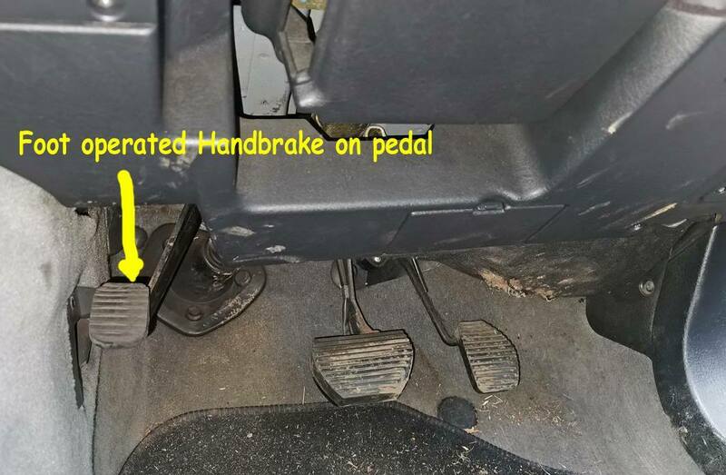

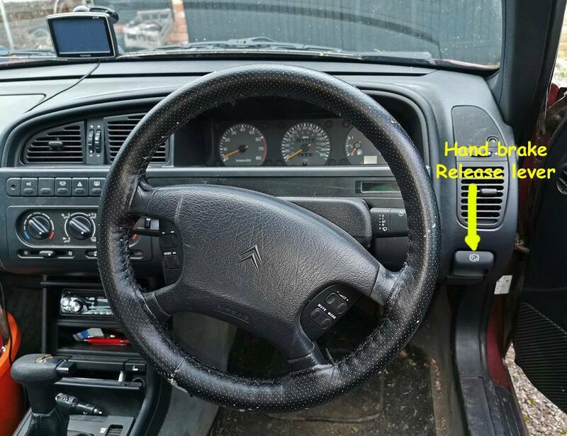

Six-cylinder Posted February 21, 2022 Posted February 21, 2022 40 minutes ago, LightBulbFun said: they also amusingly have a section dedicated to the Citroen XM's parking brake (I cant say I recall seeing an extra foot pedal when I drove the XM at the FoD?) Here are the handbrake controls on an XM, partly operated by foot! The whole parking brake arrangement on an XM was stupid because if you have a manual you are faced with 4 pedals! The arrangement of operating on front discs was also unsatisfactory. The problem is if your apply a light griping pressure that just holds your car, when the brakes cool down they contract and allow you car to roll away. Several customers and my boss experienced this when I worked for a Citroen dealer in the mid 1990s. AnnoyingPentium, LightBulbFun, FakeConcern and 1 other 4

Dobloseven Posted February 21, 2022 Posted February 21, 2022 Reminds me of many years ago when the fellow opposite left his XM(manual) blocking his drive and went to India. His daughter, and myself, when she asked for help, were well confused by it when it needed moving. Think recent Vauxhalls with rear discs have similar handbrake problems with cooling discs. I know my 66 reg Zafira C has its moments if I don't pull it on hard enough at the end of the day on our sloping drive.
wesacosa Posted February 21, 2022 Posted February 21, 2022 5 hours ago, Six-cylinder said: Here are the handbrake controls on an XM, partly operated by foot! The whole parking brake arrangement on an XM was stupid because if you have a manual you are faced with 4 pedals! The arrangement of operating on front discs was also unsatisfactory. The problem is if your apply a light griping pressure that just holds your car, when the brakes cool down they contract and allow you car to roll away. Several customers and my boss experienced this when I worked for a Citroen dealer in the mid 1990s. I believe when the XM was launched it was auto only so they could get away with it. They subsequently released a manual version some years later but never bothered to update it. I still haven't tried a hill start in my XM manual yet, I suspect it should be fun. Operating the front callipers and not the rear has no doubt caught a few MOT testers out (including mine)
High Jetter Posted February 21, 2022 Posted February 21, 2022 XM wasn't the earliest with a foot-operated parking brake though.
Six-cylinder Posted February 21, 2022 Posted February 21, 2022 1 hour ago, wesacosa said: I believe when the XM was launched it was auto only so they could get away with it. They subsequently released a manual version some years later but never bothered to update it. I still haven't tried a hill start in my XM manual yet, I suspect it should be fun. Operating the front callipers and not the rear has no doubt caught a few MOT testers out (including mine) The XM V6 was launched as Automatic only but the 2.0 cars were manual at launch of both Oct 1989. Auto was a £908 option on 2.0 cars from Feb 1990. Hill starting is not a problem, find the clutch balance as usual, one foot on the accelerator and the other on the clutch. Then hand release the parking brake with the dash lever and control progress with the clutch. The problem is when you come to a stop with four pedals with one foot on the brake and one on the clutch most people don't have a third foot to apply the parking brake. So I come to a stop holding the car on the footbrake, knock it out of gear then I can release the clutch and apply the foot operated parking brake. Works but I would rather not have to take it out of gear before I can apply the parking brake. 13 years and many miles of doing that with my 1972 DS, it still feels uncomfortable. LightBulbFun and wesacosa 1 1
LightBulbFun Posted February 21, 2022 Author Posted February 21, 2022 6 hours ago, Six-cylinder said: Here are the handbrake controls on an XM, partly operated by foot! The whole parking brake arrangement on an XM was stupid because if you have a manual you are faced with 4 pedals! The arrangement of operating on front discs was also unsatisfactory. The problem is if your apply a light griping pressure that just holds your car, when the brakes cool down they contract and allow you car to roll away. Several customers and my boss experienced this when I worked for a Citroen dealer in the mid 1990s. interesting! I wonder how I missed that as a i feel like that would have been something I would have noticed! although of course thinking back to it I cant recall seeing a typical handbrake pull maybe I was too distracted by the gearshift, which no-matter where I shifted it to, I always ended up in reverse somehow! have you fixed that gear shifter position light yet? LOL 3 hours ago, Snake Charmer said: Just like my Mercedes only French. 2 minutes ago, High Jetter said: XM wasn't the earliest with a foot-operated parking brake though. yeah I noted that too, its interesting how they make specific note of the XM's parking brake arrangement, but make no mention of any Mercedes! (especially as with a Mercedes its released with your foot so on a manual car hill starting is an issue from what I have read about, but I have never driven one! I think the only Mercedes I have ever been in has been Zel's 208D!) (in-fact Model 70's could be "specced" with a foot operated parking brake as well, but that had 2 pedals, 1 to apply it and 1 to release it, which meant you could have a Model 70 with 4 foot pedals despite being an Automatic! )

Mrs6C Posted February 21, 2022 Posted February 21, 2022 57 minutes ago, LightBulbFun said: especially as with a Mercedes its released with your foot Pretty sure the 124s have a parking brake release handle in the dashboard... the foot operates the brake and the handle releases it... LightBulbFun 1
LightBulbFun Posted February 22, 2022 Author Posted February 22, 2022 45 minutes ago, Mrs6C said: Pretty sure the 124s have a parking brake release handle in the dashboard... the foot operates the brake and the handle releases it... ah my bad! I just had recalled some people complaining about the foot parking brake on manual Mercedes making it difficult to do hill starts and requiring you to have about 3 feet! so because since as @Six-cylinder says with the XM, if the release is done by a handle then hill starting or anything such would not be any different from a regular car*, I assumed with the Mercedes given the complaints that it was not done with a handle but with your foot somehow (*he says having never driven either a Mercedes or Citroen XM "in anger" yet) speaking of parking up (other tortuous segues are available) I see Adam (or one of his buddies!) has been papped out and about in GPF282N https://twitter.com/TheDreadShips/status/1495864583575253001 its nice to see they are still out and about Mrs6C and Weird Car 2

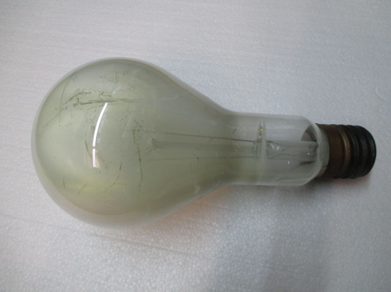

LightBulbFun Posted February 24, 2022 Author Posted February 24, 2022 6 minutes ago, Rusty_Rocket said: its interesting to note that most of the tungsten lamps that I have seen fail like this have been automotive lamps for some reason, I do wonder why that is, my current theories are either something to do with lots of thermal cycling stressing the glass to metal seals into failure and or the rough conditions/vibrations doing the same, maybe water getting in and causing the glass to crack from thermal shock although that normally causes a major air leak Rusty_Rocket 1

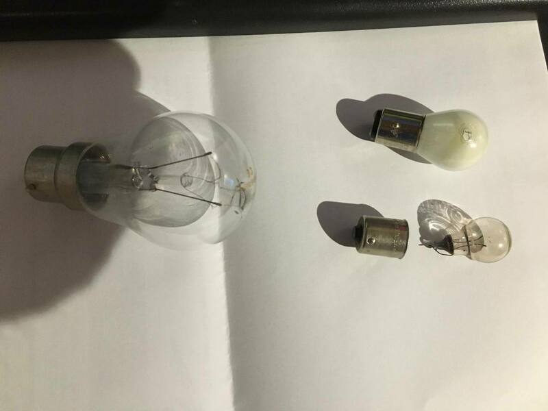

CaptainBoom Posted February 24, 2022 Posted February 24, 2022 **Browses shelf of weird shit that 99% of the population would have thrown away long ago** I have these three, top right is a standard 12v lamp gone milky white like they do, but blew a tiny hole in the glass where it melted the plastic bulb holder, bottom right is a separation of cap and glass. The big one on the left (close-up photo also refers) is a weird one, the filament seems to have stretched and where it contacted the glass it has melted it (see the pip on the end). Luckily I pulled this one out before it destroyed itsel/cracked the glass. Yes, I really should throw some stuff away! LightBulbFun, Yoss, Rusty_Rocket and 1 other 4
