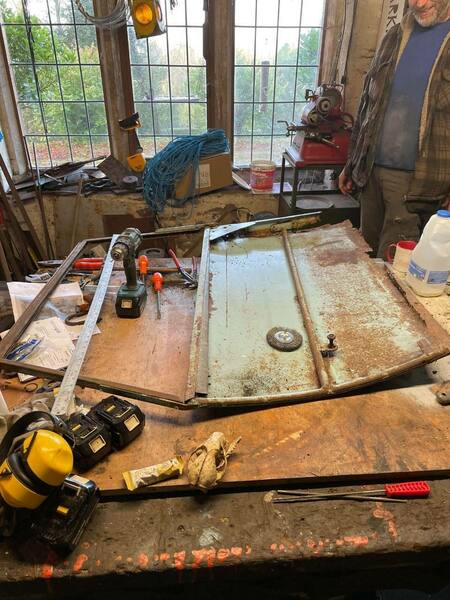

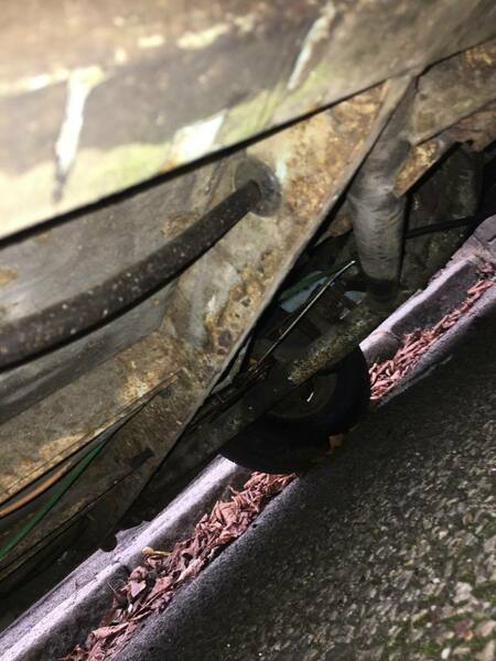

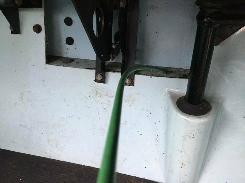

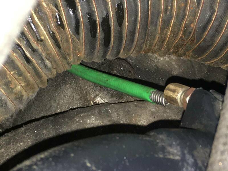

LightBulbFun Posted December 16, 2021 Author Posted December 16, 2021 went to do a bit more work on REV, but sadly was not able to get much done (which is quite frustrating as its very painful for me to make these outings, so id like to have at least got my moneys worth out of the pain!) found a good looking washer but pretty quickly realised that it was not going to work as the bobbin at the end would not pass through the hole (id have to pull the entire inner out and thread it through the washer first) and then I noticed at the carb end the throttle cable outer had actually come away from ferrule on that end, so that cant be helping things! I then had a look at the routing of the cable (if I pulled the outer into the cabin I could pull this bent bit straight) I also noticed the cable was coming out of the right hand hole in the bulkhead rather then the left hand hole like it does on most other Model 70's but I seem to recall we moved it to the right hand hole at the FoD to try and make it smoother, and indeed when I moved it to the left hand hole it got even stiffer!
Crackers Posted December 16, 2021 Posted December 16, 2021 1 hour ago, LightBulbFun said: That bend halfway through the cable run won't be helping matters. Looks too long. LightBulbFun 1
LightBulbFun Posted December 16, 2021 Author Posted December 16, 2021 16 minutes ago, Crackers said: That bend halfway through the cable run won't be helping matters. Looks too long. yeah I have a feeling the cable is a bit too long given the slack it has If I pull on the cable I can straighten it out but then all the slack is just moved to the cabin and if I push the slack out of the cabin it bends along the run as you see I have thought about shortening it but not sure how exactly to go about shorting the outer, especially seeing as the carb end has pulled out of the the threaded ferrule, which im not quite sure how to handle in and of itself (and there is still the overarching question of is it even run properly)
Mr Pastry Posted December 16, 2021 Posted December 16, 2021 Re. washer. You can cut a slit in the washer to pass it over the inner cable, and the washer will then fit over the shouldered end of the outer cable, which I take it is the requirement. Just needs a saw cut. Then what happens at the carb end? How does the inner cable attach to the throttle lever? It looks like it just wants pulling through a bit further. LightBulbFun and adw1977 2
