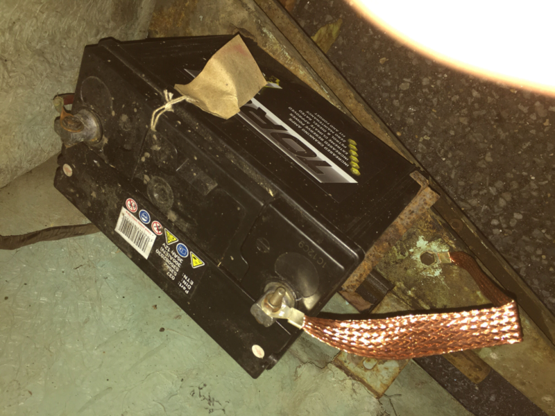

LightBulbFun Posted November 15, 2021 Author Posted November 15, 2021 was not able to install the fuel pump sadly as the fuel hose ID is 5Mm but the barbs are for 8Mm ID pipe so theres no way they where going to fit sadly, ill have to figure something out there (I dont have any 8Mm fuel pipe or any reducers etc to hand sadly) but I was able to replace REV's battery earth/ground strap it is a bit disconcerting that it took me about 1 and a half to 2 hours to do a job which would probably take anyone else about 15 minutes! (mind as @Zelandeth has mentioned in his posts the lack of captive nuts is a right bastard to deal with, tho even if there where captive nuts, knowing my luck they would all snap their welds anyway!) its safe to say her old one was indeed a bit past it! with many broken strands on the left side terminal and finally have a bonus picture of Morris as he was when I came through the door LOL Mrs6C, auntiemaryscanary, EightMegs and 4 others 7
Mrs6C Posted November 15, 2021 Posted November 15, 2021 6 minutes ago, LightBulbFun said: I was able to replace REV's battery ground/earth strap Hey, well done you!!! LightBulbFun 1

LightBulbFun Posted November 15, 2021 Author Posted November 15, 2021 2 hours ago, Mrs6C said: Hey, well done you!!! thanks! although im not pleased it took so long and that it was so knackering for me for what is such a simple Job, I do admit at the end I was quite pleased with the end result and that I was actually able to pull it off in the end! was nice looking down at the shiny new part I had just installed 26 minutes ago, bobdisk said: @LightBulbFun The NSU's pump had 2 of the black adaptors, and did not have a larger "filter" thingy. As @Noel Tidybeard says, they are a tapered thread, so that they will seal a liquid without screwing it forcefully in. An extra seal would be to wrap some PTFE tape around the threads. Look at the complete pumps connections in the pic with the Ford engine. ah cool thats good to know 23 minutes ago, bobdisk said: @Dobloseven and @LightBulbFun Blow through it. If it is a one way valve, you will only blow in one direction. in the case of mine I can blow through it in both directions easily so Im guessing it is some sort of filter in this case auntiemaryscanary and Mrs6C 2
