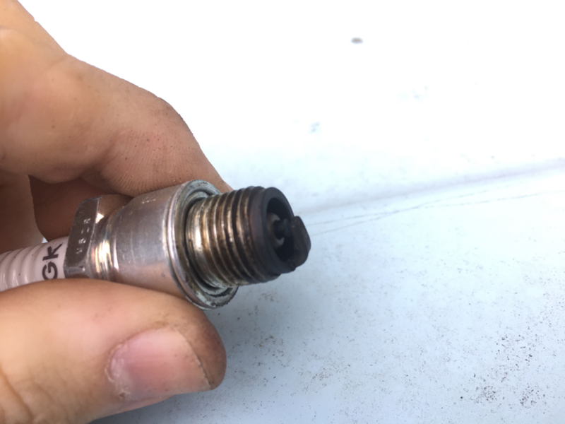

LightBulbFun Posted November 9, 2021 Author Posted November 9, 2021 2 hours ago, dollywobbler said: Wow, I'm well behind here. Exciting times! Really pleased for you. Thanks! tis indeed quite exciting! although also I will say quite frustrating (not at REV, she cant help it, she clearly did not quite get the work done I thought she had done but frustrated at the situation in general) I had really hoped to have been able to take her for a drive to my local chippy by now! and im also quite worried, because stuff like the door issues I am not sure I can solve from home, but we will see! (I can see myself revisiting early parts of Project TWC soon!) I mean I know its a 45 year old car, so expect issues, just did not expect so many so soon LOL 2 hours ago, dollywobbler said: Wiper blades - you can indeed buy Mini 10" blades online. I did recently for my 2CV. Pretty sure TWC is running a larger blade than that. 11 maybe? ah good to know most of the Mini blades I came across on my brief search where curved to match the windscreen I presume those wont work!, Im guessing the flat ones would bend to fit the curve of the windscreen when used on a mini? I did come across an 11 inch blade and did wonder if that would fit (and give me a bit of extra cleared space) good to know it might work 2 hours ago, dollywobbler said: Another tip I'll give is that blind spot mirrors are a massive help. Rearward visibility, especially over the shoulder, is hopeless in an Invacar. Try these. https://www.ebay.co.uk/itm/164805129077 I've got one on the interior mirror and another on the external mirror. I feel so much more confident that I know what's about me now. (did 130 miles in TWC yesterday!). ooh good to have a link yeah will be interesting to see how I get on with that aspect of things, I am glad I have nearside mirror as well as that will be needed for spotting cyclists and the like who decide "ooh he is turning left I know I will undertake him to go straight on and hope he has noclip turned on" LOL and yeah im quite looking forward to the videos of her recent adventure, very pleased to see her out and about after being dormant for sometime 2 hours ago, dollywobbler said: As others have said, I doubt the over-filled oil has done any damage. If it was run at speed and chucked around a bit then yes, the crank could have hit the oil and frothed it up a treat, but I doubt that happened. Good luck getting it started again - TWC likes a lot of choke to get started, though I have to then back it off a bit once she's caught. yeah glad to hear the general consensus is that she will be alright from the over-filled oil! am starting to think I should have also got myself a can of easy start or something such to make my life a bit easier! hopefully ill be able to get something done today, im up nice and early (thanks to the post man LOL but I have my Jug of 20W50 now , surprisingly heavy LOL) so hopefully Ill have a bit more daylight to play with etc!
Crackers Posted November 9, 2021 Posted November 9, 2021 2 hours ago, LightBulbFun said: am starting to think I should have also got myself a can of easy start or something such to make my life a bit easier! You shouldn't need it, check that the choke is operating properly. You may remember a seized choke cable prevented the choke on my P6 working properly. As a test, you can rig up some cable ties to hold the choke in fully on the carb itself, removing the rest of the mechanism from the equation, to see if it will then start. If that's already been covered, then ignore me, I haven't read the thread in full. LightBulbFun 1
LightBulbFun Posted November 9, 2021 Author Posted November 9, 2021 2 hours ago, Crackers said: You shouldn't need it, check that the choke is operating properly. You may remember a seized choke cable prevented the choke on my P6 working properly. As a test, you can rig up some cable ties to hold the choke in fully on the carb itself, removing the rest of the mechanism from the equation, to see if it will then start. If that's already been covered, then ignore me, I haven't read the thread in full. Yeah I know I really should not need it, but I have the same problem here she developed a sized choke cable, which was disconnected from the carb (but helpfully* not something I was told about until yesterday) (or maybe sized choke control im not sure which, Adam says cable, but I can see the controls sizing as well, its very difficult to move but that like wise could be the sized cable) I do very much appreciate the advice I had another go today with the jump pack and pumping the throttle but no luck sadly, the Jump pack does its thing, so, im pleased about that, but no signs of life at all ignition wise I think really need a 2nd pair of eyes and hands so someone can crank her over while someone checks in the engine bay to see if we are getting spark and fuel and to operate the choke on the carb I may try again later today or tomorrow depending how I feel bringing with me a pice of string to tie to the choke lever on the carb and tie somewhere else or bring into the cabin for me to pull on (id of done it today but I got sidetracked by more important other things) heres some photos from today, heres the whole roller setup for @Mrs6C and anyone else wondering, here it was just about to fall off, but I was able to catch it before it did and then push it back on the rail, curiously the bobbin roller here is on the bottom rather then the top as it is in the workshop manual (I did manage to give most of the sliding surfaces a liberal spraying with some white lithium grease which has helped getting the door to slide smoothly so it does not bind up and then fall off) and I also took out one of the spark plugs, looking quite dark but not pitch black, not sure what to make of it exactly but id say she was running a bit rich when she did run in the past (or was not run up to temp)? (but I dont know if its to the point where they have been fowled up and now wont fire?)

Mr Pastry Posted November 9, 2021 Posted November 9, 2021 That plug looks dry to me, i.e. not enough fuel getting through so you need to get that choke working. The soot on the plug is about what you would expect from cold/slow running, and the insulator in fact looks clean so I wouldn't worry too much about that. As said, you could do with a second pair of hands/eyes - surely there must be somebody within range? I'd gladly assist but I am 200 miles away. LightBulbFun 1

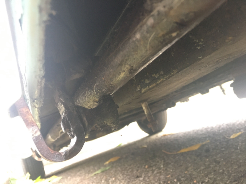

Noel Tidybeard Posted November 10, 2021 Posted November 10, 2021 i would be inclined to believe the rollers for the door are the wrong way round and the bobbin should be at the top LightBulbFun 1
bobdisk Posted November 10, 2021 Posted November 10, 2021 @LightBulbFun, Yes definitely, that roller must be on top of the rail. Look at the other door. Try to get RoverSD1 (made contact yet?) man to help you lift the door back up, it wont stay in place like that. It could even come off while you are driving along. LightBulbFun 1
Dobloseven Posted November 10, 2021 Posted November 10, 2021 1 hour ago, bobdisk said: @LightBulbFun, Yes definitely, that roller must be on top of the rail. Look at the other door. Try to get RoverSD1 (made contact yet?) man to help you lift the door back up, it wont stay in place like that. It could even come off while you are driving along. Agreed, looking at the "workshop manual" photo, there seems to be a stop below the roller. On LBFs photo, I can just about see the stop on top of the rail. How on earth would they swap places though? One good thing, it all seems to be "shed technology"! Getting quite interested in this, am old enough to remember when they were regular sights on the road. LightBulbFun 1
LightBulbFun Posted November 10, 2021 Author Posted November 10, 2021 Yeah thats what I thought, ill check the other roller set on the door and check the other 2 roller sets on the other door as well and dont worry after I took the picture, I gave the door a good shove so it fell back onto the rail properly (and when the door is closed its latched to the bodywork so I dont think its at risk of falling off when on the move, but yeah that could be quite exciting!) I just took that picture to show the exact failure mode if that makes sense! here is the workshop manual for those interested at following along at home so to speak DHSS Workshop Manual For The Model 70 Three Wheeler(OCR).pdf
Noel Tidybeard Posted November 10, 2021 Posted November 10, 2021 just looked at the manuel and your door rollers are deffo wrong way round somewhatfoolish and LightBulbFun 2
