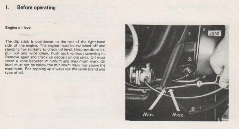

LightBulbFun Posted November 7, 2021 Author Posted November 7, 2021 now this is interesting, I always thought you checked the engine oil on the Model 70's Steyr puch engine by unscrewing and pulling out the dip stick wiping it clean putting it back in, screwing it down then un screwing and pulling it back out and checking the level but after carefully reading the workshop manual it turns out your only supposed to put it in but not screw it all the way home when simply checking the level it is worth noting however, I did check the oil level this way a couple times back early today (just incase perhaps this is how Adam did it and maybe thats why I was reading an overfull level?) but it still read way above maximum so I know that its not just me checking the oil incorrectly sadly but I do wonder now if I have accidentally drained off a bit too much oil, ill have to check in the morning/afternoon of course but I think ill order some 20W50 to be safe incase I need to top her back up (in-fact giving her another oil change in general probably would not be a bad idea!) (I also wonder how everyone else has been doing it! is this a common mistake to make with Steyr puch engines or was/is it just me LOL) Six-cylinder and Mrs6C 2
mitsisigma01 Posted November 7, 2021 Posted November 7, 2021 Looking at the colour of the oil it could probably do with a change anyway and plenty more in the future LightBulbFun 1
AdgeCutler Posted November 7, 2021 Posted November 7, 2021 I'm unsure what people are seeing with this dirty oil, looks fresh to me? Glad to see that REV is now at home with you Dez and look forward to seeing more about her. LightBulbFun 1
LightBulbFun Posted November 7, 2021 Author Posted November 7, 2021 alright report for today oil level is still good when checked correctly (about half way between min and max) and she does build oil pressure (at least the oil pressure light goes out!) when cranking over so thats good I noticed Adam put the warning lights back to their factory configuration, previously in REV's life at some point they had been altered as to which light indicated what, so thats good to know, I mean I personally preferred it the non-factory way since I think having green as a Low oil pressure warning light is a bit daft but I digress LOL however she sadly refused to fire, and then the battery decided it had enough, however just before packing up shop tho I did quickly check and the horn and all the indicators are working now tho which is good I did noticed that the inline fuel filter installed at the FoD is looking quite empty wonder if she is struggling to draw fuel through or if it just empties itself out once you stop cranking (wish I had a 2nd set of eyes/hands so I could have seen what was going while she was turning over) I did try the neighbour with the SD1 but no signs of life there sadly, wonder if they are away for the weekend! so now Im going to have to figure out how im going to put some more juice into the battery when I dont have a jump pack or any way to charge it up! (I mean have a DC bench top power supply I could charge it from, but I dont think I have the strength/ability to drag her battery all the way up to the flat!) guess ill have to get a Jump pack ASAP, if anyone has any good recommendations do let me know (oh and for good messure the door fell off again so that was "fun" its in dire need of some TLC/adjustment I think!) I also noticed the wrong type of fuel sender has been fitted, so the fuel gauge does not work sadly (but I did manually check and she has petrol!) there are 3 different types of Gauge and Sender unit depending on which Age of Model 70 you have fitted or if its been fitted with a post production Veglia fuel gauge and she has a later production Smiths fuel gauge but Adam fitted her with a Veglia Fuel sender unit... (but I think at least the fuel sender unit that is with her original holed fuel tank did still work so hopefully that can be fitted to the new tank at some point, the mountings are the same thankfully!) Mrs6C 1

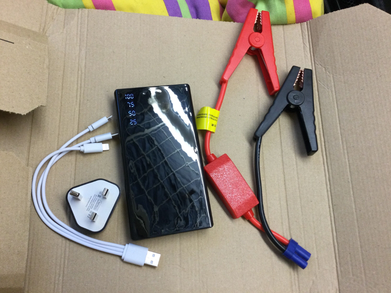

Mrcento Posted November 7, 2021 Posted November 7, 2021 Lidl are going to have jump packs, jump leads and chargers in from the 14th (if that's any use). Jump packs are excellent, but worth noting they aren't really the best thing for older engines with carbs etc that take a bit more cranking, they're better suited to a big short sharp jolt on a modern fuel injected engine. But i'm sure it wouldn't have much bother turning an engine that small over for a bit longer. LightBulbFun 1
Jikovron Posted November 7, 2021 Posted November 7, 2021 I've used a 4 amp/hr 18v drill battery on an ancient 1200cc engine it definitely works but even so a knackered old lead battery is going to be hopeless in the longer term,,a nice fresh bog standard battery kept in rude health would be the way forward with this imo LightBulbFun 1
LightBulbFun Posted November 7, 2021 Author Posted November 7, 2021 Just ordered myself a cheap n cheerful jump pack from Amazon which should hopefully be here tomorrow, should hopefully be good enough for a 493cc engine and Dynastart LOL battery is new according to Adam so thats good, just a bit flat clearly! (perhaps due to the aforementioned charging fault REV apparently developed on her last test drive up in york, but I have still yet to get the full details on that) but apparently she also developed a sized choke cable which was then disconnected from the carb, which I was not told about! so that hopefully explains why she would not start (and why I could not seem to find a choke cable going to carb!) but not sure what im going to do about said sized and disconnected choke, wonder if I can temporarily bodge something with a pice of string or such that I can pull on from inside the cabin LOL Mrcento and Mrs6C 2

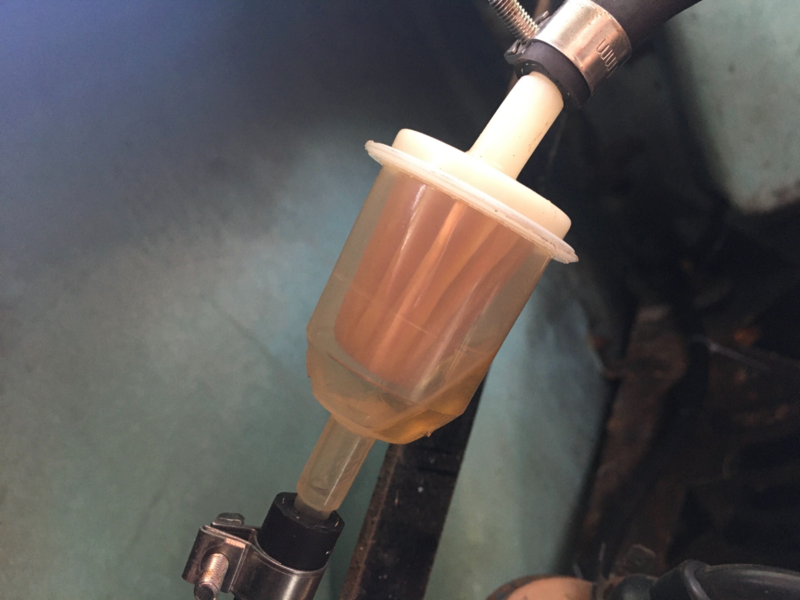

Zelandeth Posted November 8, 2021 Posted November 8, 2021 For the oil I'd be checking if it strongly smells of petrol. If the diaphragm in the fuel pump has failed it will allow fuel to drain into the sump. It is very easy to overfill though, so basically keep a close eye on the level. If it seems to increase over time that'll be why. Service kit for the pump was available when I last looked. Having switched to the electric pump I never bothered sorting mine though. Far better starting performance was one of the reasons I stuck with the electric pump. Means I can just give the throttle a couple of pumps and she will go. TPA usually only has the choke on literally for about a minute - though the disclaimer there is that she does live in a relatively warm garage. If it's been overfilled to the point oil may have got into the cylinders she may have fouled plugs that will need to be cleaned or replaced. Unlikely that any permanent damage has been done though. Definitely will be wanting a few oil changes in pretty quick succession though judging from how dark that oil is. There should be clamps on the door runner tubes to stop the doors being able to roll all the way off the end. As far as the battery is concerned, I did find that on TPA I have had to charge it a couple of times as the charging system only really wakes up fully when you're at speed, so if you're driving around town a lot, especially after dark that's something you'll need to keep an eye on. Also disclaimer, I've never looked at whether there's any scope for adjustment of the voltage regulator. LightBulbFun 1
LightBulbFun Posted November 8, 2021 Author Posted November 8, 2021 On 08/11/2021 at 00:57, Zelandeth said: For the oil I'd be checking if it strongly smells of petrol. If the diaphragm in the fuel pump has failed it will allow fuel to drain into the sump. It is very easy to overfill though, so basically keep a close eye on the level. If it seems to increase over time that'll be why. Service kit for the pump was available when I last looked. Having switched to the electric pump I never bothered sorting mine though. Far better starting performance was one of the reasons I stuck with the electric pump. Means I can just give the throttle a couple of pumps and she will go. TPA usually only has the choke on literally for about a minute - though the disclaimer there is that she does live in a relatively warm garage. Expand Yeah Adam also wondered the same about the fuel pump and oil, however I dont recall the oil smelling strongly of petrol, but ill do a comparison next time im there but if It did turn out I had a knackered fuel pump then yeah id probably look at just duplicating your electric setup as I know it clearly works well (and I think would be easier to fit then faff about trying to remove then rebuild/replace the mechanical pump, but thats not something I have looked that deeply into) On 08/11/2021 at 00:57, Zelandeth said: If it's been overfilled to the point oil may have got into the cylinders she may have fouled plugs that will need to be cleaned or replaced. Unlikely that any permanent damage has been done though. Definitely will be wanting a few oil changes in pretty quick succession though judging from how dark that oil is. Expand Yeah its very much on the list of things to do, (and drop the oil strainer somehow...) I placed an order for a 5L bottle of 20W50 the other night which is saying will be here by Tuesday hopefully but on that subject of the things that concerns me a little bit is the oil filter that was installed recently, I noticed is a Mann W712/43, but the Steyr puch engine of this age calls for a W712 (no suffix numbers) so id like to know exactly what this /43 means compared to a regular W712... On 08/11/2021 at 00:57, Zelandeth said: As far as the battery is concerned, I did find that on TPA I have had to charge it a couple of times as the charging system only really wakes up fully when you're at speed, so if you're driving around town a lot, especially after dark that's something you'll need to keep an eye on. Also disclaimer, I've never looked at whether there's any scope for adjustment of the voltage regulator Expand Yeah I have realised I really need to figure something out to keep her battery topped up... anyone got any spare solar panels? LOL

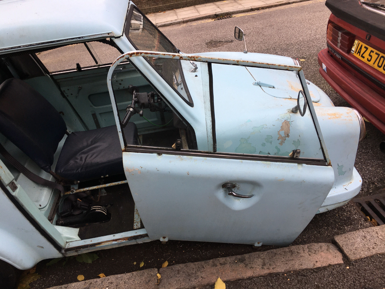

bobdisk Posted November 8, 2021 Posted November 8, 2021 @LightBulbFun Comparing the doors manual pic and the "fell off" pic, could it be that one of the rollers ends has worn away, making it almost a tube shape instead of a cotton reel shape. So it will keep on falling off. A temporary fix could be to put it on the other way around, so that the largest diameter is towards the inside of the car, over the tubular rail, away from the door. As in the pic. Also, make sure it is not stuck and turns on the mounting screw. That one and probably all will have to be replaced because of wear. LightBulbFun 1
dave j Posted November 8, 2021 Posted November 8, 2021 As a temporary "workaround" can you use the door on the other side instead? Good to see it home, but not so good that you haven't been able to go for a drive yet LightBulbFun 1
LightBulbFun Posted November 8, 2021 Author Posted November 8, 2021 On 08/11/2021 at 07:08, bobdisk said: @LightBulbFun Comparing the doors manual pic and the "fell off" pic, could it be that one of the rollers ends has worn away, making it almost a tube shape instead of a cotton reel shape. So it will keep on falling off. A temporary fix could be to put it on the other way around, so that the largest diameter is towards the inside of the car, over the tubular rail, away from the door. As in the pic. Also, make sure it is not stuck and turns on the mounting screw. That one and probably all will have to be replaced because of wear. Expand indeed Im pretty sure thats whats happened although I still recall the roller looking pretty roller shaped, but the gap only has to open up a bit for it to fall off I think On 08/11/2021 at 08:41, dave j said: As a temporary "workaround" can you use the door on the other side instead? Good to see it home, but not so good that you haven't been able to go for a drive yet Expand I would, in fact the other door is the one id prefer to use as not only does it just work much better then the door that keeps falling off (it rolls easier and is easier to close) but its also the nearside door, so would allow to me get in and out of the car without having to go into moving traffic and thats generally the door the Ministry recommended people use (if you notice all single door Villiers machines only had a door on the nearside generally) but the problem with that door is the door handle is not very secure, one of its screws has gone missing and I think the other one is not far behind, so im reluctant to use that door in fear of pulling the door handle completely out of the door! Amazon is saying the Jump pack will be here between 2:45-5:45, hopefully the former while I still have some daylight to do things! I also ordered an oil filter since it was only £5.86 figured would be good to have on hand for when I do a full oil change (I mean I do know I have a pile of the things but there about 50 miles away from me LOL) but speaking of service items @Zelandeth do you have a link to the windscreen wiper you got for TPA? I notice REV still has her utterly knackered one installed so id obviously like to replace that! and I know the one you got works well and is shiny and chrome
