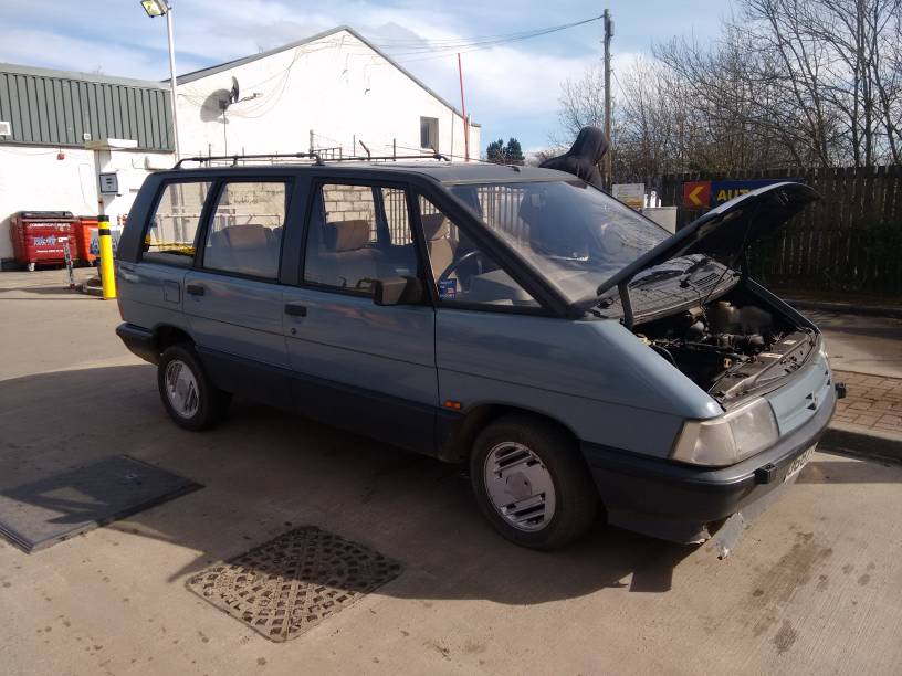

I'm taking a look at this today- the guy is bringing it into central London as part of its van duties. I doubt I'll get much of a chance to drive it due to central London, so what should I look out for?
I'm keen on something that I can fit my scooter into and can be insured on a classic policy.
Something about this makes me wary, I think I've got it in my head that it would be fragile and parts would be a nightmare.

Just had a look and a drive of this- a pretty solid and scruffy old thing.
The most alarming thing was a drivers seat that was barely attached, swaying around like crazy with any driving input..

The seats are supposed to swivel, are they not, so perhaps your wander chair just needs a bolt or something adding to stop it swivelling when driving...
