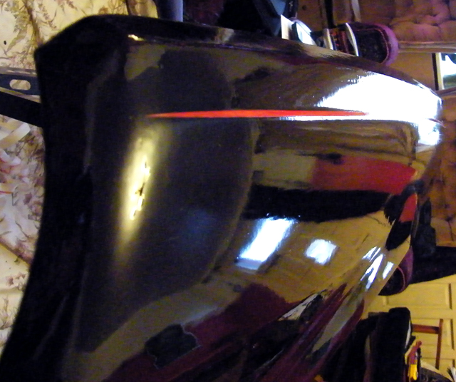

Where did you get that paint from and how well does it go on? I'm just starting to look at paint for my 1100 and trying to decide which way to go.
Ebay or any argicultural merchants/ tractor spares place, goes on well with a brush or spraygun
Can second that.
That was done with a brush, before flatting back and polishing.  I miss that stupid little car.
