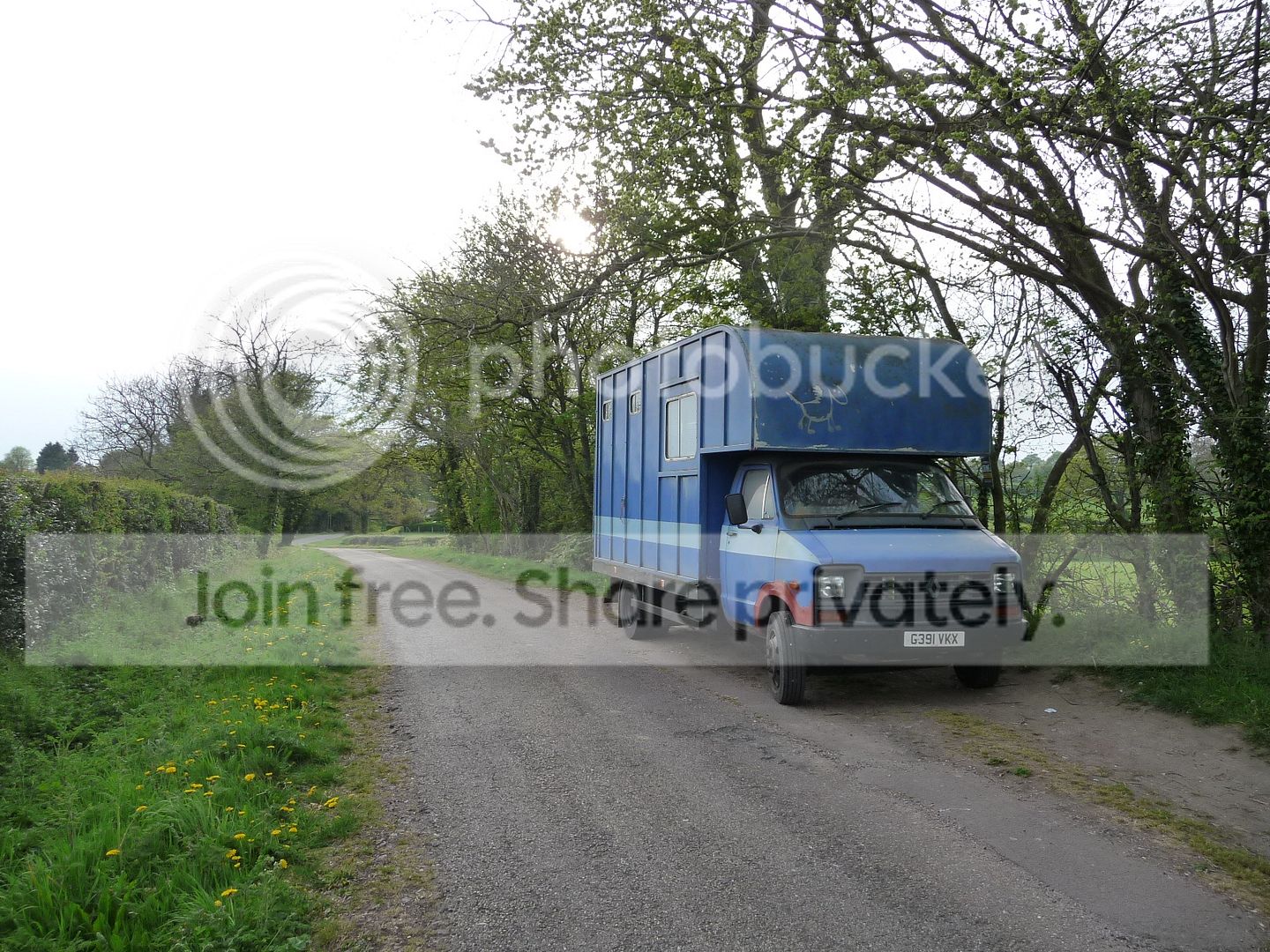

Good to see the old girl out and about, a power of work has gone on indeed! What would be cooler than parking up in a decent spot, opening the back door and having a can? Nothing on earth!
One million likes! Amazing what you can achieve when you stay off Facebook for a bit innit
This thing has been sitting on my drive looking like a flipping eyesore for about 9 months now while I sort out its general all-round knackeredness. Well yesterday I finally got it back together, turned the key and took it for an actual spin!!!! It now has a new radiator, exhaust manifold, steering coupling, oil, coolant, overhauled front suspension, new brake pads and loads of other stuff. Its still got plenty of problems but somehow seems to be lifted out of the 'fit only for scrap' category despite its appalling appearance. Will attempt to do an update of all the fettling shortly.

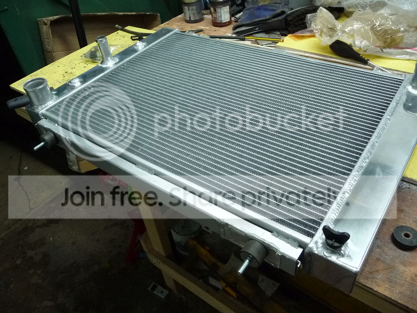

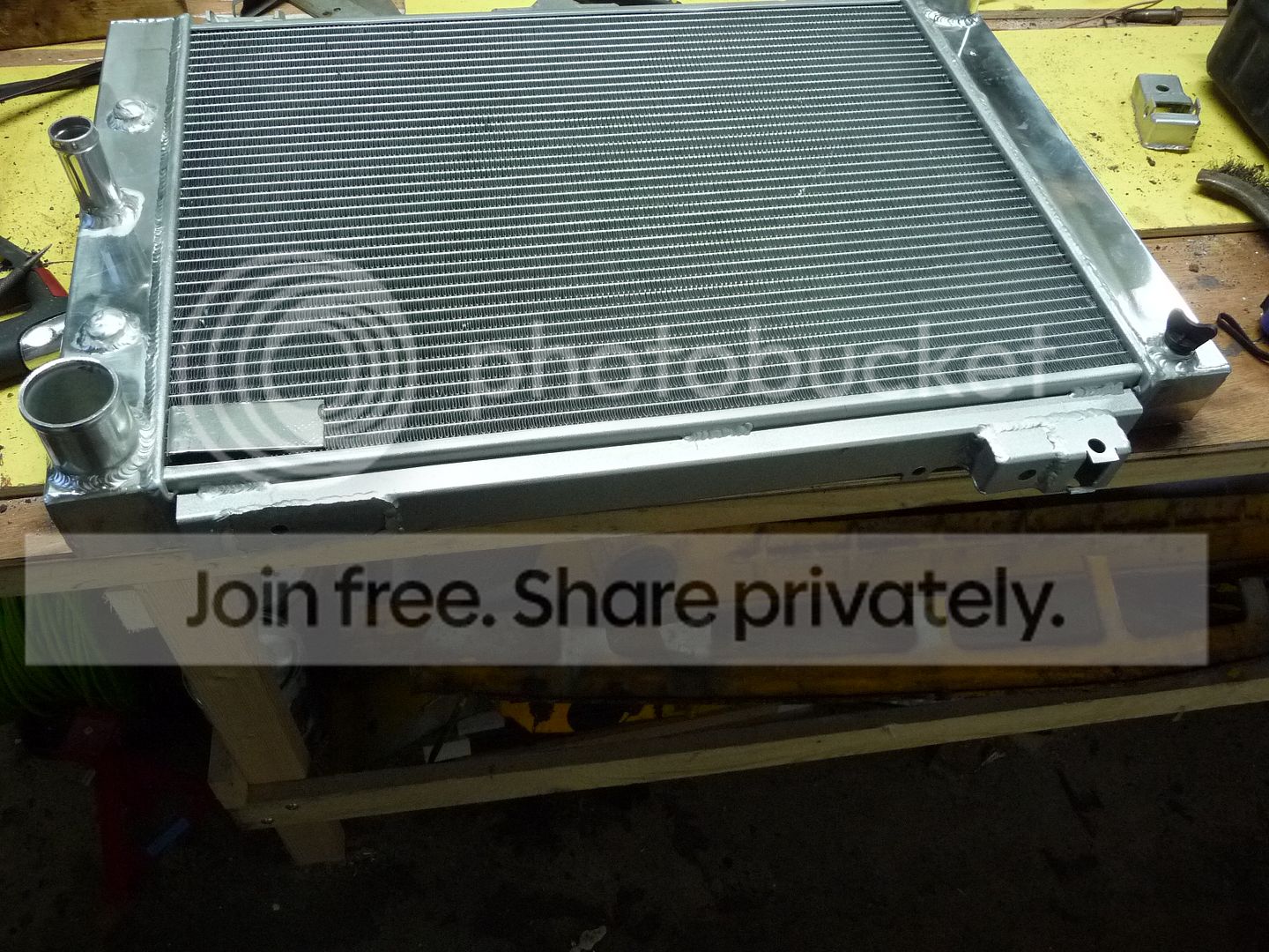

So, the radiator. It was f&&ked and recoring it ws going to cost about £300, so I had the bright idea of buying a roughly similarly-sized chinesium one off eBay for £90. But to get it installed it needed some modifying, which I farmed out to the dude up the road who does all sorts of fabricaiton and general interesting car and metalwork stuff. But he knacked his back and it took him months to get roun to doing it. Eventually i got this back:
His task was to weld two brackets on the top, add the extra 25mm pipe stub, weld up the two small ports for the transmission cooler (should have left those alone really) and add a little 10mm pipe stub on the top for the air bleed. Total cost: £40. Bargain!!! I think he did it cheap cos it had taken him like 3 months to do it.

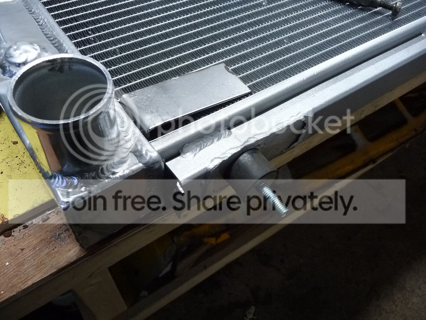

I started by slicing the lugs off the bottom:

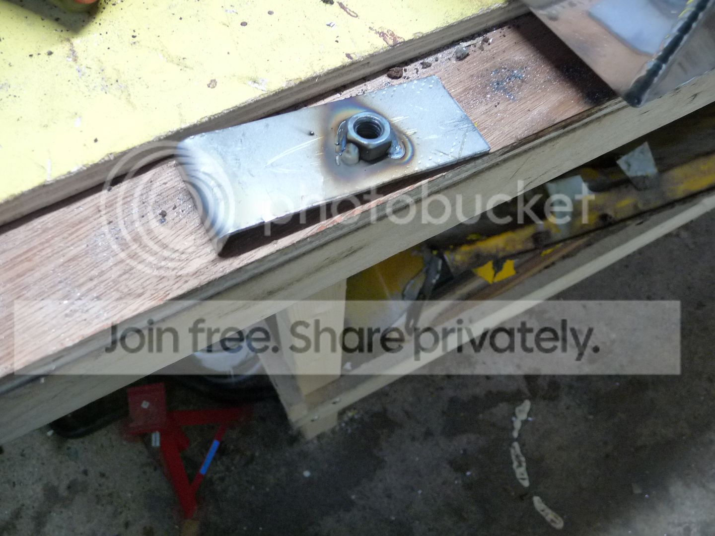

Made two little captive nut brackets that slid in from the ends:
And attached 2 rubber bobbin moiunts that I got off eBay for a few quid:
Cos I couldnt access the nut, I couldnt do these up very tight! I did my best but really I should have found some with a hexagonal plate you could get a spanner on. Anyway, onwards:

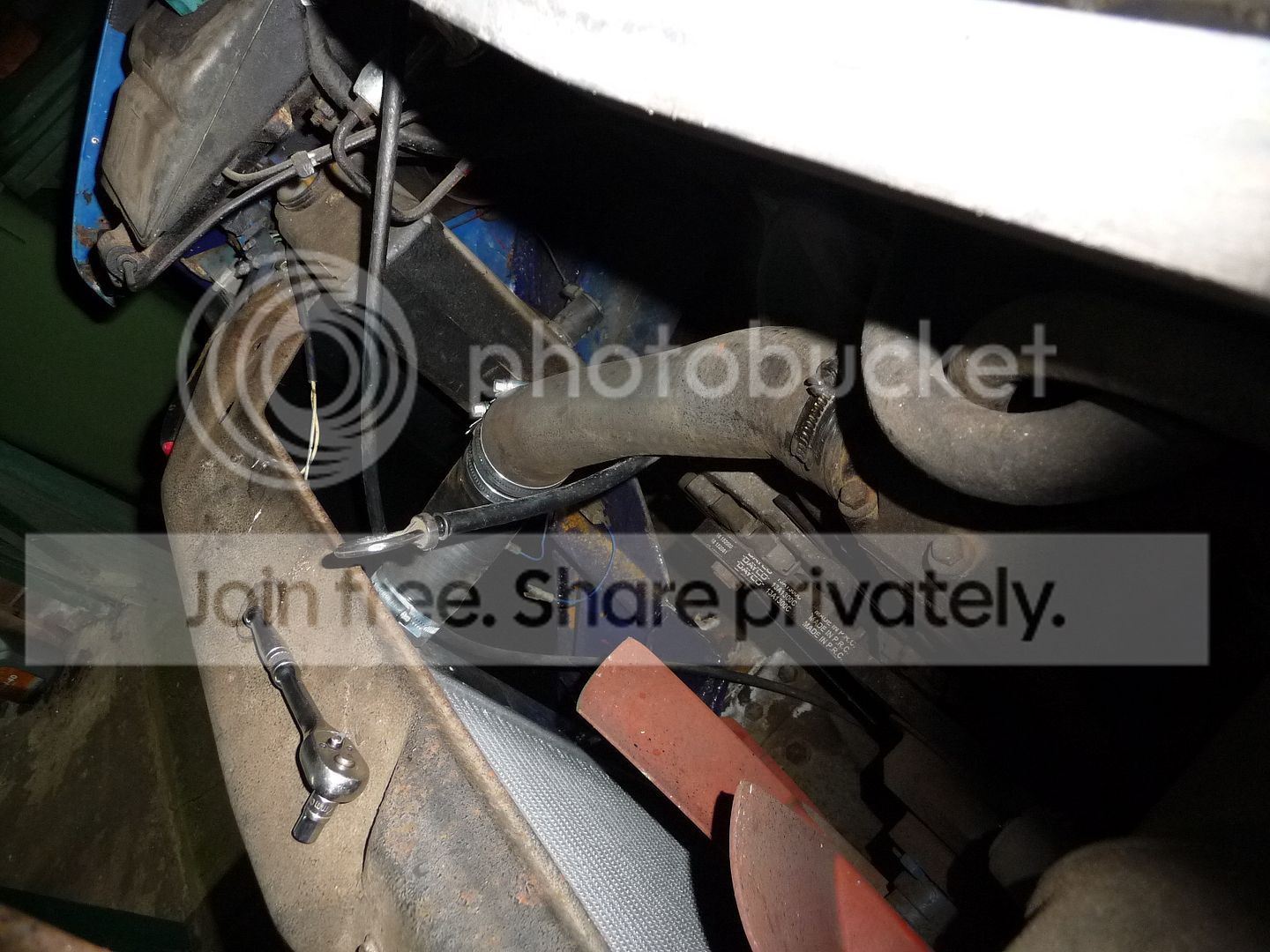

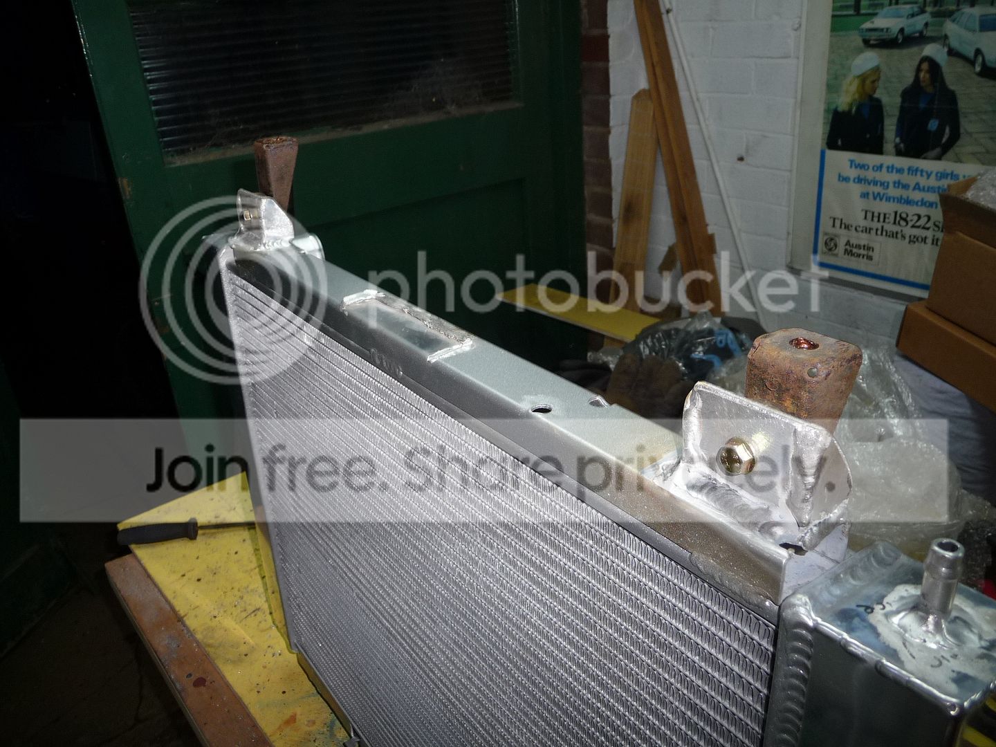

On the top edge, the guy had welded these brackets on, they were positioned to join up to the existing mounts in the front panel using the existing angle brackets:

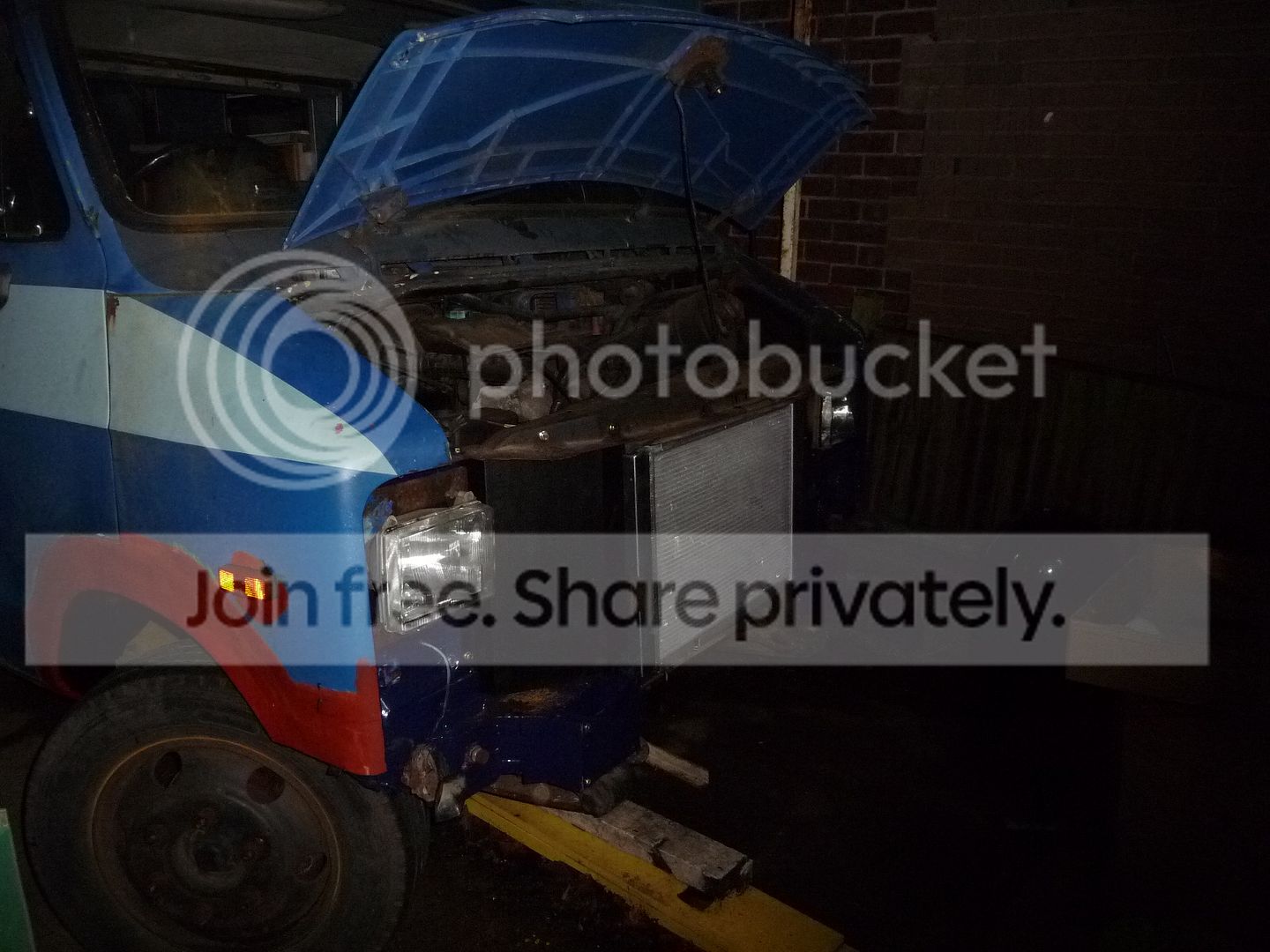

I mounted it off the top mounts, basically hanging it off the slam panel (notice my freshly painted tin shields at the side of the rad!!)

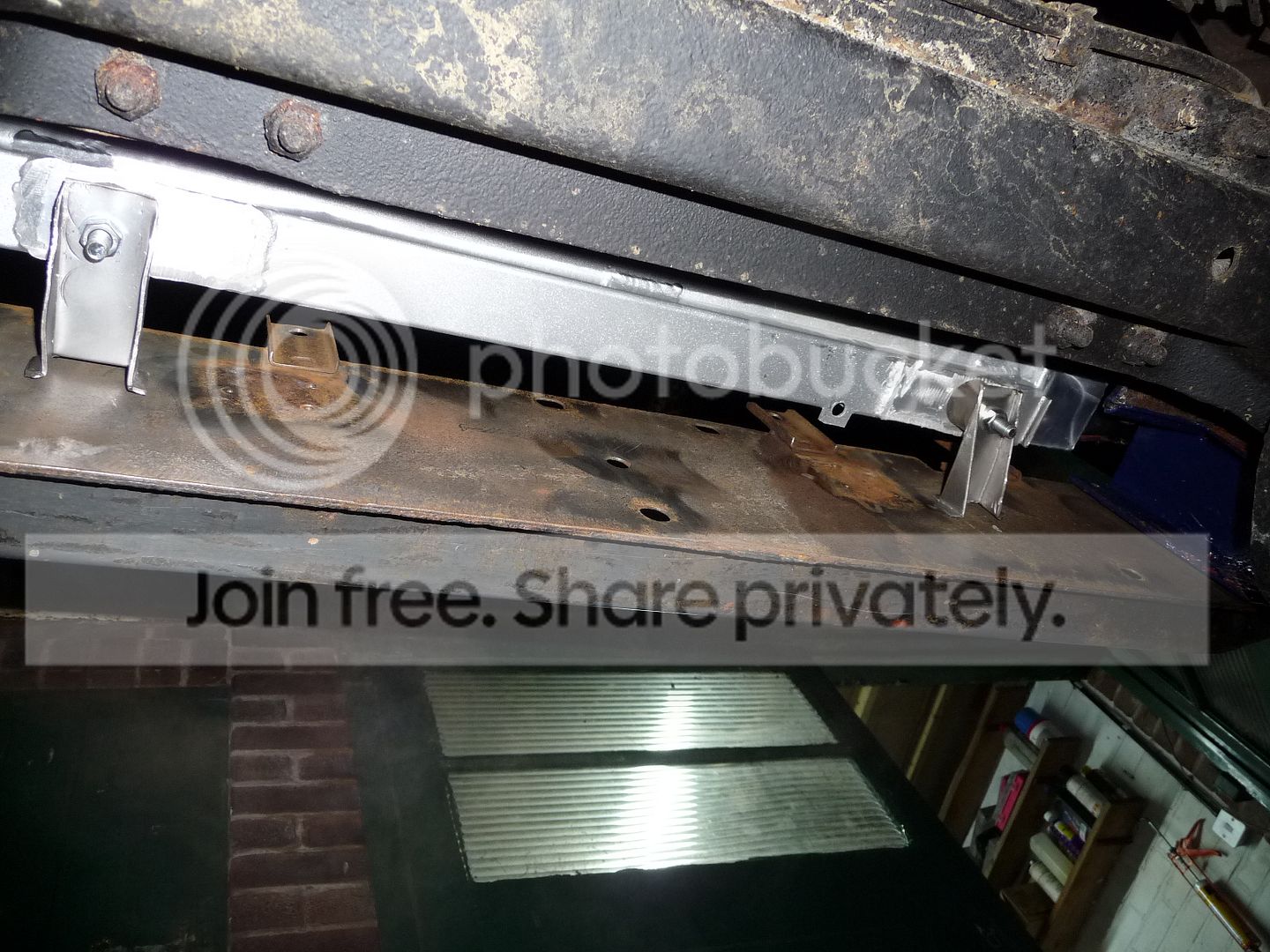

Now I had to make some angle brackets off the front crossmember that would mate up to the AV mounts on the lower edge:
Made these rather wobbly specimens out of 2mm plate, and drilled them to go on the AV mounts:

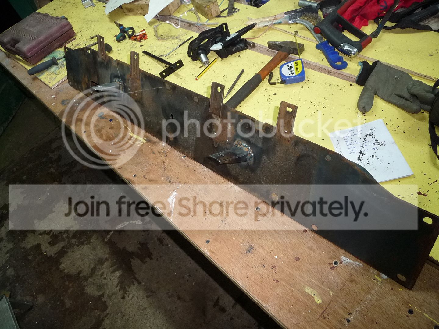

Here we're looking up and forwards at the bottom of the rad. I marked on the x-member where the angle brackets went on, and welded them int place:

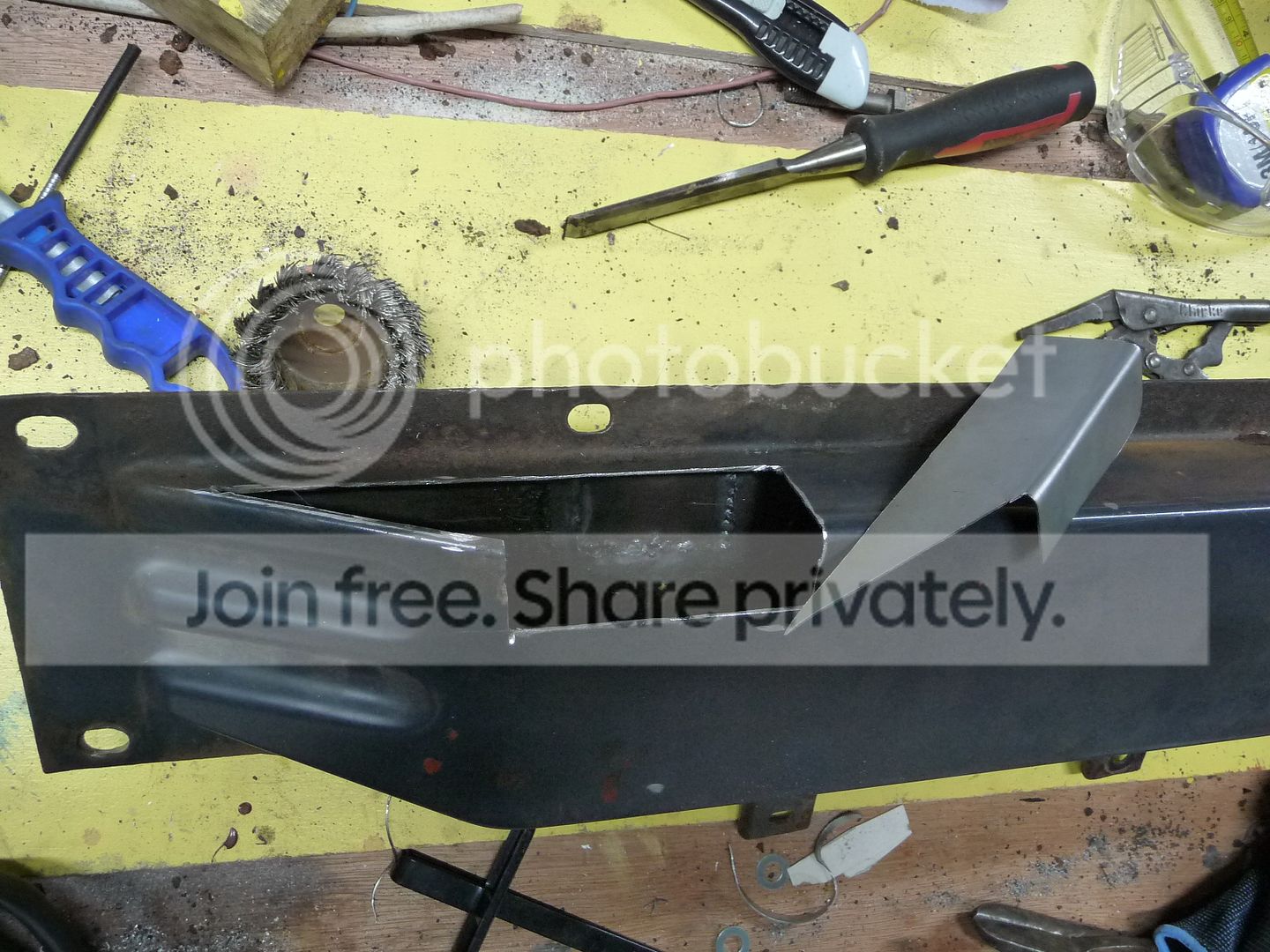

Predictably the x-member needed some localised repairs of its own:

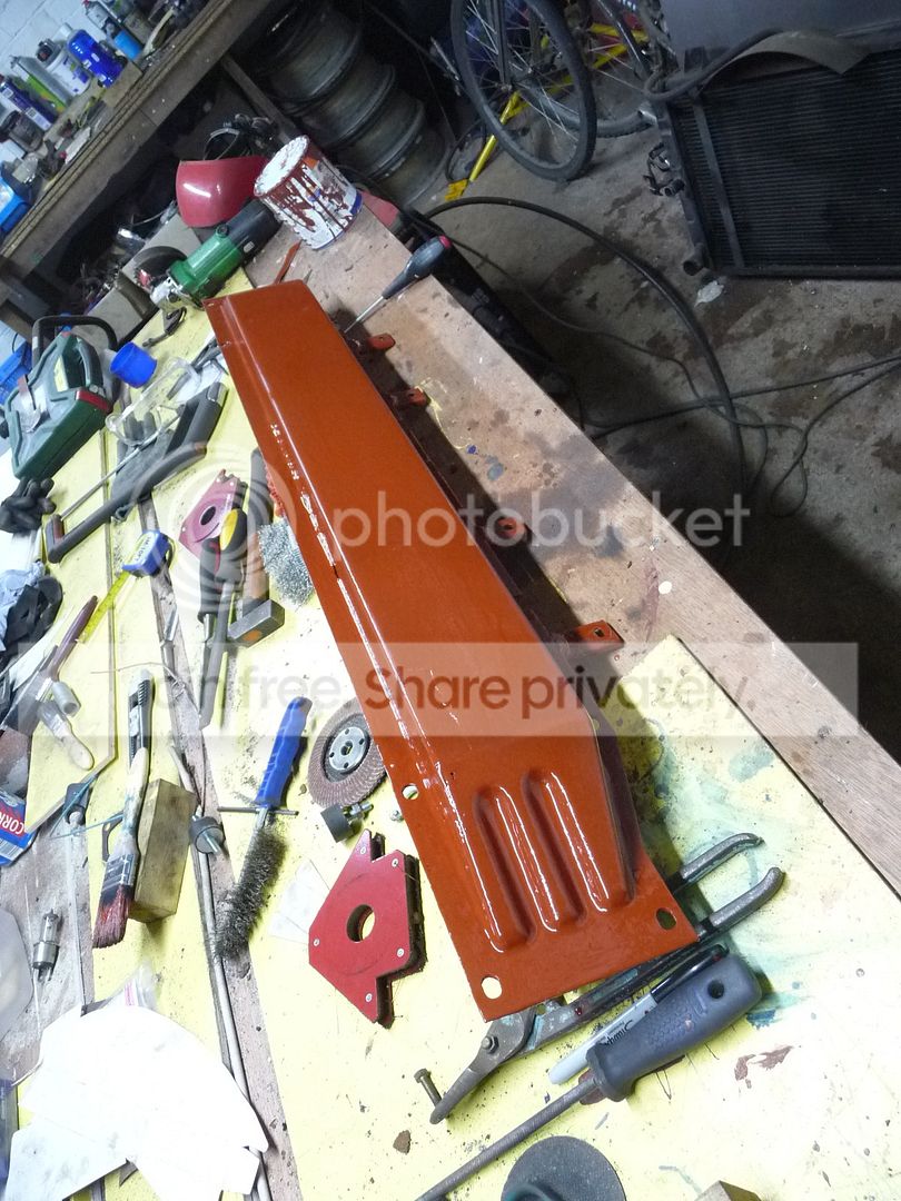

I welded it up and gave it a coat of red oxide:

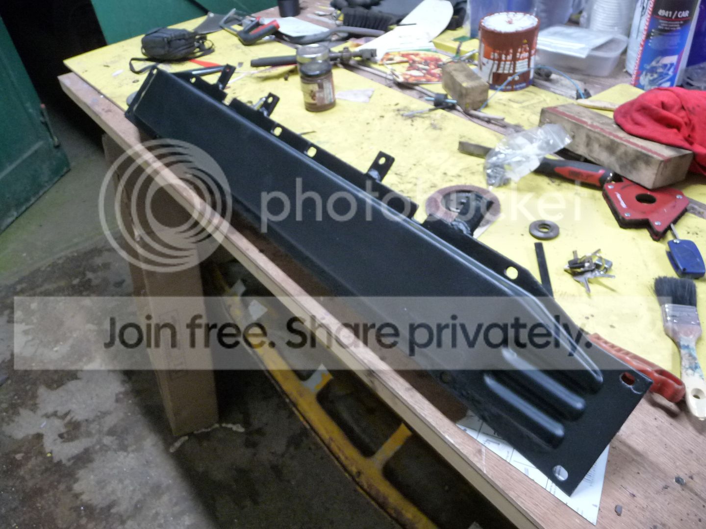

And mat black:

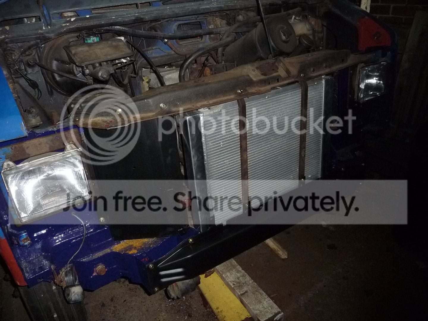

That smartened it up a treat. ON it went:

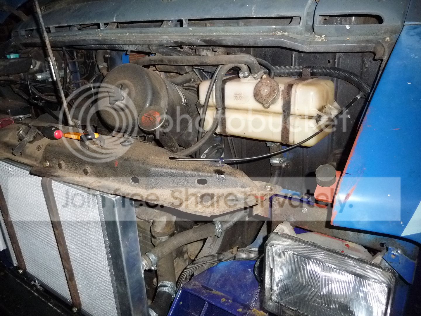

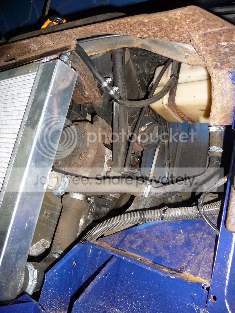

Check it out!!!! All new BZP bolts as well and I retapped all the captive nuts everywhere. went together a treat.

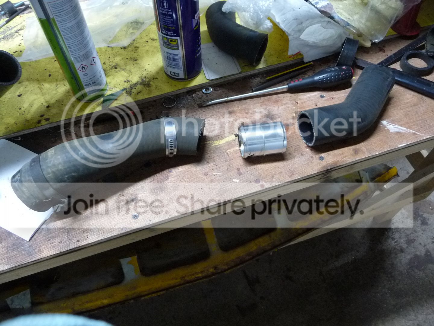

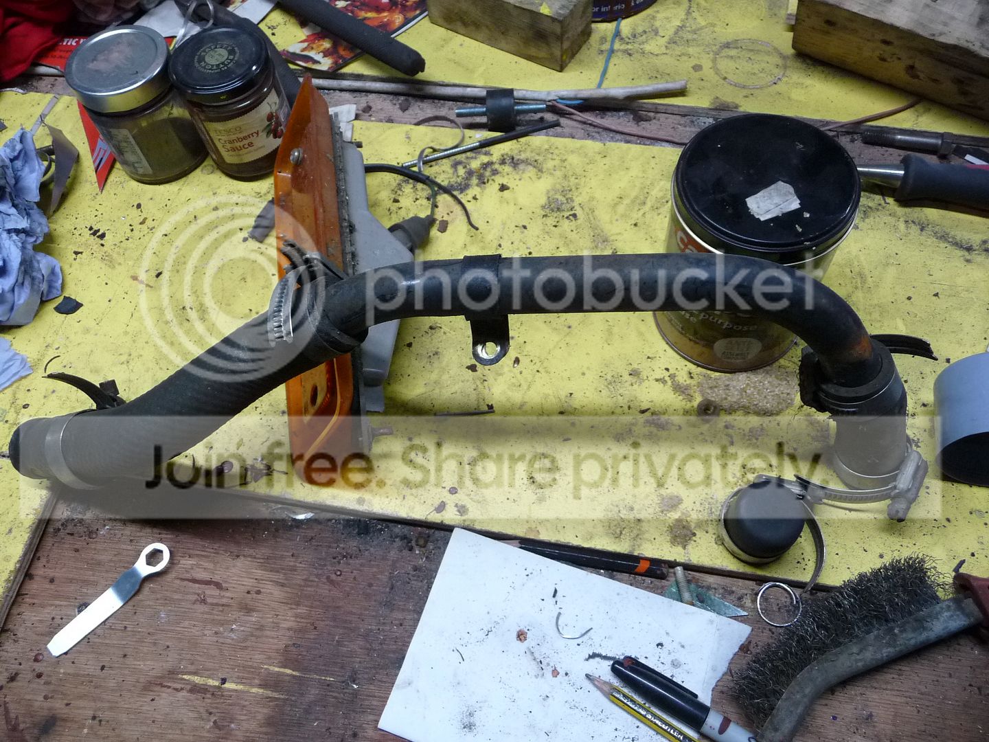

The pipe stubs on the new rad were a slightly different size to the old ones some I bought some silicone reducer hoses of about the right angle and chopped the end off the old hoses, joining the silicone ones in their place:
All new jubilee clips everywhere:

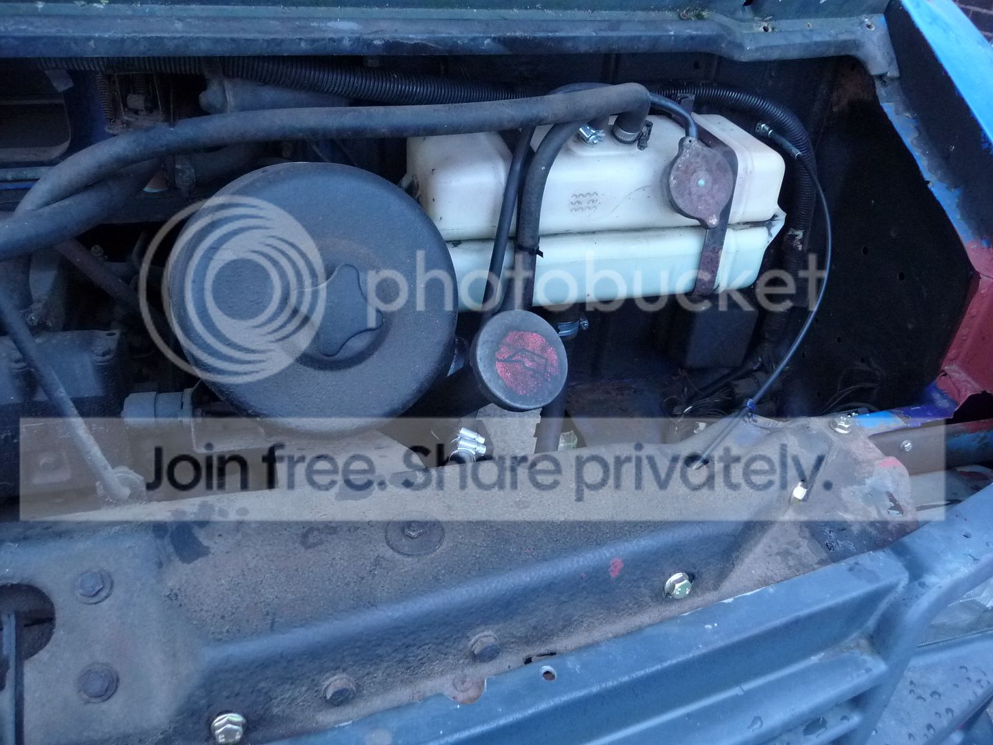

The filler tube from the expansion bottle had jubilees on theat were far too big, so I replaced all those too with brand spankers:

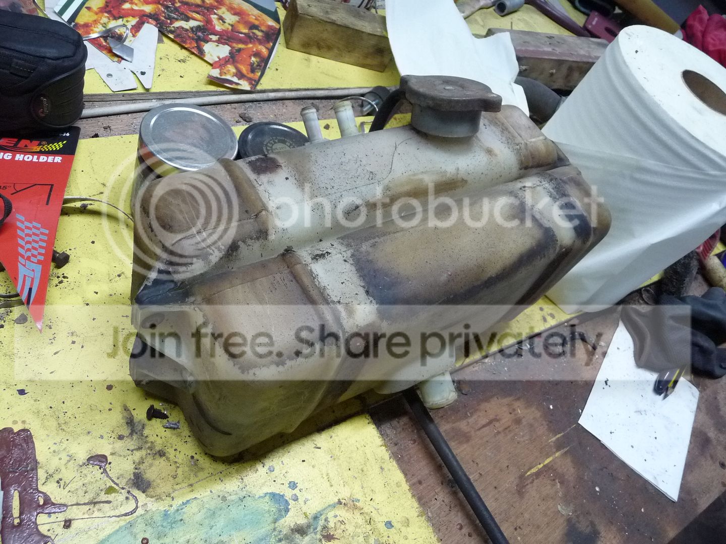

The expansion bottle was filthy, rusty inside from not having strong enough antifreeze in, and splattered with schutz on the outside:
I cleaned it out with various applications of bleach, thinners, soapy water and sand. Eventually got it as clean as I could manage:

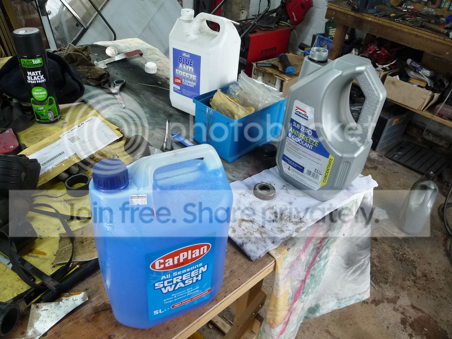

I had intended to flush the cooling system through with a dishwasher tablet but in the end I got impatient and just wanged the new coolant in, took about 2.5 gallons man (No I didnt fill the engine with screenwash, I just mixed the coolant in that bottle)
You can just about see the coolant level now in the expansion bottle (small mercies etc)
Anyway it seems to be leak free and on my admittedly not massive test drive, the engine got up to temp OK but never got higher than about half on the temp gauge. So hopefully the rad is going to be OK. If it fails in the future mind you its gonna be a right ballache as its basically a custom rad installation now. Total spend including rad, tig welding, hoses, adaptors, clips and coolant was about £180 so a lot less than £300, but although i saved £120 I spent friggin ages getting it together so was that a good strategy? I'm not sure TBH. Anyway I've still got the old rad so will keep it in case the worst happens!!!!
