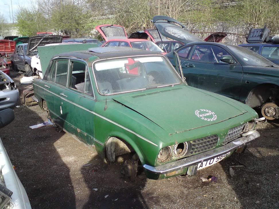

Wont people just scrap low value cars if the eml is on with a vauge emissions related code?
*Sucks through teeth* well sir, it might be the cat, might be you 02 sensors, or your maf, or something else. Parts and labour is probably come out at more than the cars worth and I still cant garuntee that the light will go out.
Best of scraping it m8
