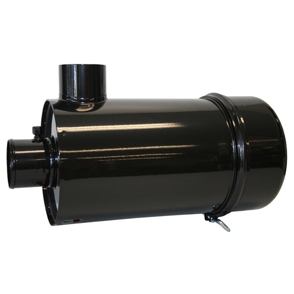

Does it look like this:
any montego/maestro with s-series, o-series or perkins primadonna
Close, bit deeper I think. Reckon that's one from a carb model.
Can grab a photo/dimensions tomorrow morning if you like.
It was accidentally bought for a normally aspirated 16v injection model (1989), mine is the 8v version with the Bosch K-Jetronic system on.  Shorter fatter filter.
Enter "cylindrical air filter element " into Google, hundreds to choose from , match up the dimensions , find the fitment list , search ebay for the commonest , simples ish !
Some dyson , vax and Panasonic hoovers did as well !
Give us a clue ! what do you want it to fit on ? ....
Land Rover Discovery.
I want to fit a Snorkel, but the ones advertised on the market seem to involve moving the airbox about and re-drilling it to move the intake to the side, it doesnt help that mine also has an AFM and ABS. Seems much easier to buy an airbox with an output on top and intake on the side.

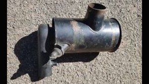

Does it have a way to connect a pipe at the top?
