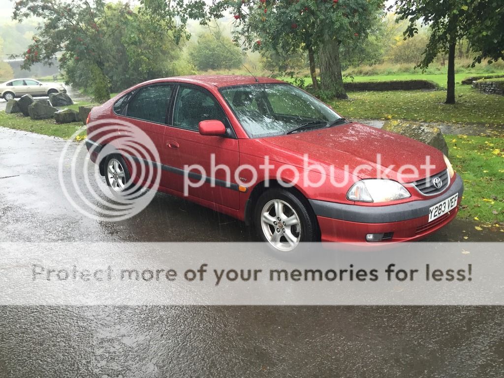

Been using the £200 Avensis Auto for work this week - done nearly 400 miles already and it's a great car. This really is bargain basement motoring.
It needs a couple of bits, there's a clunk from the O/S/F suspension over bumps and a wobble at 70 (possibly related). Also, when the engine is cold, it idles at 2k rpm but is fine once the engines warm. All fairly basic and simple stuff though, which I will get on with shortly.
It is in for MOT on Friday, fingers crossed! Then it can go to my dads. Bit gutted he's getting it actually, it's slow and boring but there is a huge sense of satisfaction driving a £200 car.
Here it is this morning, in the bouncing rain, in the middle of Weardale, County Durham:
