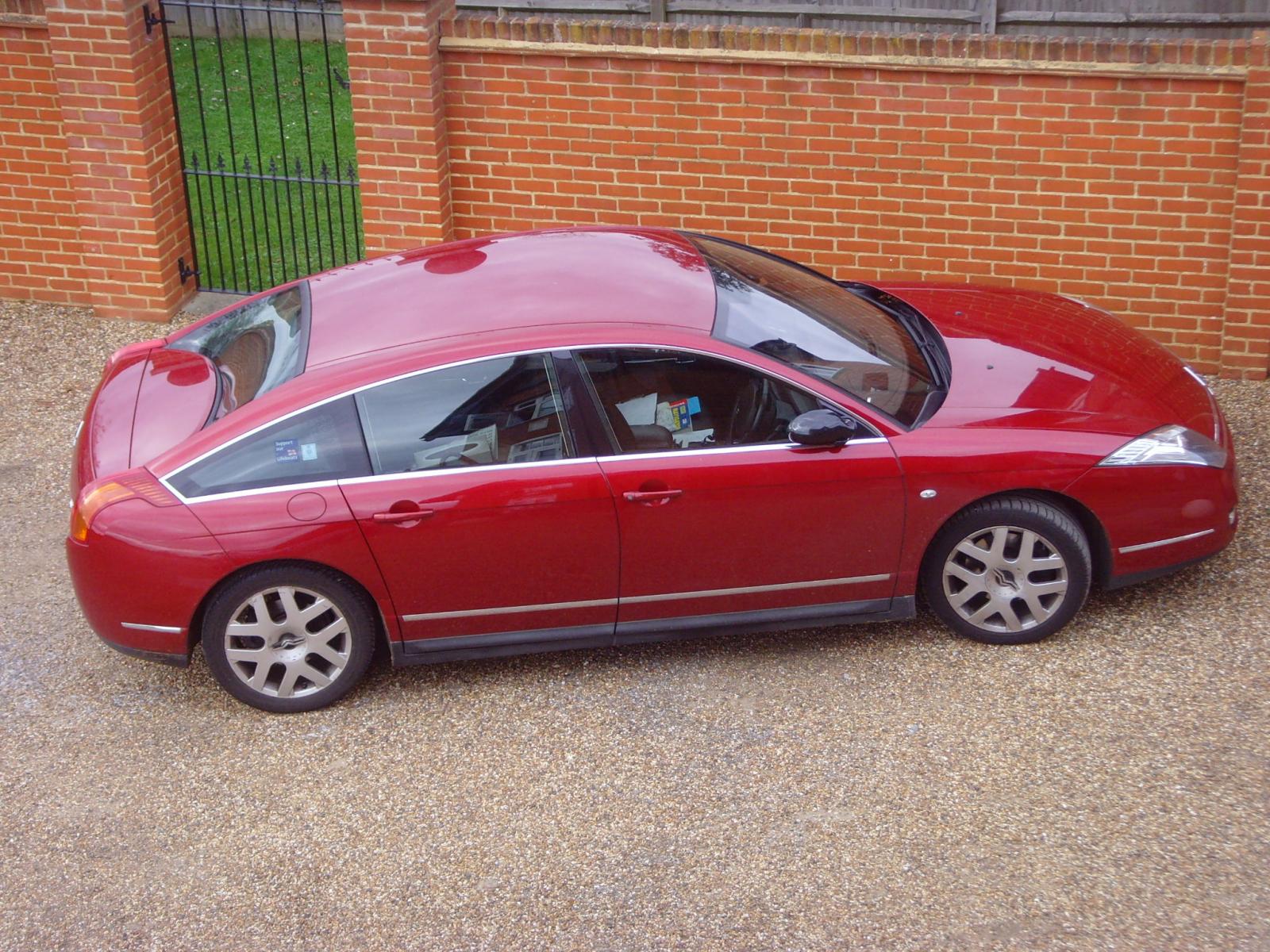

My Mercedes E280 finally sold this morning to Lord Sterling of this parish.  What a pleasant and painless transaction.  Much more straightforward than dealing with Ebay numpties.  Hopefully LS will be able to deal with it's most pressing issues and get many miles of non-Rover800 motoring from it.
Here's a farewell shot from the bedroom window:

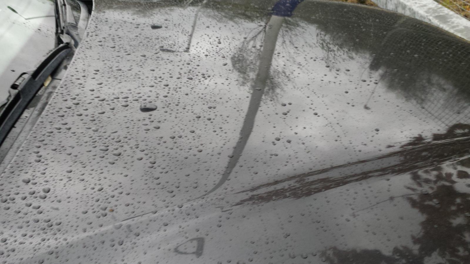

45 mins to wash, rinse, dry and wax means beading on the way to the station this morn;)
