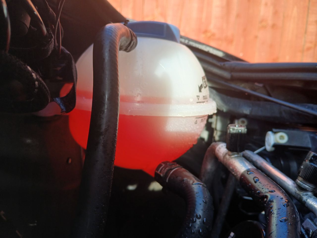

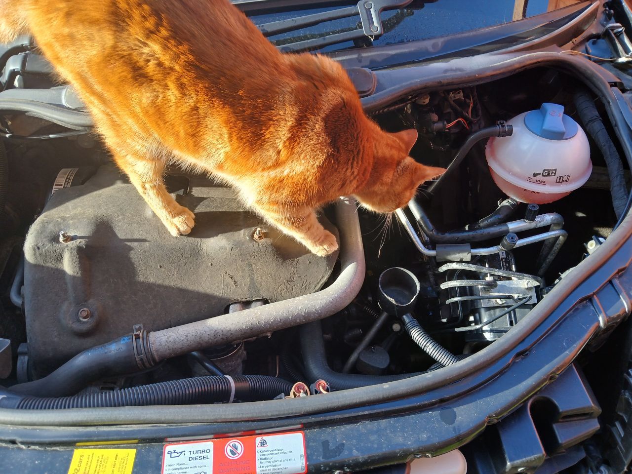

Up to my elbows in Alison's engine bay to change her knackered Expansion Tank.
I didn't realise that Ginger Mk2 is a Master VAG Tech. Once he'd checked my work, a test drive revealed no leaks.
Apart from traces of G12 where I hadn't quite tightened the cap...
Don't let him lick it... I'm sure I don't need to tell you it's fatal for them.
He stayed well away from it and the area was thoroughly hosed down with loads of water. Can't risk injury to any Stakeholders!
Even I don't fuck about with the stuff- always wear gloves when handling this stuff. Haven't forgotten my COSHH training, innit!
