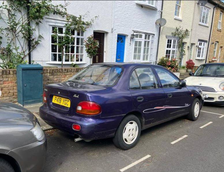

This is a Hyundai Accent, except it’s actually an Excel. This model was only ever sold in the UK as the “Accent” as was the case in most of Europe. In Belgium, The Netherlands and Australia however this car was sold under the name “Excel”.
Australia is particularly worth mentioning because upon further research I have discovered that this is an import model from down under...

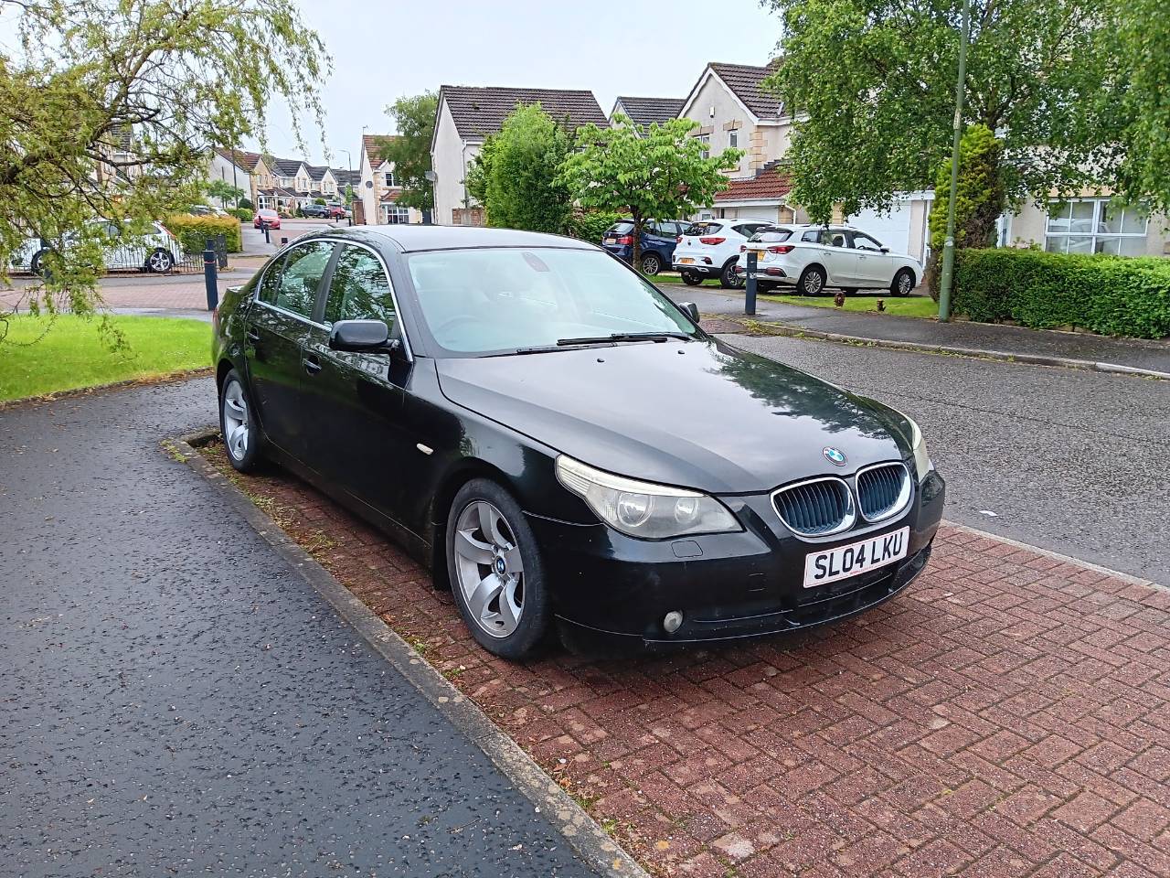

Just paid a deposit for another car. This cannot possibly be a bad idea *swears at BMW engineers and Autodoc*
