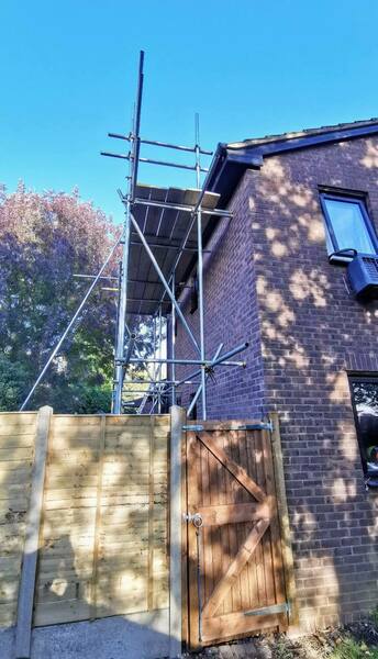

We had the entire roof redone here after the storm. There were a couple sections of soft ply which were changed, all the old roofing removed, the south hip had inadequate bracing so a beam was installed for that; new ridge vent installed, all new flashing for the drain vent risers and an additional heat sealed (tar backed silver plasticky tinfoil stuff) ice and rain underlay before 135 mph Kevlar backed architectural shingle lain on top.
That all came to $17,600. Fun times indeed.

4 hours ago, Zelandeth said:
but it looks like maybe 10-15 metres worth (out of just under 90)
I didn't know Milton Keynes had a castle 😲
90 metres of guttering !!!
8k for fascias, soffit and guttering... Gold plated 🤔

Around £100/metre seemed to be the going rate for replacement of the soffit boards (rather than just sticking new over the old) when I looked a couple of months back.  The cheapest quote we got for it was 5K, and that required us to provide the scaffolding ourselves.  The guy who gave us that quote also very much gave me the impression that the materials used would have "fallen off the back of someone else's van."
There's a lot of boarding on this house.  The fact that there's three levels of it out back doesn't help in that respect either.
Either way I know the guys we have working here just now aren't the cheapest, but I'd rather have a job done properly than done cheaply at the end of the day.  The fact that the previous owner of this place had *everything* done by the lowest possible bidder has been one of our biggest headaches since the day we moved in here.
