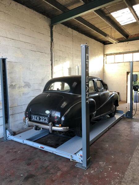

The new workshop has excellent height, as it was built circa 1975 as a lorry workshop. It originally had an inspection pit (long since filled in as it kept flooding) but it was crying out for a four post lift.
I was always under the impression that four post lifts were only available three-phase but it seems there are a few single phase ones available now, aimed at the enthusiastic amateur/semi professional.
Had great service from Birmingham-based Lift Giant who were very helpful, and brought the new lift all the way over to Lincolnshire, then spent about three hours assembling it here on site.
Decided to use my Austin Somerset as a Guinea pig, so up it went. The guys who installed it had already tested it out using their BMW tow car admittedly, but it’s great, we’re really pleased with it. It’s finest Chinesium and would probably get laughed out of a professional workshop, but it cost probably half what a Tecalemit or similar would cost and it appears to be very well made.
It also has detachable wheels so it can be moved around, and we’ve already moved it further back into the corner so there’s space for another car in front now.
