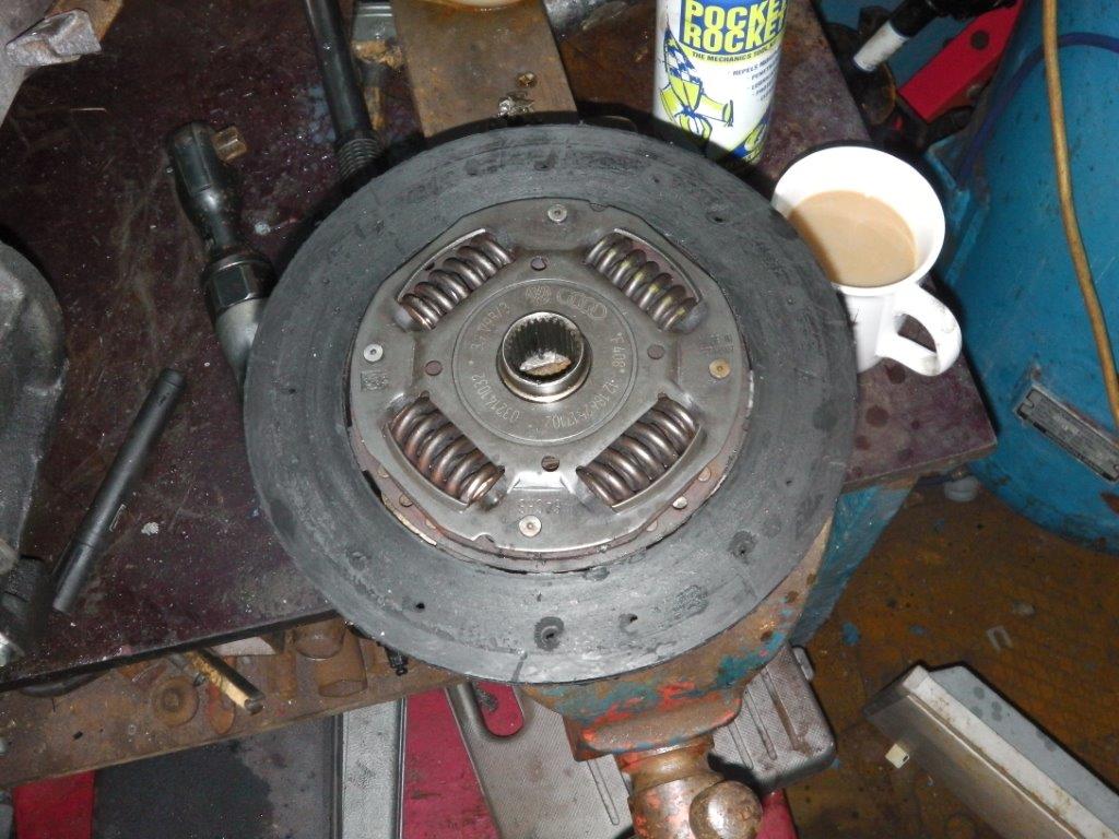

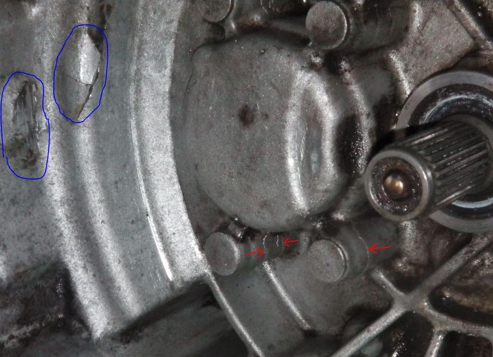

Box and new clutch are in the Golf- had a rather pleasant Tuesday afternoon swapping them over. Clutch was amazing, right down to the rivets, original, and soaked in gear oil. Amazed the thing still moved under its own steam. The gearbox had the usual diff rivet failure so the bellhousing was cracked and leaking oil all over the clutch. Got a really cheap box off Ebay which looks to have been reconned at one time so hopefully it's been done right and the rivets replaced with the bolt kit. Not driven it yet since, apart from up and down the drive, but all gears are there, clutch is light and there were no nuts/bolts/clips left over!

Here  you can see what happens to VAG gearboxes- the DUU box in particular, fitted to 1.4,1.6 and 1.9SDi engines... the diff rivets make a break for freedom and make a hole in the bellhousing...
