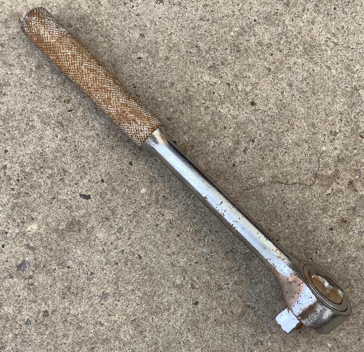

My "new" wrench turned up yesterday, f.o.c., just lying in the road.
Hilka make, seems to work ok.

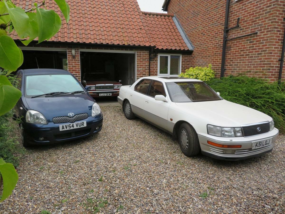

We have at last exchanged contracts on the house, moving day is Thursday! That puts the pressure on moving the last few bits and bobs out of the garage.
Laurel and Lexus are loaded-up with parts and wheels/tyres, good job it's only a short distance we're going as both are now sitting rather low.

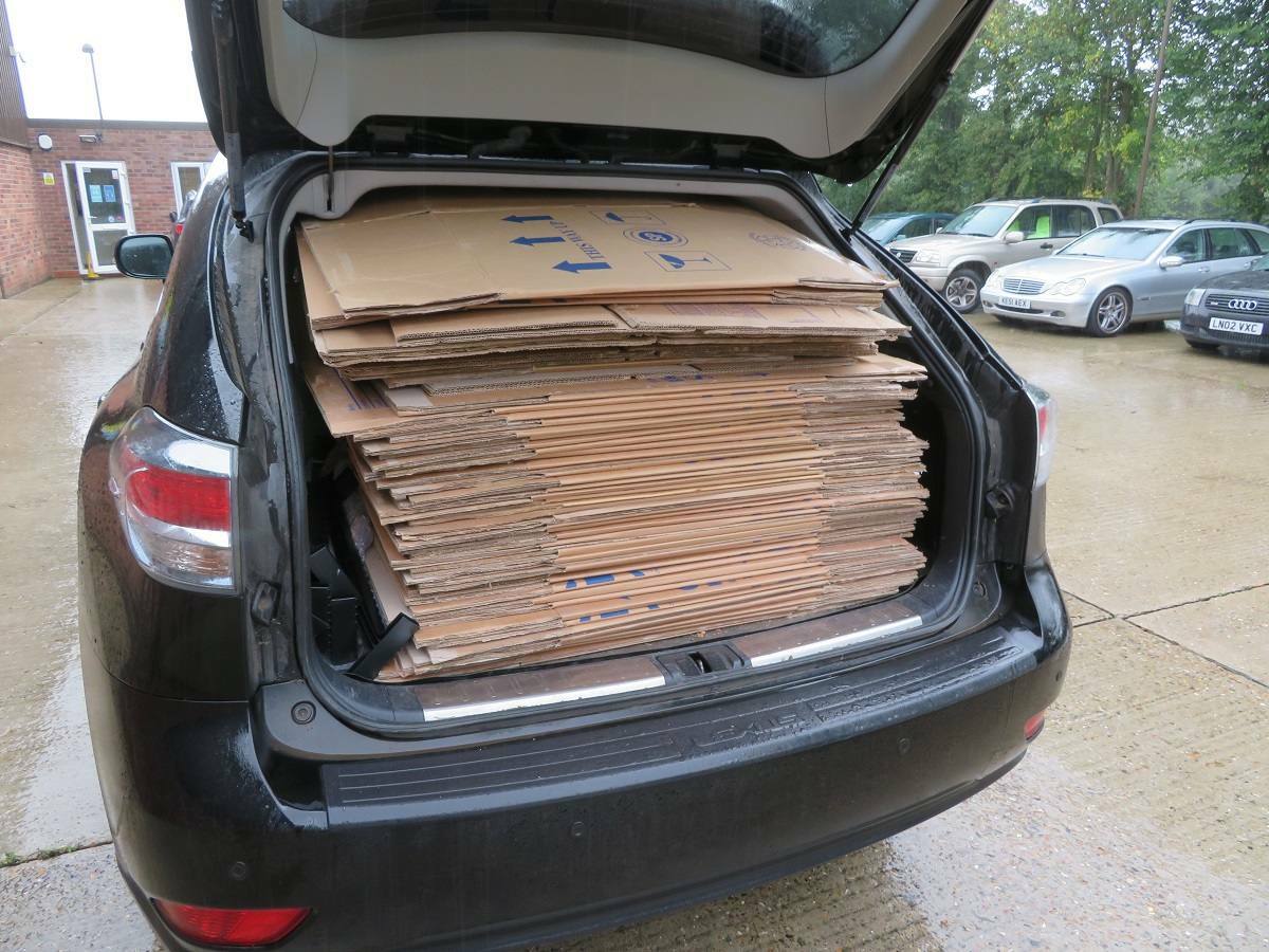

The RX has been doing a lot of work. On Sunday it was used to move all of the plants across to our new house (our former neighbours had kindly let us leave them there). Yesterday it took around 100 of the 110 boxes we apparently used during the move back to the removals people:
There certainly wasn't room for many more. I then used it for collecting 8' long chipboard floor panels for the lofts.
