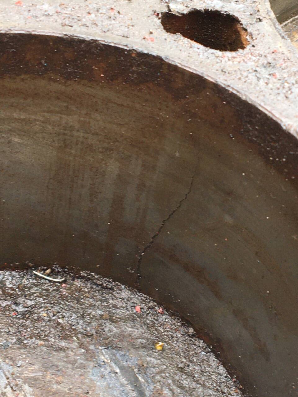

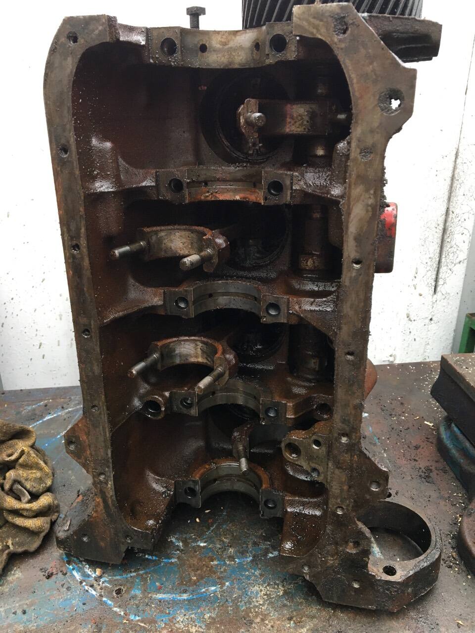

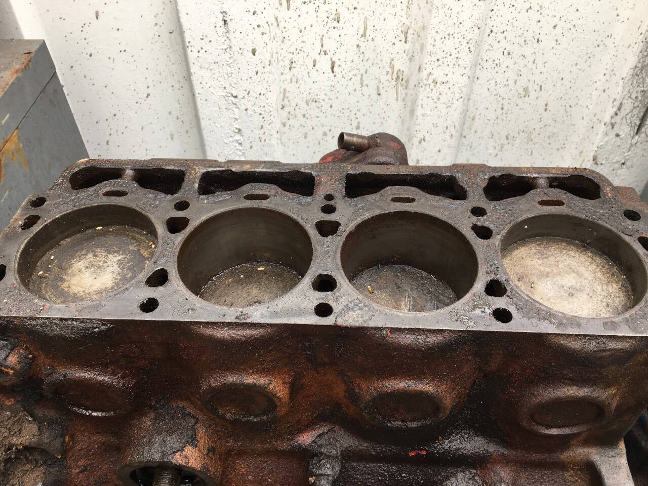

Carried on stripping this Volvo B20 engine today, the diesel did nothing to free off the pistons but I hoped they’d pop out with a block of wood and some hammering after I removed the crank.
Things all came apart reasonably well but the pistons simply won’t budge, up or down. I was hoping at least one or two would come out but they’re all absolutely solid in the bores.
The crank doesn’t look too bad but has bits ground out of the webbing, the connecting rod caps have also been numbered, perhaps it’s been rebuilt before and the cranks been balanced.
I did find some damage that might be terminal, a cracked cylinder liner. The corresponding piston has some bits of skirt missing and appears to have melted, it also looks crooked in the bore, very odd. This damage would’ve certainly prevented the engine from running, or it would’ve at least been pretty obvious there was something drastically wrong. The previous owner couldn’t remember why he parked it up in 1986, this may well be the reason.
I’m unsure if cylinder liners are available or even removable, I’ll have to look it up and make a decision on the engines future then.
That looks like a one-piece cast iron engine block, ie not seperate liners. Also, that crank; those ground out areas look like they have created some nasty stress-raisers. Probably ready for the re-cycling smelter.

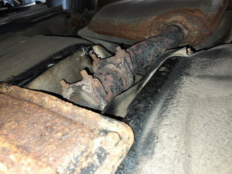

I had a look at the Audi exhaust today. Some pictures are upside down, because they probably are. It was raining and I was busy with the Civic at the time so just kind of waved my phone under the car whilst tapping blindly at the screen to take a photo
20210807_143046.thumb.jpg.676d927b14fdad798f9d39c87ad9b76a.jpg20210807_143621.thumb.jpg.c058a4be32fbab75bf5efc75a59502ec.jpg20210807_143715.thumb.jpg.aded0ed7618c77d2cd4a2641b3a61ddc.jpg20210807_142852.thumb.jpg.bcdd2a9dbf77076ccb423e16cc268043.jpg
The downpipe is toast but I have a good spare.
The cat looks OK however the rearmost part of it has been badly sleeved to presumably cure a blow.
The middle section is toast at that part and the rest of it is rotten but not yet blowing. It appears to be joined to the cat section by 2 clamps.
The rear section is not separated from the middle by a join so the whole lot will have to go.
So I have bought a middle section for a 2.0 for £68 posted which *looks* like it will fit.
Once I have this I'll lay it under the car and see where joins need to be made. I might just get a new cat section as well as those on ebay look the same as the one on the car. I can bolt it to the replacement downpipe as well to check it actually fits to that part.
If that all lines up then I'll get a back section and at that point I can be confident that it will go on without too much faffing and that is garage would be able to do it.
If not, some or more Scotoshiters may be mysteriously washing their hair that, and indeed every night for the foreseeable!

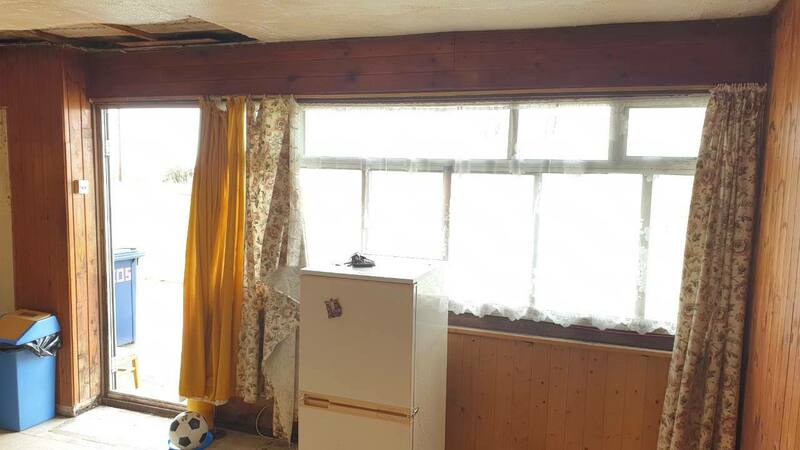

Funky wallpaper revealed...
Nice to see that after all that graft you still have enough energy to teach your lad "I'm a little teapot".
That wallpaper looks so good! A lot better than the wanky wood cladding they put over it.
